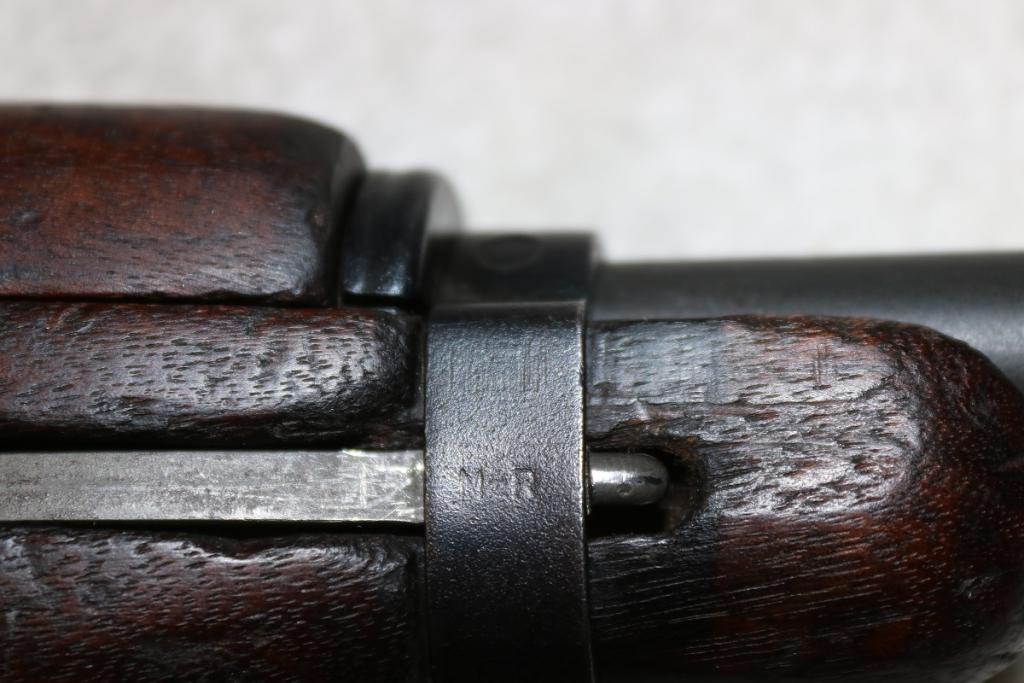

    Can you post a pic of your mag catch and band for comparison?
    BTW, it has been corrected.

    Mag catch and band

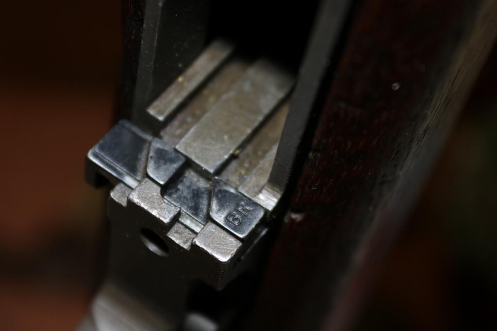

    The catch and band look good. The catch has that Austrian look, though. About your rear sight, sorry but, it's been added on recently. The rest looks good.

    I agree about the Rear Sight and have to question if it is real.
    I'm not at liberty to use pictures from the private file I'm using for comparison.
    The shape (top corners) of your sight base don't match.... Yours being much more rounded. The milling on the outer sides of the sights base is different.... Grind Angle...etc
    Your sights' base sits above the bottom of the receiver slot.
    Your sight both front and back sit above the Dovetails.
    Can you see day light under these areas?
    The Shape of the letters on the Leaf and right side of base do not match known original, they are close but don't match.
    The pin is more or less showing similar staking and I believe it's your camera flash that makes your sight pin look in the white, when I believe it is probably blued in color.
    It also shows no wear or patina you'd expect to find on a 75 year old part.

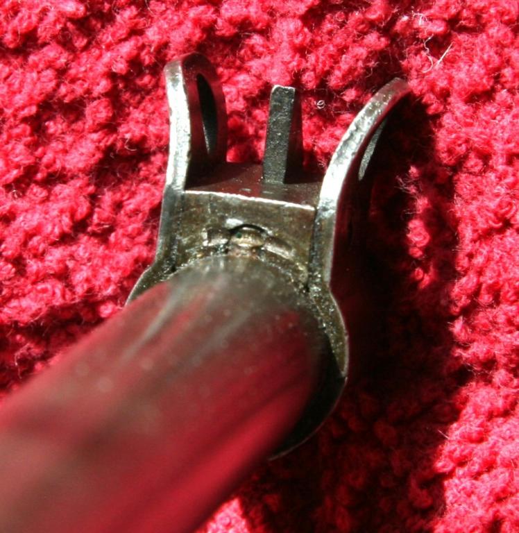

    Here is a picture of RMC parts I've gathered up over the years for a restoration that I never seem to get to,
    Does your Front sight have the pin staked on the sides like this picture:

    Have seen Real M-R bands with the flat top and the rounded top. Yours having the round top.
    From the few pics I've seen It's the Flip sight that stands out as not being real. Nothing else Jumps Out at me, but we've seen just a few pictures. Color, Wear patterns and other factors need to be taken in to account to be able to judge if it's original assembly.
    Even a take off list would help IE: Type II safety, Hammer Straight marked KR, Trigger Type II Rock Ola, Trigger housing Type II marked Rock Ola.........
    Does Recoil plate wear match up to receiver tang wear ?
    Rear of Slide wear match up to front of receiver surface?
    Is Piston nut staked at 11, 4 and 7 ?
    We have no way to know.......

    Rear sight isn't USGI, but I wasn't the first to note it. I got a message from someone to take a look. The stock also has type II or III shading in that side view. It has that perfectly vertical oil stain line from the larger bands. A slight depression can be seen on the top surface as well from where one used to be.

    I came to the same conclusion yesterday. I believe the rifle to be a restoration without doubt. I believe the barreled action has been re parkerized as well. A rifle with an MW of 2 would have been fired perhaps thousands of rounds and this rifle just doesn't show the wear I would expect in the moving metal parts. I can easily see a gap under the rear sight base. The front sight stakings are correct. The stock shows it's had a wider band on it.....that said, the stock shows honest use but the metal parts do not. Comments welcome.
