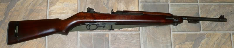

    Here's a picture of a carbine I built a year or so back. Used a Springfield, Inc., receiver and a unused Winchester barrel that I'd had for years. Stock was a new unfinished commercial stock that I finished, and all the rest was USGI parts I hand picked at gunshows. Certainly not the cheapest way to acquire a carbine but definitely the most fun.

    Faulkner :
    Nice Carbine ! I will probably do like you as M1icon Carbine are now selling for 500€ here in Belgiumicon & picking up USGI parts at militaria shows aren't more expensive.
    My barrel is exactly 16" long and the flashider was screwed & silver soldered in place. For me, it's a L1 flash hider....I must check.
