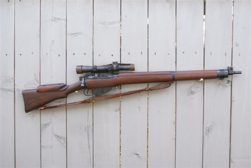

    Thanks N4 Mk1 (T). How's the weather on The Island at the moment? Was your scopeless No4 (T) a 44 BSA? I only ask as the relatively few non-Savage 'less scope' rifles I have seen or heard of have all been 44 BSA's.........I think that in general the atypical or non-standard markings on 43 & earlier rifles is generally indicative of the early stage of evolution of the marking system, although as they say, 'never say never & never say always when talking about Enfields!'
    Incidentally burpgun, I'm pleased the bracket does the business -- I've always been a stickler on the machining. Also, I have AQ 93XX in my collection!
    ATB
    The weather is great! I only wish I didn't have to go to work as it would be perfect for shooting.
    Yes and sorry I intended to mention that my "Less Scope" was a 1944 BSA in the B prefix serial number range. It looked almost mint and had been fitted with a Mk3 scope and original bracket.

    Here is my unfinished BSA 1944 still in the grease, it's s/n is in the "H" series.

    This thread is interesting in that it shows that there are no 'absolutes' in enfield no 4 t sniper rifles. I suppose in part that's because they were built in wartime and shockingly the makers didn't consider collectors 60 years later every step of the way when they were applying markings to the guns. The selfish sods. I suspect there are perfectly authentic rifles around now which the owners think are fakes because there is a missing stamp somewhere. A friend of mine who was in the army laughs when I mention marks like the butt S51, saying that if a sniper had a problem with the butt, too short or long etc, they took it in and the armorer put a new one on. Now that didn't have the S51 on any more so would fail some 'authenticity' tests, but it was an alteration requested by a real, live sniper.
    So it's caveat emptor in trying to see through the fakes, but don't forget they weren't built by someone who was ticking off all the points in the excellent 'is my lee enfield sniper rifle a fake' article.

    The rifle has the S51 and the "S" mark on the cut off block. Bolt and forend of course match, magazine in un-numbered but original as the grease is unbroken. No middle sling swivel and the screw's on the pads are staked.
    Missing, the "T" of course and a scope number on the butt. I do not remember if the special inspectors view mark in the back of the receiver is there, it has been so long since I went over it.
