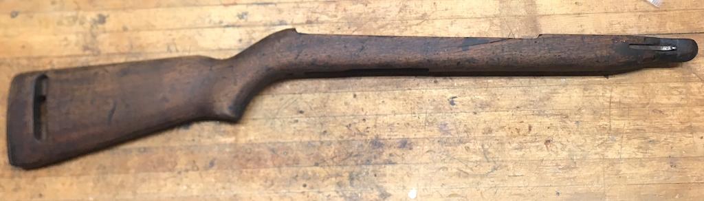

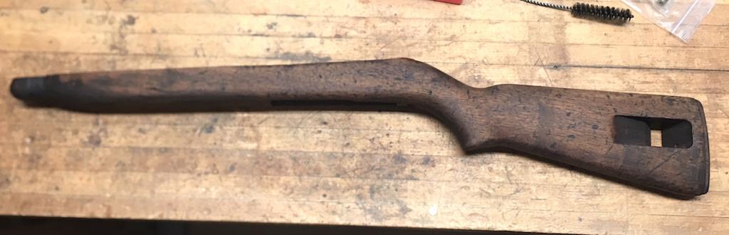

    Well, I got the stock. It definitely has the "been there, done that" look, which is OK for a war fighter weapon. It is very sound (except for the 3" crack) and not at all punky.
    Overall, I am happy. Considering what even Inland stocks go for, $70 for a Quality Hardware was not a bad price.
    It looks like someone already stripped it, but did nothing about stains and dents. The crack on the right side under the slide should easily fix without pins, just clamped. I think I will do the crack repair before I start messing with the stains. Dents aren't too bad, so I don't think I will mess with them. If I can lighten the stains by 50%, I'll be happy. Not trying to totally restore like Charley does, but still want it to be pretty decent when I finish. The QH mixmaster is fairly clean, so I want the stock to approximate the metal as far as usage.

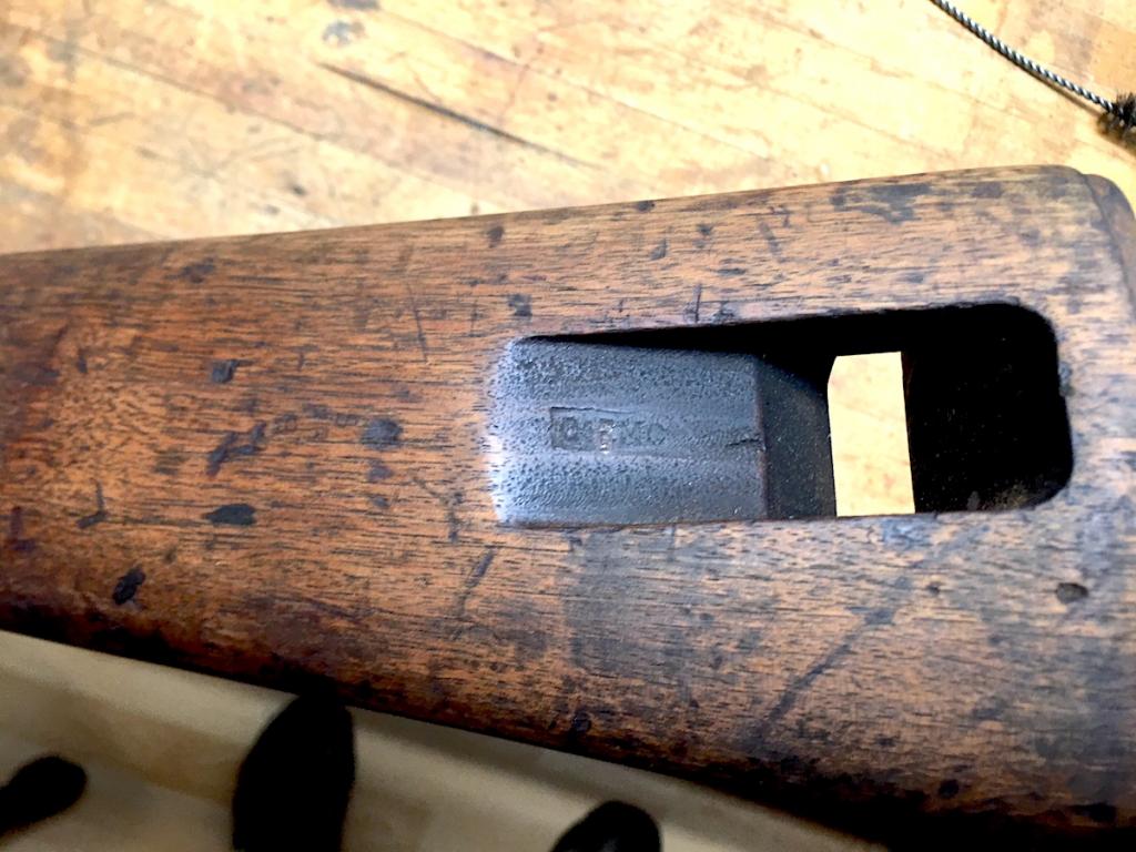

    05-10-2025
    08:28 AM
    Well, used the bar Keepers paste, and it cleaned up the black spots a lot. I am going to stain it black walnut though, and the spots should not show at all.

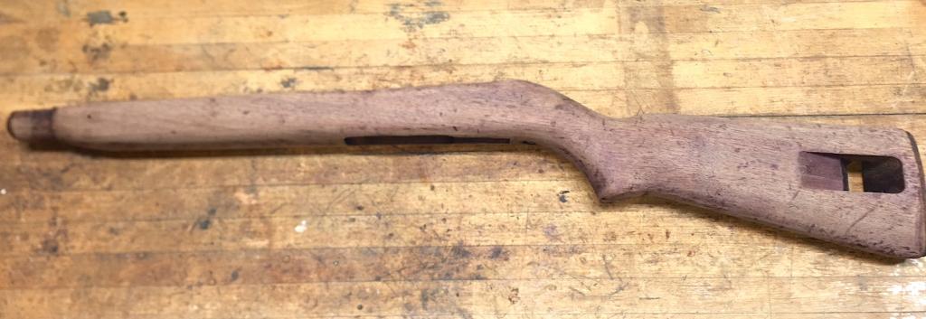

    05-10-2025
    08:28 AM
    Here is the stock after two applications of Bar Keepers: Once I hit it with some Black Walnut stain, the black spots will be almost invisible. Really amazing stuff!
