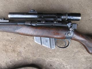

    Do you know as to what scope you will be mounting with regard to tube size?
    Most of the older scope mounts I see seem to be 7/8 inch.
    This is my truck gun with a Weaver detachable side mount with a 1 inch Weaver K2.5. Ya, the rifle is a beater, but the scope and mount hold up to some pretty rugged use. The scope can be quickly removed and is true to its zero when replaced.
