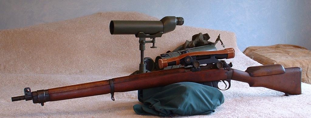

    My '43 dated 4T
    AV Prefix
    RAF issue
  12. The Following 2 Members Say Thank You to Alan de Enfield For This Useful Post:

    My '43 dated 4T
    AV Prefix
    RAF issue
    Allen I notice that the draw on your Scout scope is still blued. Is that a minty scope with the original blue? I have one a minty one still having the original bluing also. The bluing on most draws are generally worn off from use. Ray
