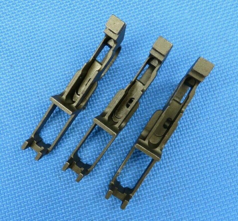

    Was just looking at Stan Pro Housings on Auction, same types, but see differences.
    Look at the difference in the location of the extra depth cut inside the middle one-

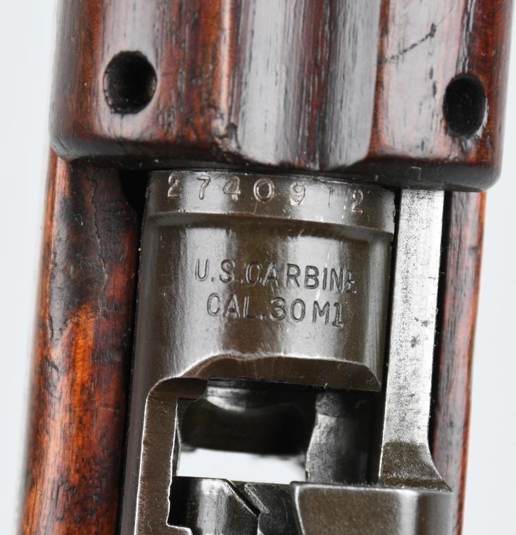

    I've been asking around and haven't found anyone that has seen the Serial number stamped on the front receiver ring.

    So far just since your report we've seen 1 other carbine with the serial number stamped on the front receiver ring, pictured below. It's a Underwood found on a Auction site:

    Found 2 more Marlin barrels double stamped like this one above, the one above being serial # 4,427,xxx.
    Another from CMPicon Auction... Marlin/Dble stamped SN# 4,202,xxx Link and Pic below:
    Civilian Marksmanship Program - Promoting firearms safety training!
