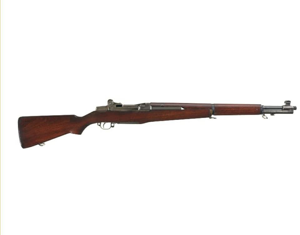

    16 Mar 20 Garand Picture of the Day
    M1icon Garand Serial Number 7
    Sold April 2015 for $97,750

    What a fun one that would make to restore . There was alot of good early production parts on that rifle but I never understood the postwar op rod. I assume it was put in as a placeholder during the restoration to an early production gas trap.
    A gas trap BFA also sold at that auction
    Nice receiver.

    The receiver has the early receiver markings used only on the shop model rifles of: "U.S./SEMIAUTO. RIFLE/CAL. .30M1/SPRINGFIELD/ARMORY", with no drawing number or heat lot number on the side. It remains in original "7 shot" configuration. The receiver is fitted with the early pattern M1icon Gas Trap type barrel that is 22 1/4 inch long and threaded on the front end for the gas cylinder with the single spline on top. It is not marked with any drawing numbers or markings on the right side and is correctly stamped with only a single larger "P" firing proof with a single punch mark. The barrel is fitted with a early gas trap, gas cylinder with the spear point milling marks on each side with the rear facing drawing number of "D28289" and square top front sight groove that is fitted with a second model gas plug that is marked on the sides with "B-8876/-4". The front sight is third pattern sight with the flared front wings that is marked on the side with "SA12703-0". The bolt is a second or early third pattern that is stamped with: "D28287 -1" with no heat lot markings. It has an early two-piece operating rod that is stamped with "D35381 SA" on the underside flat of the operating rod with no revision mark of any kind, however it does have the early stress relief semi-circle cut added. For the internal parts it has the following: it has an early follower rod that has the serration on the flat upper end with a fully round shaft with the recoil spring attaching to only the very end of the follower rod. The recoil spring is also a very early flat, narrow wire, keystone type recoil spring. The rear sight assembly has all the various early parts such as the unmarked rear sight aperture with no guide rails on the sides, a four pattern rear sight cover stamped: "B8872". The windage and elevation knobs are the early third pattern with the open, narrow arrows correctly marked: "BATTLE RANGE", with the flush nut on the windage side with the second pattern windage knob marked "LEFT/LEFT" with the small open arrows. The internal parts consist of the following: a early milled bullet guide marked "B8875 W.R.A.", a 1934 version of the follower and slide, with the narrow rear tabs, and the narrow front tabs with the slide still in the white. The trigger group is marked as follows: It has the early hammer that is marked on the side: "C46008-1SA" with the hole on the side, the safety is marked "C46015-4SA" it has the milled trigger guard marked "C46025", and the trigger housing is marked "D28290 SA" the hammer spring guide is still in the white. It is fitted with a early set of all dark walnut with a early third pattern unmarked gas trap middle barrel band that has the milled lower rear edges, no drawing numbers or markings with the circumferential groove. It has the standard early unmarked front handguard and later production lower handguard and barrel band that has the double fixturing holes and the circumferential groove. It is also fitted with the second pattern gas trap type buttstock with the two equal size 13/16 holes in the butt with the no trap buttplate, the buttplate screws and lower sling swivel are all unmarked.

    early trigger housing without pad
    Too bad the owner of number 7 could not find the correct trigger housing and internal parts.
    here is a photo of an early trigger housing without the pad - these did not last long in production Attachment 106293Attachment 106292

    IIRC the tool room parts did not carry part numbers.

    Thete is sooo much wrong with the auction description. I love the "7 shot" configuration . 🤣🤣🤣🤣.
    You are correct, modelshop parts did not have any drawing numbers stamped on them. The trigger housing RCS shows is early production and lasted through , roughly, the first 1500 rifles.
