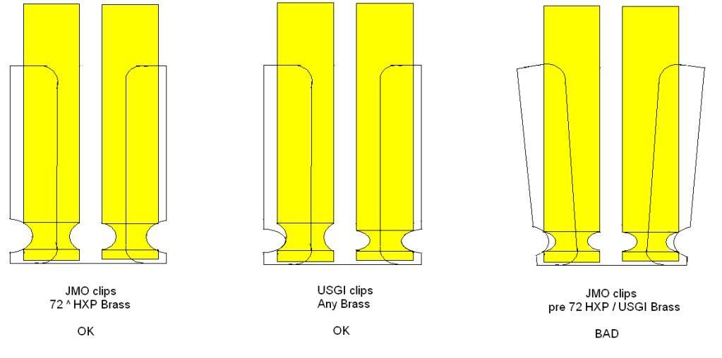

    Here's and image of what the guys are talking about WRT the clips
    Former Prairie Submarine Commander
    "To Err is Human, To Forgive is Divine. Neither of Which is SAC Policy."

    AFJon---I figured out what you were referring to in your ammo/clip picture.
