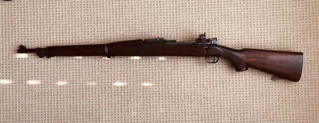

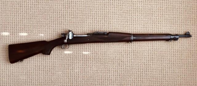

    Quote Originally Posted by rcathey View Post
    I would love to see pictures of this whole rifle if you get a chance!
    Here are a couple pics, the rifle is a real beauty. As I stated before, I have the paperwork from SA confirming the sale, to the original owner. The original owner had checkering added to the forearm and pistol grip, and a plastic cap installed at the bottom of the pistol grip. Also, there's an ID tag attached to the rear sling loop, of the shooting range, the individual belonged to? I'm curious about the value, Flaydermans Guide has it ranging from $5,000-Exc to $2,750-VG, apparently 589 were made. How much would the personal modifications, devalue the rifle?
    Thank you
