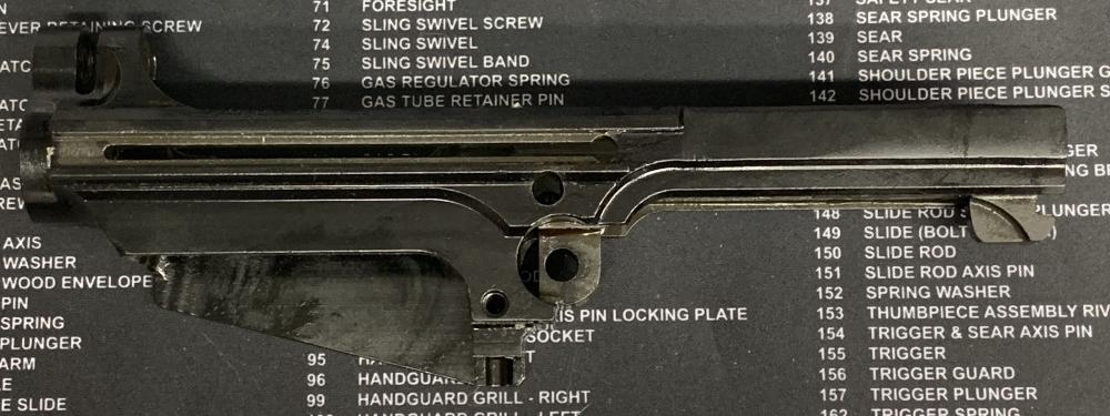

    I'll try and find some pictures of the old one....
    I have a new L1A1 receiver, an Imbel Para lower half and a L12A1 bolt assembly for the new build. I need to find a blueprint for an L1A1 barrel for the new build, but I can pretty much make something up if I need to! I also need to get some dimensions from the chamber adapter for the chamber end.
    Here's the receiver...
