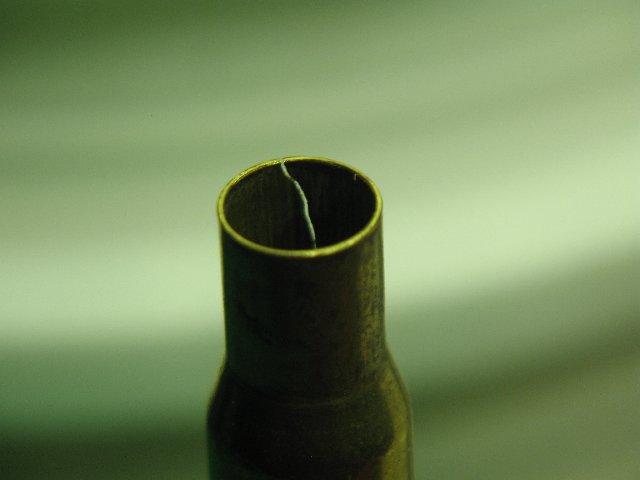

    I usually start with once fired (in my own guns) or new cases so I pretty much know their history.
    On the one occasion that I was given several boxes of reloaded .30-06, I pulled and saved the bullets and pitched the cases. More than a few looked like this:
    Never shoot reloads other than your own.
