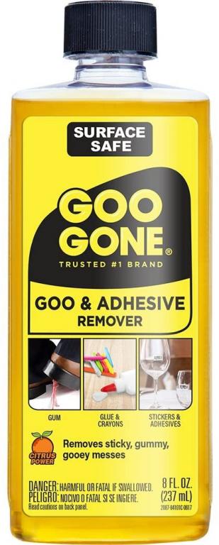

    I have not tried this but it's cheap enough. Maybe test it on an inconspicuous place or on another sacrificial stock.
    Goo Gone hotline: 855-364-8135

    I very much appreciate your thoughts here and elsewhere. The OP now has many good options of varying degrees to consider - none of which include a dishwasher, bleach, or oven cleaner. I don't like goo-gone as it leaves a residue only removed with something else like mineral spirits or other. Likely spot treatment will always show something, as the tape embedded its own patina over time.
