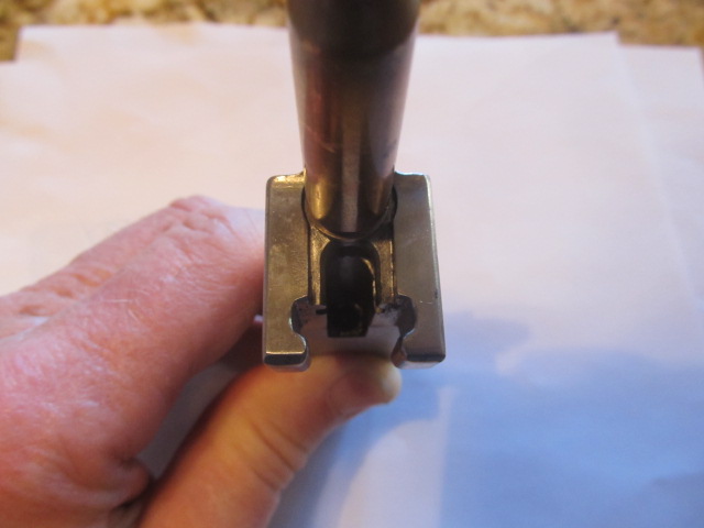

    Well, after having NO luck with the recoil springs, I am really beginning to suspect the bolt. I THINK it is dropping the spent cartidge into the receiver on extraction. Take a look at the vid. My extractor is holding the case, but there is nothing above or either side to hold this round in. Pics of a friend's bolt face clearly shows the bolt surrounding the casing much more closely.
    https://vimeo.com/520220695
    here is a pic of my Friend's (operational) FA Bren.

    OK just for closure. So it seems the .303 bolt that was supposed to be sent back to me when I converted from 54R was NOT a .303 bolt but the same 54R bolt as before. So... the spent casing was just rattling around on the face of the breach block and was getting dropped into the receiver during cycling and jamming it up. I replaced the other block with a (correct) .303 block and it ran perfectly without missing a beat. Thanks to all to helped me trouble shoot this. I very much appreciate all your time and effort.
