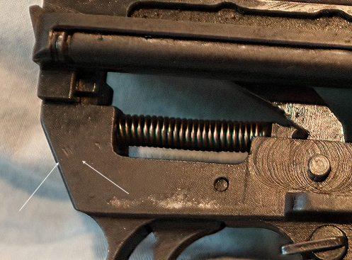

    What W on the left side of the trigger housing? I don't see a right hand side of the housing posted.

    Quote Originally Posted by tenOC View Post
    Sorry I was looking at the hammer[ I see a "W" at the back of the trigger housing on the right hand side COLOR="black"]

    Looks like Winchester to me.

    Quote Originally Posted by jimb16 View Post
    But the receiver under the sight has Quality H.M.C. , on my two Winchesters I can see Winchester on that spot

    Quote Originally Posted by Ben Cartwright View Post
    I believe he is talking about the trigger housing
    Oh, I agree, the trigger housing is Winchester.
    All M1icon Carbines produced by the various manufacturers of carbines often had parts from various suppliers at different times. Even those manufacturers that produced most of the parts in house as the press of war and production dictated that sometimes in house parts weren't available so parts were procured from other sources. It isn't unusual to find any carbine produced to have another company's barrel or other parts that never had those parts replaced. The issue that it takes time and effort to tool up and produce every part was the primary reason so many different company's were in the M1 Carbine program. The vast majority of suppliers produced some parts, not all parts.

    His Quality would not have had a Winchester group, nor trigger housing from Winchester. What you've posted isn't the accurate way to say it and will lead to more rumors passed by uninformed people.
    Most makers had parts subcontracted by companies who coded them for use for the specific makers. For instance you will see codes on Quality Carbines like Q-NL, NL-Q, Q-TX, DA-Q, J-Q, Q-J, Q, Q-GE, GE-Q, etc.. NOTE THE Q. Barrels installed on receivers from a different maker will have the proof mark matching the producer of the receiver who assembled it. In the case of Quality the proof P has a very short stem, which is easily IDed. You can't just have any parts installed on a Carbine and it be corrrect nor original.
    My early quality has a Winchester barrel with Quality proof P, while Winchester never used the P. So any Winchester barrel on a Quality without one is not correct.
    The barrel on my Quality has "Rock-ola" but it also has a "P" proof mark that appears to be about 1/8" high. The trigger group only has "W"'s so would that be from some sub-contractor who coded it for Winchester but sent it to Quality?
