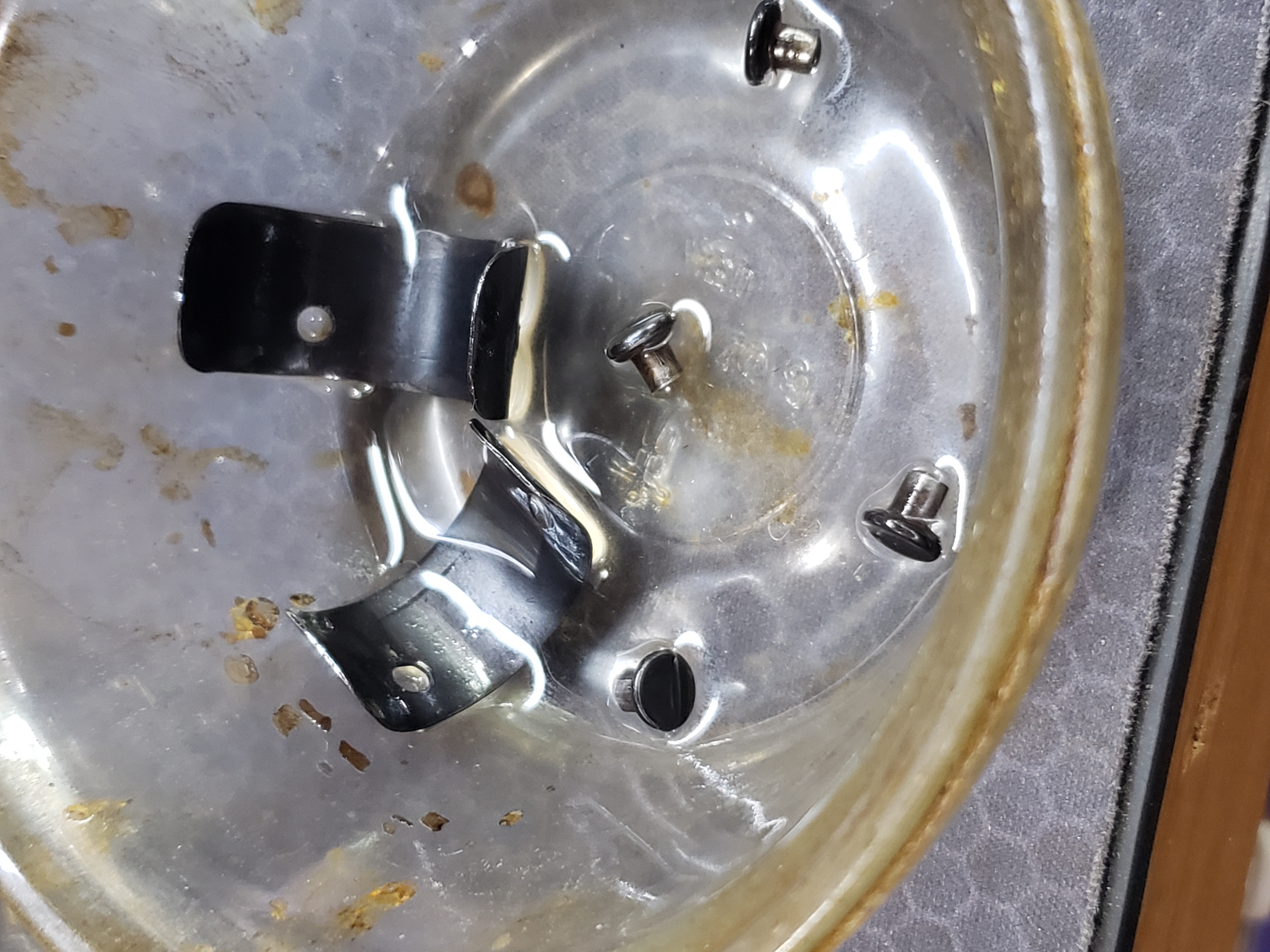

    Played around with rivets today. Didn't I post a link to the ones I found? Guess not, here you go. https://www.ebay.com/itm/353338910765
    I had some scraps of walnut from testing stains to use for practice, they are about the same thickness as the area of handgaurd. I have some sections of 22 gauges steel to play with. I think it's a bit too thick at ~0.030. I need more like ~0.020-0.025 comparing the original (it's hard to get a good measurement on the curved surface). Easy to find 26 gauge galvanized on the web. should be perfect. Here is a chart for refefence. https://www.bestmaterials.com/PDF_Fi...auge-chart.pdf
    My rivets are perfect size compared to the originals. 1/4 heads, 1/8 body. I used my 1/4" forester bit to drill some counter sinks, and leave a center reference. My original has the heads just barely below flush. I then used a #31 drill to go through the center. This is too tight to fit the rivet through, but we want it very snug. I then chased the hole with a 1/8 bit on a hand tap. I could then tap the rivet through. Nice and snug. Cut a sliver of my sheet metal, and do the same. A roll pin starter worked well to tap over tail of the rivet.
    I clamped a 1/4" punch in my vise, and tried to set the rivet. The soft steel rivet started to deform pretty easily with a flat punch and a few dozen light taps from my hammer. but after a few dozen ta. Then snap...the wood split. I investigated. My rivet is too long, and it started to smoosh the whole length, splitting the wood.
    Next try...grind the rivet tail down till it protruded out only ~1/16 beyond the metal. This worked much better, but didn't really draw the rivet tight. I was worried it would split again.
    I anticipated this from lots of reading. I needed a round surface to peen the rivet edges. easy enough on a flat piece of wood with a ball peen hammer, but would be impossible on the inside curved surface of the handgaurd.
    https://www.amazon.com/gp/product/B00819DRNE/
    These punches worked perfect but were a challenge to keep from slipping, even on the flat test piece.
    Third time is the charm. I used a rounded tip stone on my dremmel to make a dimple in the tail of the rivet (after grinding it down to the length I needed). This made it easy to hold the ball-peen punch at any angle and tap until the tail was upset all around, drawing up the metal to the wood nice and tight. I think this technique will work well on the real deal.
    Next up, get my 26 gauge sheet in the mail, measure twice and cut the right shape. Soak in 10% muriatic and sand/polish to remove the galvanized coating. Drill the handgaurd. Carefully measure for the holes in the metal, and drill them. Use my old barrel to form the clips (already practiced this with the 22 gauge), blue the rivets. Temper the clips, and blue. Then install. We are getting close! I'll make a how-to post with pics of all the steps above when I do it.

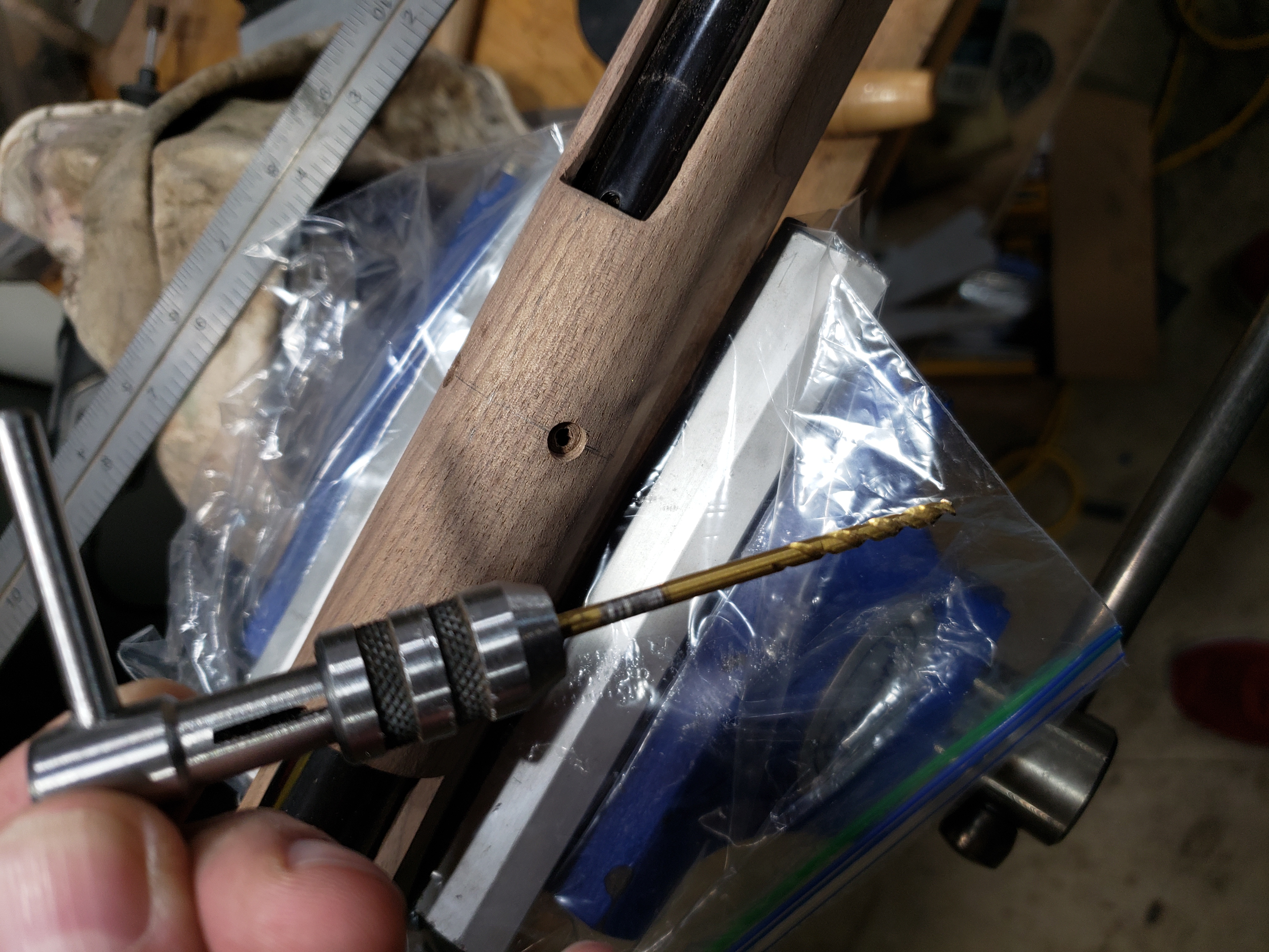

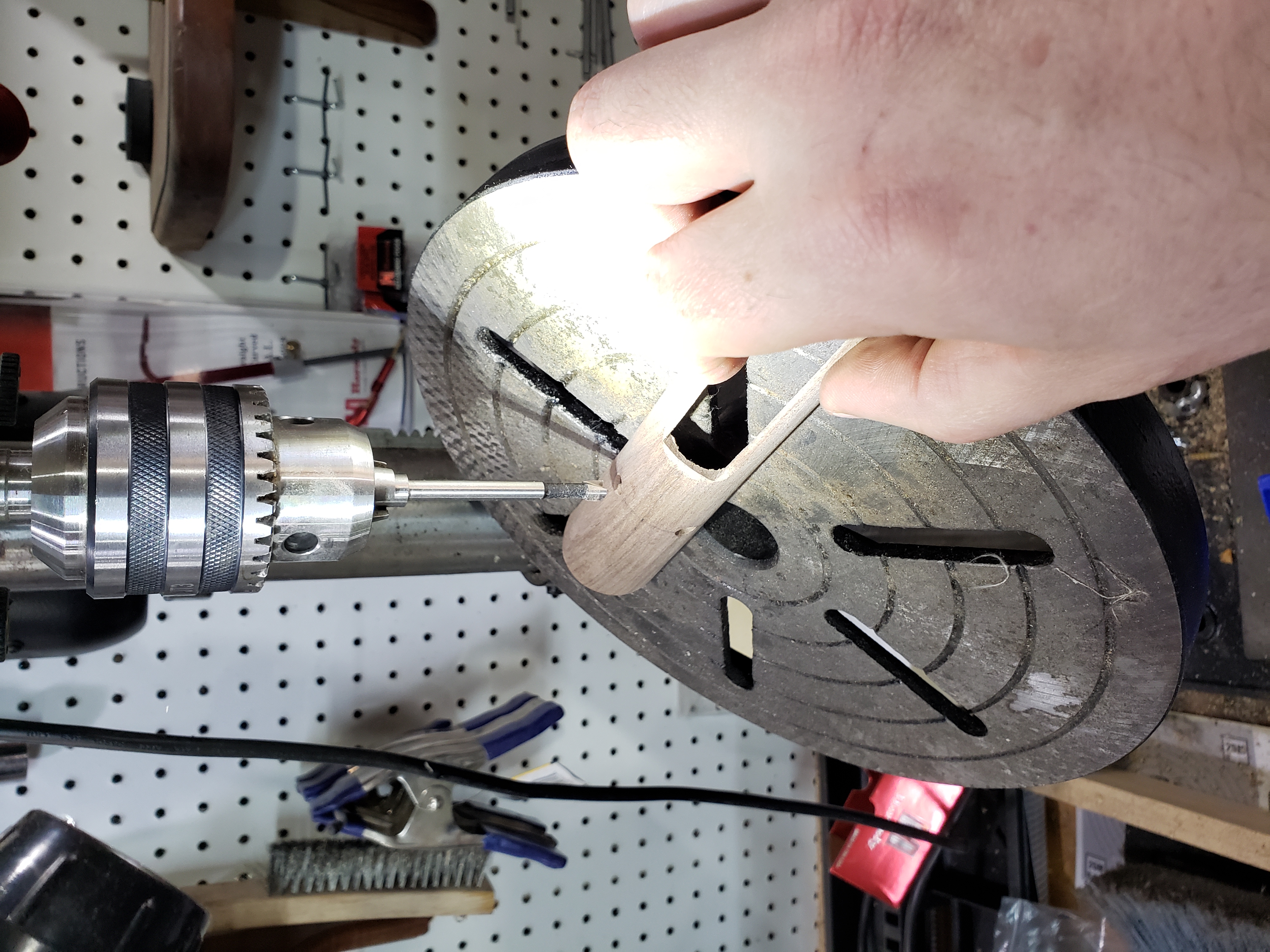

    How to fashion Krag handgaurd clips and rivets.
    See above for a source of 1/4 head rivets with 1/8 shanks, soft steel, on eBay.
    Here is step one..after fitting the handgaurd (sides flush with stock, sight cutout finalized, etc.
    I laid out with pencil the centerline, and the center of the pre-milled grooves of the handgaurd. then measured the distance between rivets on my original on a piece of paper, and transferred to the new. I lightly dimpled with a center punch...lightly. the handgaurd at the grooves is < 1/4 thick..
    Next, a 1/4 forstner bit on my drill press. I tilted the table until I had tangent to the curve of the handgaurd.
    Handgaurd is tapered, so only one way to do it and that is holding it freehand. It was easier than it seems. Go just a little bit to trace the outline, check for even depth for-aft, side-side, and adjust. go a little more. I have no room for error on the depth. the new gaurd came a bit thin to begin with.
    Next, use a 1/8 bit on a hand tap to drill the through hole. The advantage of the hand tap is it will not clean the hole out. You don't want it clean. This way, the loose fibers will keep the rivet really tight when you push it in.
    Double check the depth of the countersink...cleaning out the bottom if needed. Be very careful. just a kiss of the forstner bit, twisted with your fingers not the drill press - and we are all done!
    Now I can start on the finish while I wait on my sheet metal in the mail.

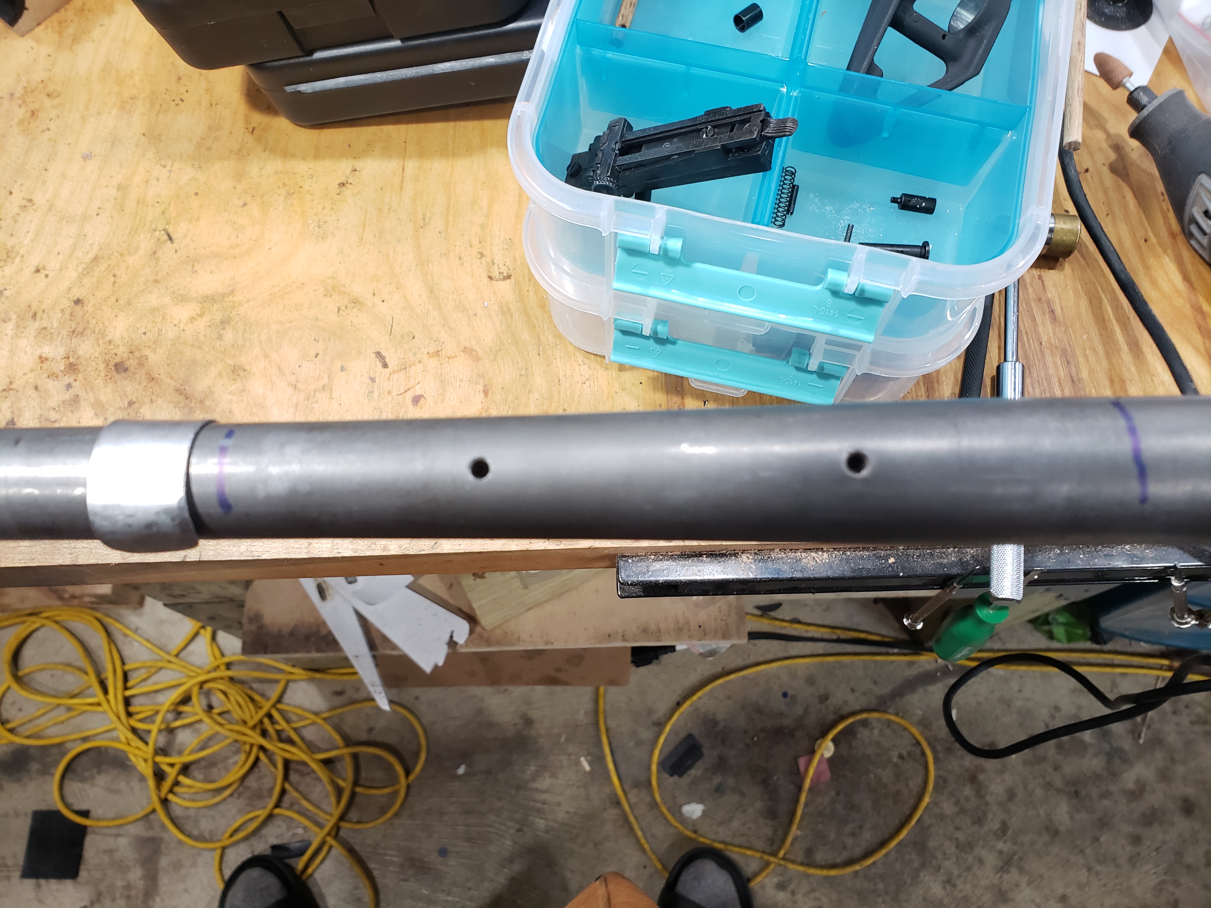

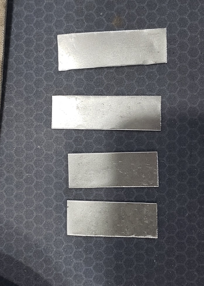

    original clips are 24 gauge steel. All I could find was 24 gauge galvanized, which is a bit thicker.
    1) measure the diameter of the handgaurd grooves. the originals seem to be about 2/3 the circumference, so that's what we did. I cut two sets just in case. Pound them back out flat on the anvil, then use a stone on the dremmel to round the corners, and make the cut side as straight as possible. Lastly a file to get all the burrs off. Don't want these to scratch the barrel.
    2) Next, I ground off the galvanized coating with the dremmel, and sanded to 240. Easier to do when it's flat.
    3) I marked the old barrel where the bands would be. Then clamped it in the vise, and formed the clips, pressing it around while holding the top, then use a hammer to curl the ends around.
    I started just below where they would go, so they would slide up tight, but this doesn't exactly matter. Slide the bands up to widen until they match the radius of the handgaurd. After we rivet them in, we will curl the ends slightly to make it clamp tight on the barrel.
    4) hold them in place in the handgaurd, and use a sharpie to mark them for 1/8 holes. Then put them back on the barrel and center-punched, then drilled out the holes and de-burred with a large bit.
    5) put the rivets through the wood and clips, and use a sharp pencil to mark the inside. Then I ground down their tails on the grinder until just my mark showed.
    6) Slow rust blued the clips, and the heads of the rivets, with mark lee's express. I started by just heat-bluing the heads to a nice peacock blue, but I could only get a nice even color if I polished the heads first. The originals aren't perfectly smooth, and have their bluing intact, so I decided to not get fancy, and match the original finish.
    Next post, install everything and peen over the tails. Then, curl the ends of the clips to hold tight.
