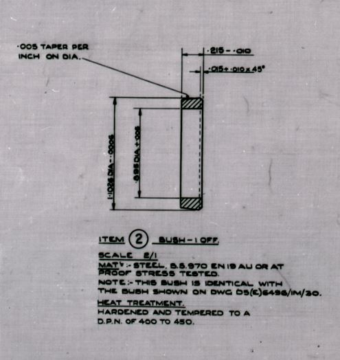

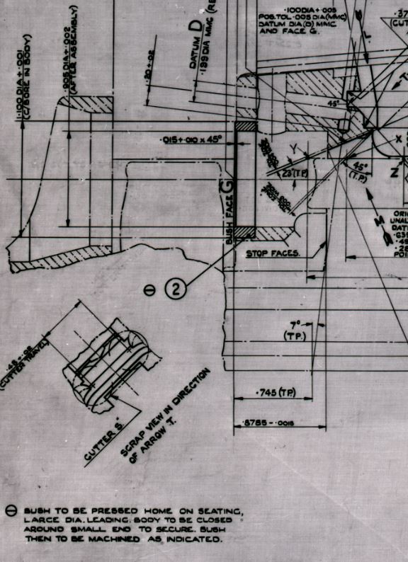

    is this the info you are after ?
  6. #15
    Legacy Member Kev G's Avatar
    Mar 2008
    03-18-2025 @ 09:32 AM
    564
    05-30-2025
    02:30 PM
    Item 2 in the drawing

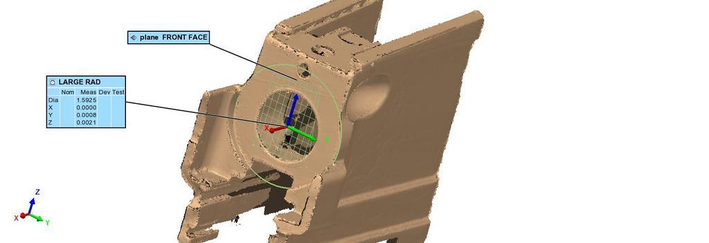

    This was laser scanned from one of my Bren cut receivers.
    The dimensions minge be handy~
