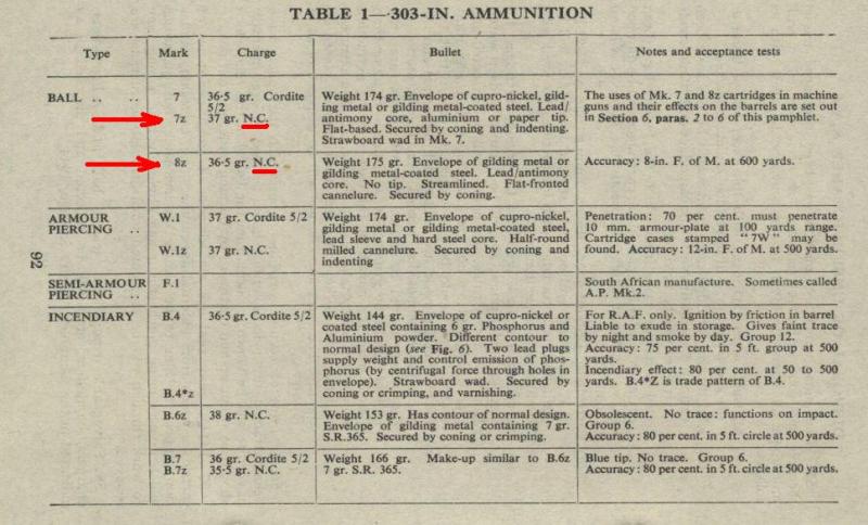

    And now we need only know which barrels are "N.C." and which are not!
    And I assume "N.C." refers to "non-cordite" or "no cordite"?
    Edward Bernays, 1928
  11. #19
    Nov 2007
    Today @ 12:50 PM
    Y Felinheli, Gogledd Cymru
    2,747
    Alan De Enfield
    06-11-2025
    08:39 PM
    Nitro Cellulose
    https://i.postimg.cc/hGpJL7sy/Mk7-M8-ammunition.jpg
    Hmmm - looks like there may still be some glitches in the forum - cannot upload pictures.
