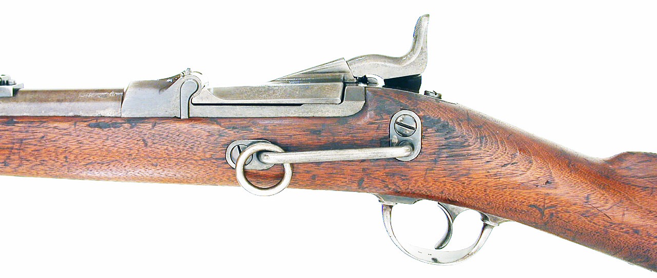

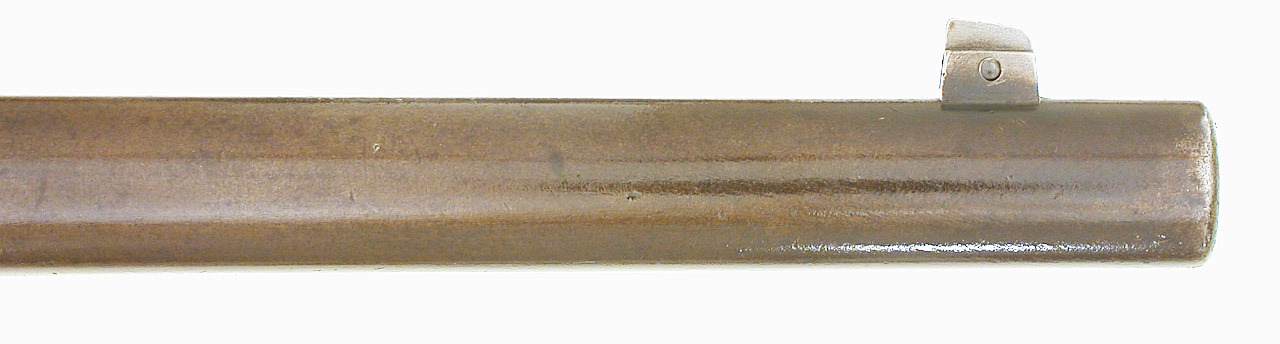

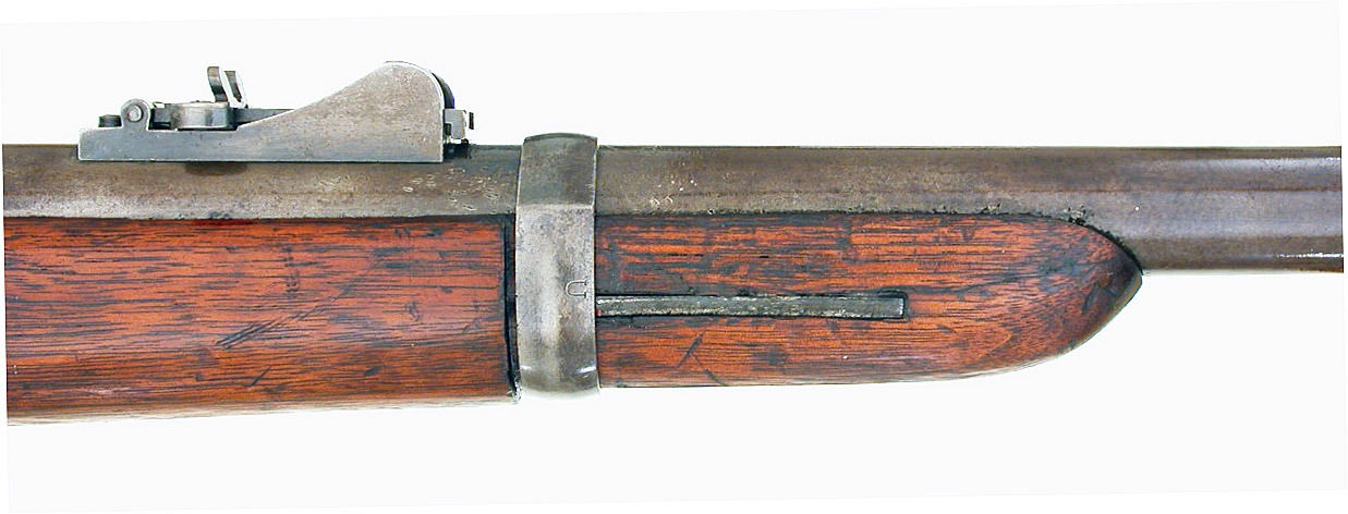

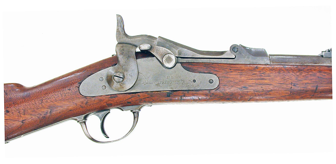

    A few pictures from the original add.
ID:	123517   Click image for larger version
ID:	123518   Click image for larger version
ID:	123519   Click image for larger version

    I see nothing from pictures supplied that looks wrong. Just the bug about the serial number range. if the price is right get it.

    Backsight originality ??
    I think the backsight may have been retrofitted. It seems to be a bit "fresher" than the barrel on which it is mounted. Take a good look at the way it sits on the barrel.
    To understand better what worries me: look at the first photo. Between the front of the backsight and the back of the barrel band there are multiple little dings on the barrel. But the backsight is unmarked.
    Odd. Very.
