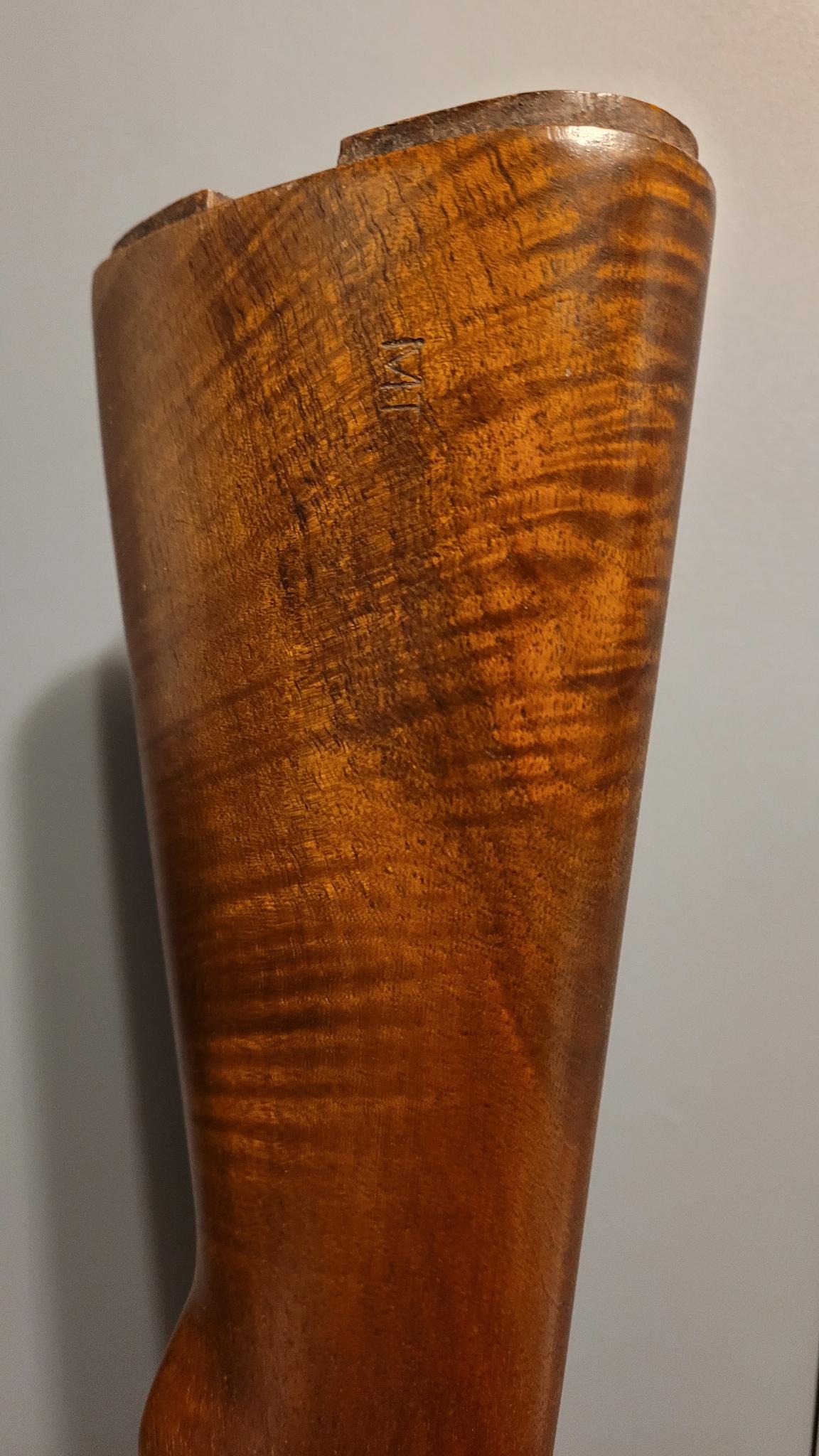

    Tung Oil Results
    By the way, here is an NOS Italianicon stock from 1971 that had its stain stripped, dyed with "mission brown", and then 12+ coats of tung oil

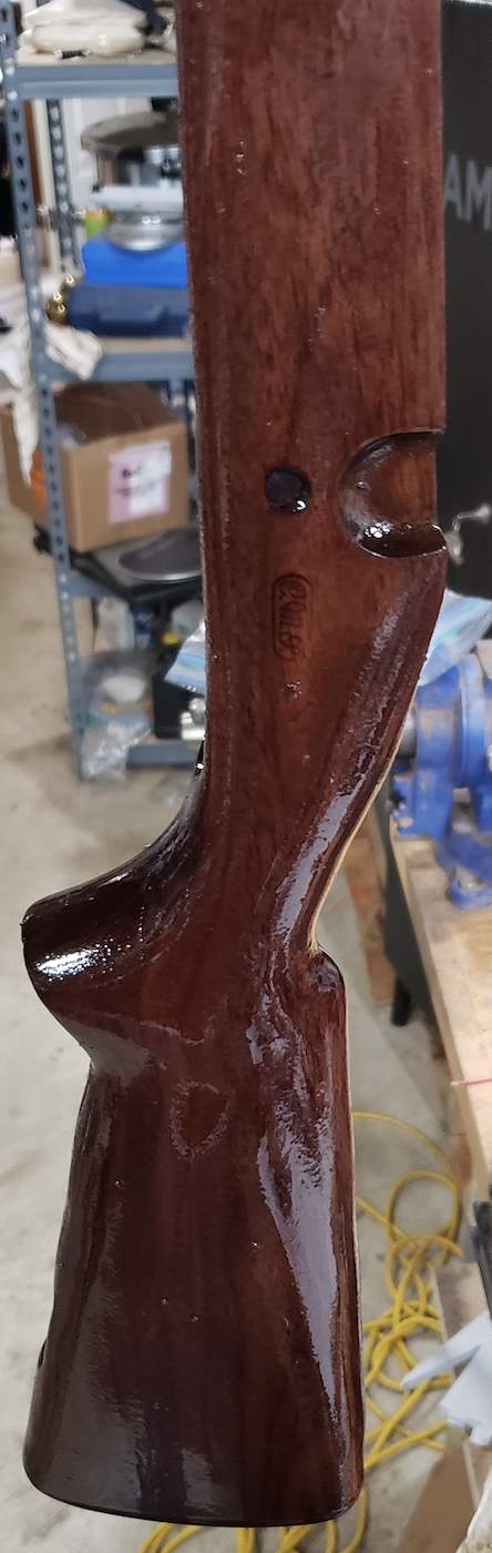

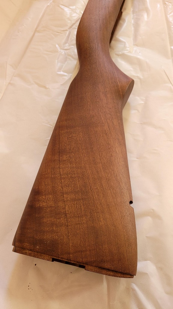

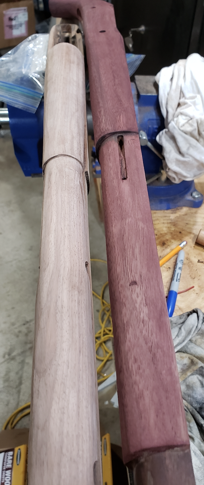

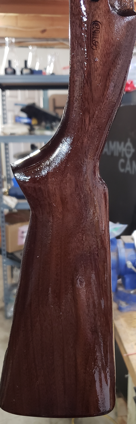

    I just happened to be doing an old CMPicon replacement stock for a 1903 today. It came on an M1903 parts queen I restored, had an ugly brown stain, and previous owner oiled it with something petroleum base. by the looks of the the inside, it was grease. Anyway, I finished sanding yesterday. The wood is pretty cheap mix of sapwood walnut. I'll collect some pics for you so you can see how it went.
  13. #10
    Jan 2020
    Today @ 01:21 PM
    Virginia
    1,716
    07-01-2025
    06:35 PM
    here you go. first pic is after staining with alkanet-alcohol last night, against a raw NOS scant I'm also working on for comparison of color. Next pick is after applying first bath of raw linseed oilicon today, then after letting it set for a couple hours, then I wiped off the excess and took the last pic.
