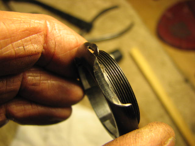

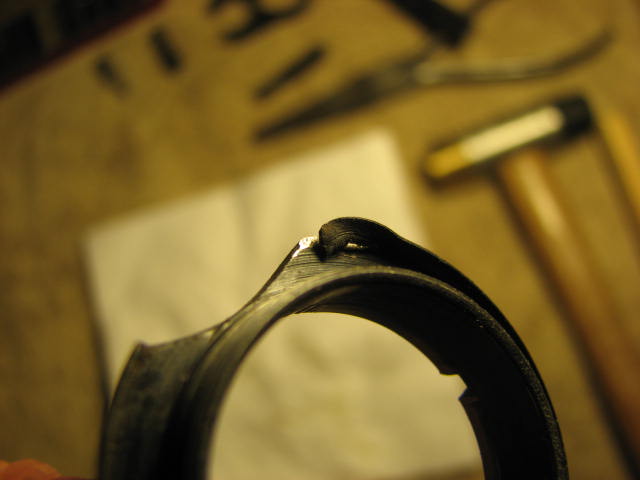

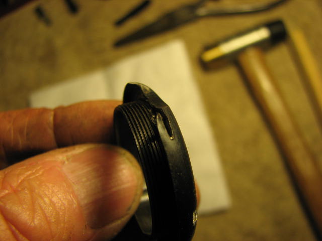

    DISASSEMBLY
    Decided to disassemble the barrel and mag tube for inspecting and cleaning. The mag spring has some rust and should be replaced. Tube and follower OK.
    The slide sleeve cap apparently had some strange, sloppy work on it and I wonder if anyone can shed some light on what and why -

    Quote Originally Posted by Madcap View Post
    Looks like someone was at it after the factory.
  8. #26
    Legacy Member baltimoreed's Avatar
    Jun 2021
    11-04-2024 @ 09:59 AM
    Aurora, NC
    114
    Ed Evans
    05-12-2025
    12:09 PM
    That’s weird the way it’s cut. While you have it apart put a 6 round kit in it. Just looked on eBay but didn’t see one. You might try GPC.

    I'm leaning more to converting it now to a trench but I still need a heat shield somewhere for the bayonet adapter. One might be able to made but it's probably going to take a while either way to make one or find a compete assembly already made up.
    Meantime I can't understand what someone was up to with that sleeve cap....

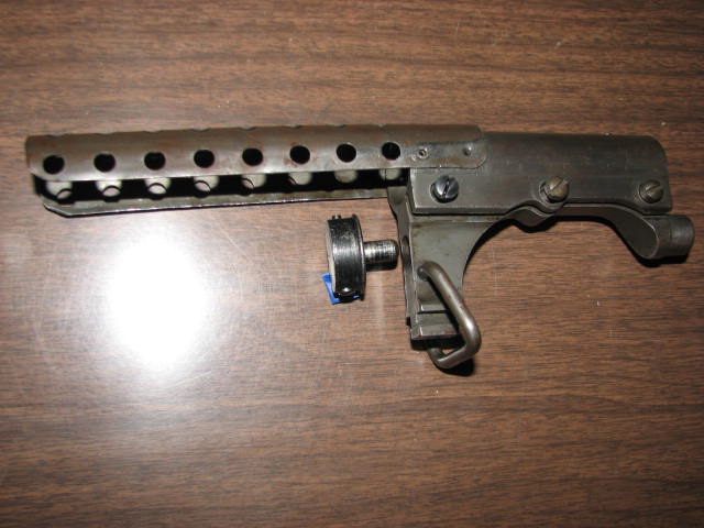

    If you’re interested in proceeding with the laser cut heat shield, I’ll need the remaining stub in hand to make a more accurate drawing.

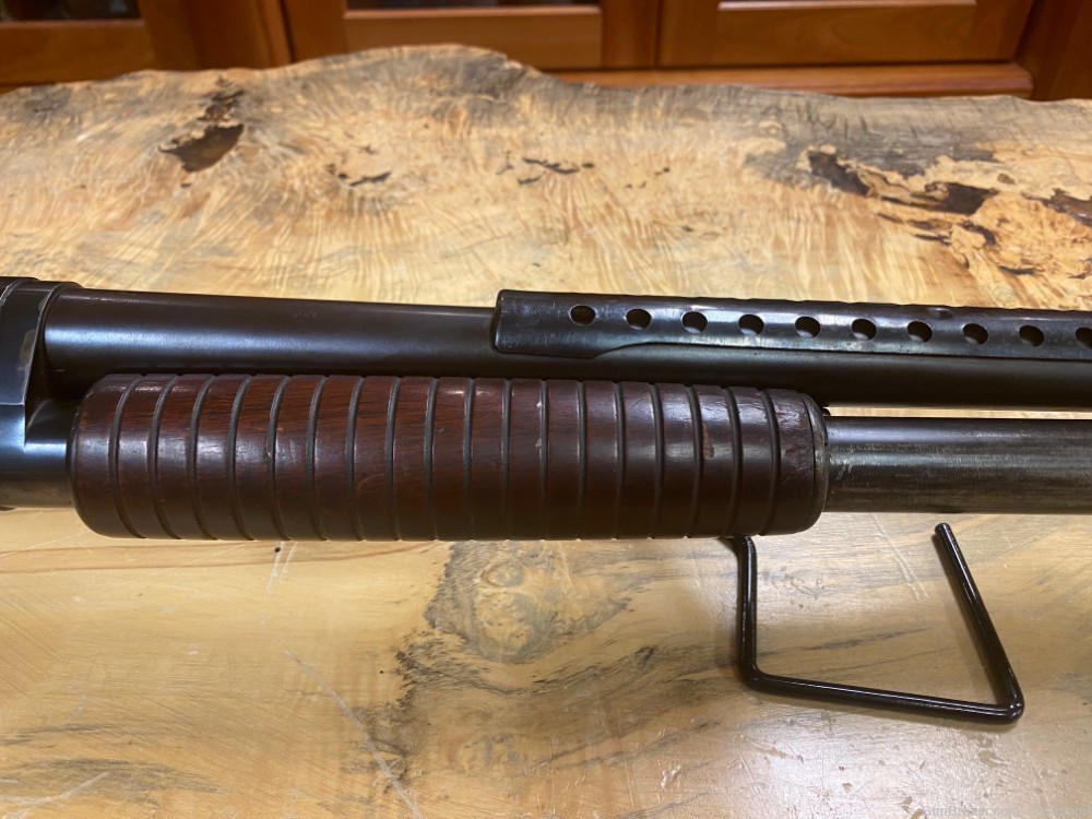

    I'd like to give a try but wondering how we would measure and reproduce the rear part of the shield that's flared out - all I have is 5-1/2" of the forward portion.
    PM your address to me and I'll mail it to you -
    Dick

  12. #30
    Dec 2012
    04-20-2025 @ 08:06 AM
    St. Louis, MO Area
    1,645
    05-12-2025
    01:09 PM
    Should be a learning experience for all of us!
    Once I have the shield-stub in hand and get precise dimensions, I should be able to scaled off of pictures on the internet for the flared end.
    It won't be perfect, and forming the round shape from the laser cut flat won't be easy, but it'll be interesting!
    I'm happy to lend a hand on an interesting project like this!
    PM sent.
    -Ryan
