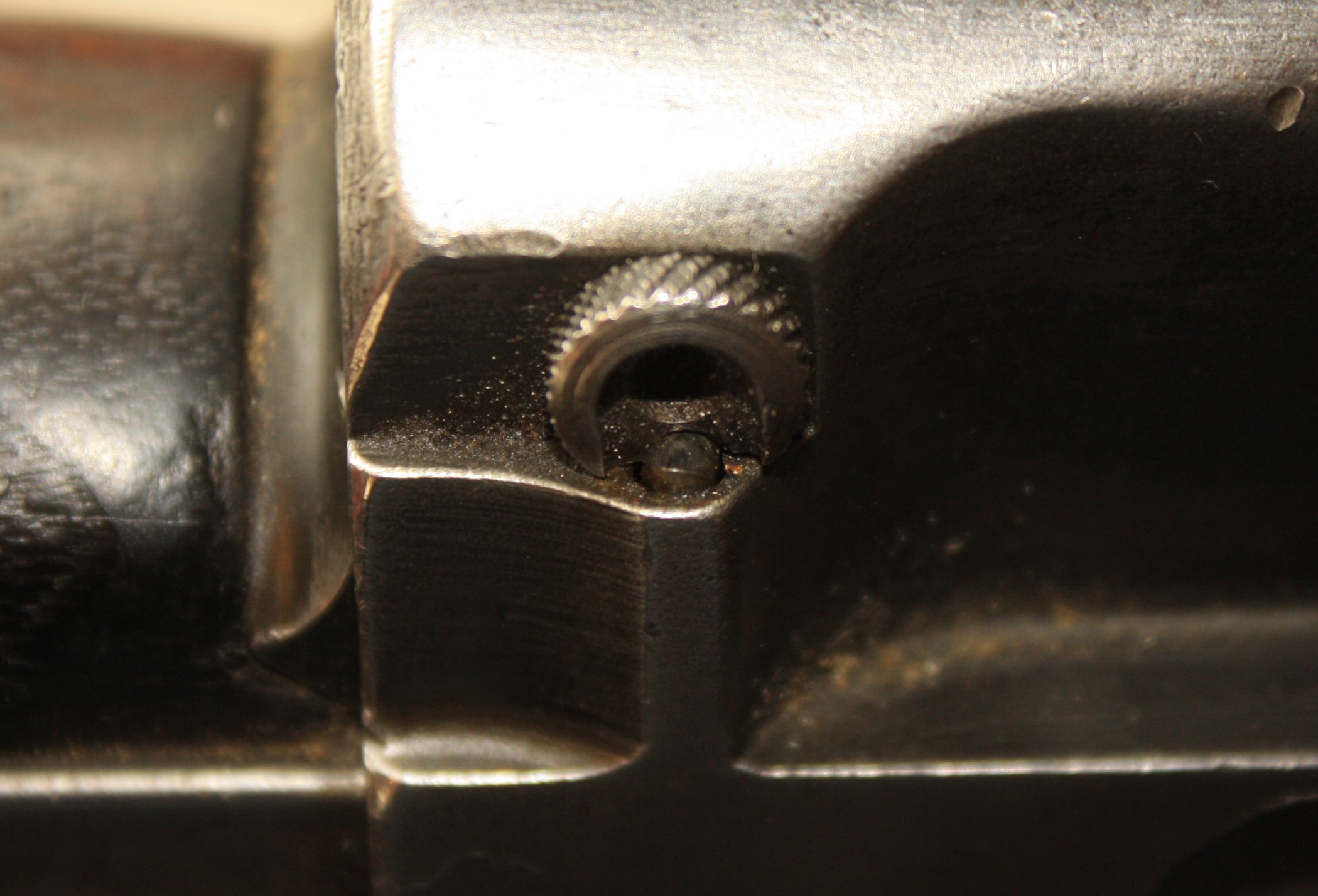

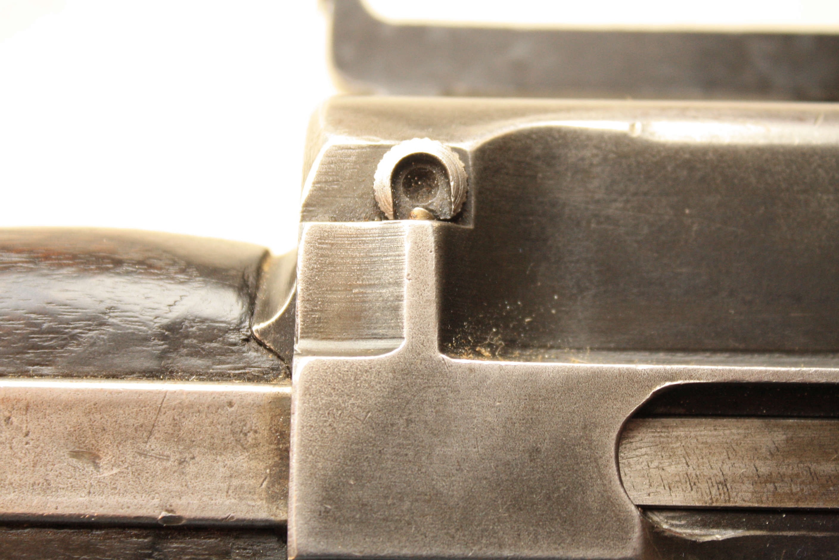

    Hi Erik

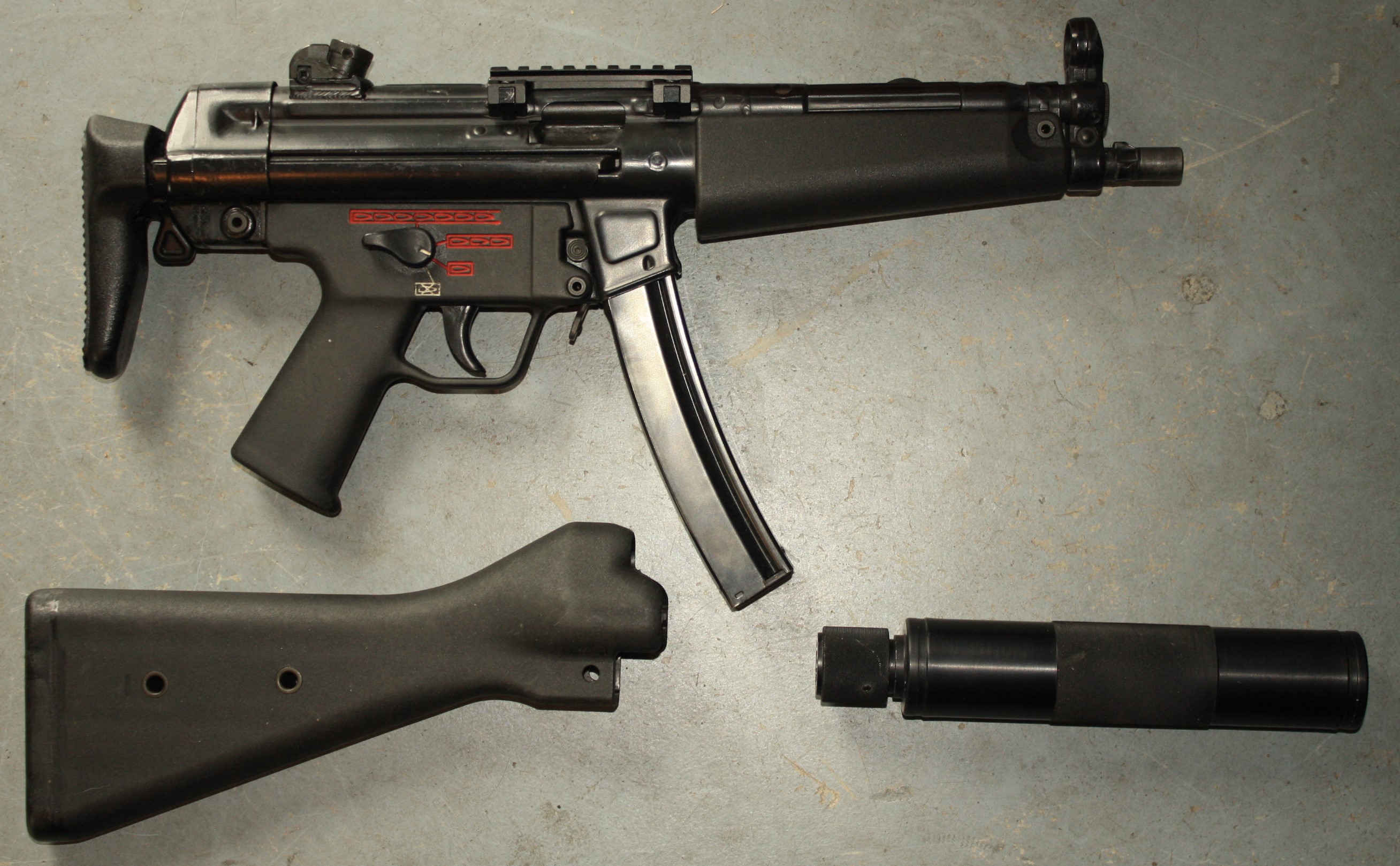

    Some photos attached of my MkI Bren body locking pin detail and as a teaser, my MP5A3 with a couple of accessories. As a classically trained draftsman (55 years ago) I am greatly impressed by your drawing program and your mastery of it!

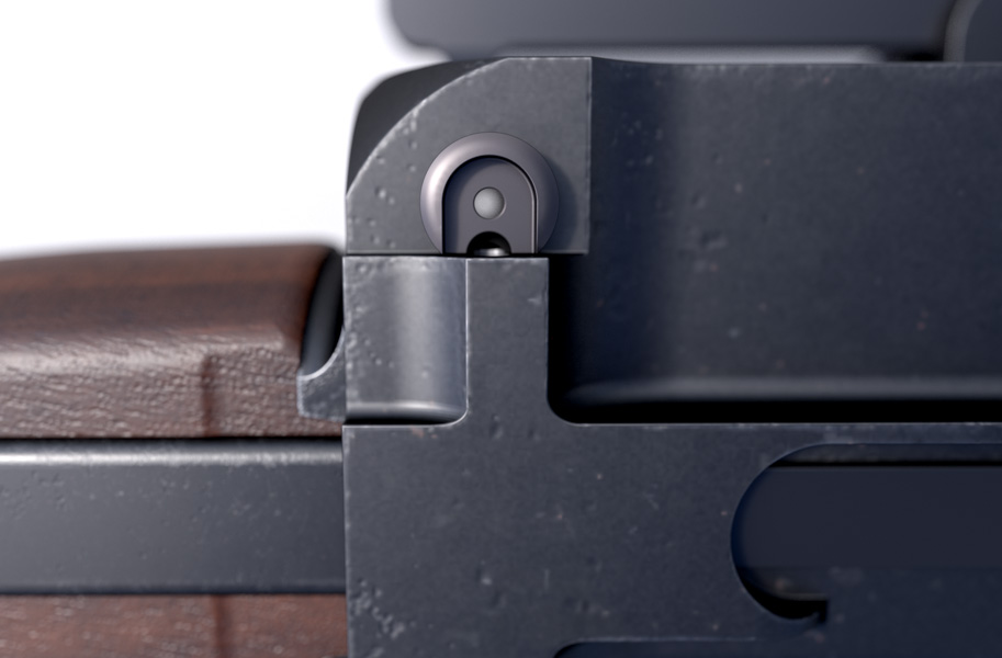

    Thanks again Woodsy!
    From the rounded top it looks to me like your BREN is an older version than the one my model is meant to resemble.
    My model is intended to have an MkI* body, so it could perhaps be called an 'MkI modified' following the description in 'The Bren Gun Saga'.
    That still doesn't mean my model is correct mind you, but if yours is indeed older it should at least be different in some places.
    Cheers!
    Erik

    Erik, my gun is an original 1938 Mk I. Your last photo shows the detail much better and it looks fine.

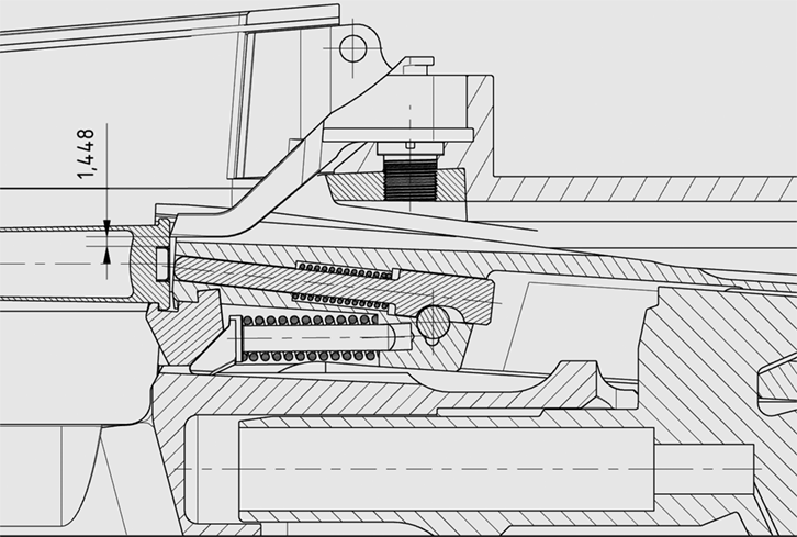

    I was curious about where exactly the ejector would hit the cartridge case in my model:
    There appears to be almost 1.45 mm between the impact point and the edge of the primer pocket, so the ejector wouldn't actually touch the primer.
    Of course my model cannot be much more than an approximation, in reality it could very well be less of a distance, but not very much less.
    Still, with enough force, and given the chisel shape of the ejector, I can imagine it would deform the case enough to locally crimp the primer in place.
    It was a long time since I last fired a BREN, I simply cannot remember what those case bottoms looked like. If any of you have a clear photograph of the ejector 'bite' marks on a .303 case I would sure like to see it, so I can check if my geometry comes close.

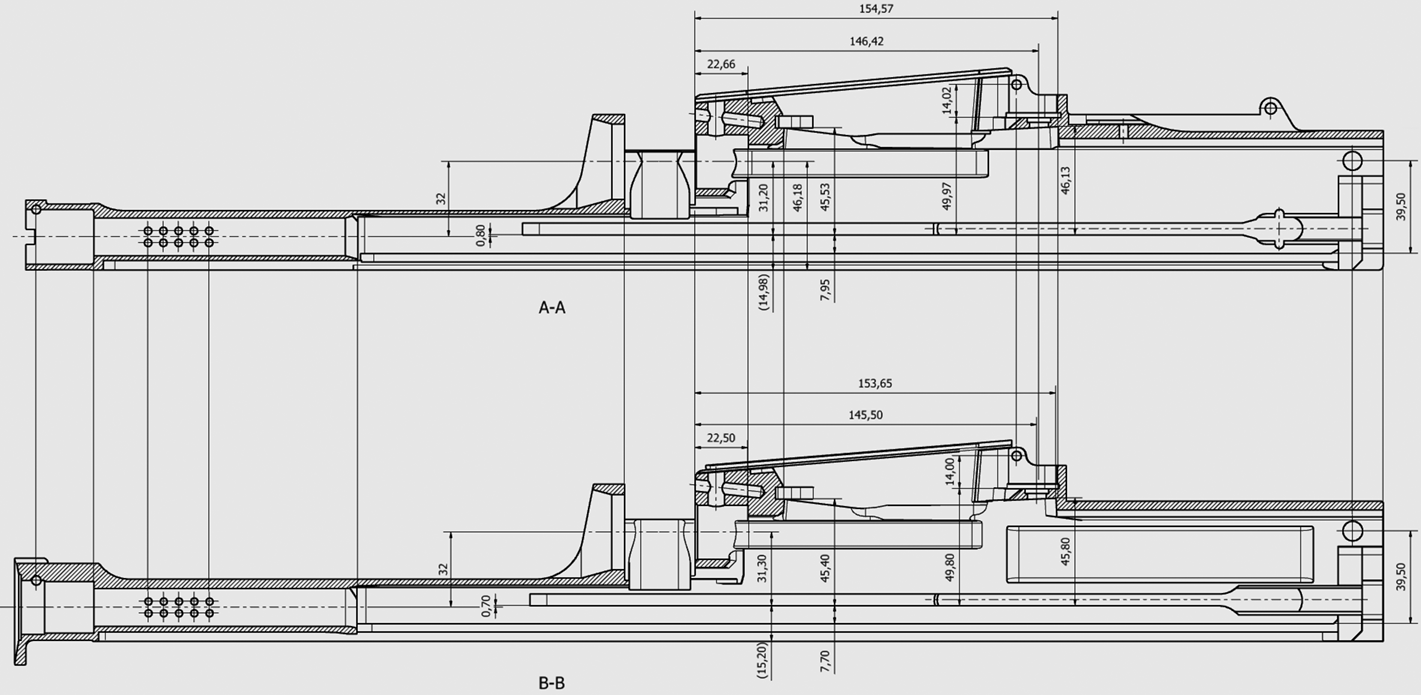

    Thanks to forum member SNAFU22, who almost a year ago posted a drawing of the Mk2/1 receiver that I stumbled upon only last week, I was finally able to thoroughly check my 'reverse engineered' MkI* body model.
    Based on the assumption that functional dimensions did not change between versions (for backward/forward compatibility of major parts), I think that Mk2 drawing should be a valid reference.
    To do this comparison I modeled the Mk2/1 body based on the drawing's nominal dimensions plus (or minus) half of the indicated tolerance.
    Some dimensions were difficult to read, especially numbers 8 and 3, 5 and 6, but all in all that drawing was a fantastic source of information.
    Turns out that on the whole my interpretation was pretty much spot on (yay!)
    ... Except for the all important location of the locking shoulder seat (bummer!).
    Even though my model is merely intended for documentation/illustration purposes only, this particular dislocation is way too much to my liking (ca 0.92 mm hor, 0.33 mm vert), so I'll fix that.
    There still are a few grey areas to be filled in for completeness, and lots of questions about certain design features (why the strange lateral offset of the return spring?), but I am very happy about the progress made so far.
    Thanks again to all who (unknowingly) contributed, especially Peter Laidlericon of course, and SNAFU22 for that wonderful Mk2 drawing!
    Here's an image showing that comparison: Top (section A-A) is the Mk2/1, Bottom (section B-B) is my MkI* model (dimensions in mm's)
    Cheers!
    Erik
