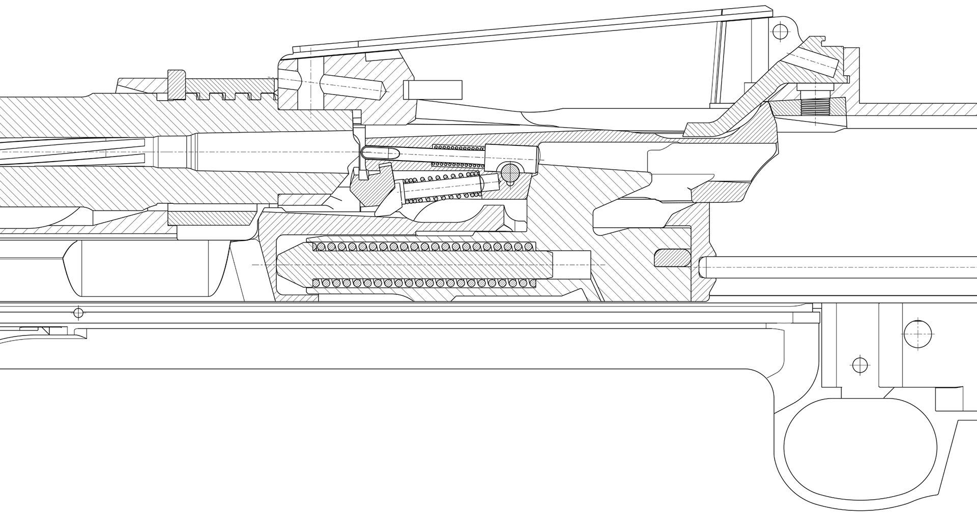

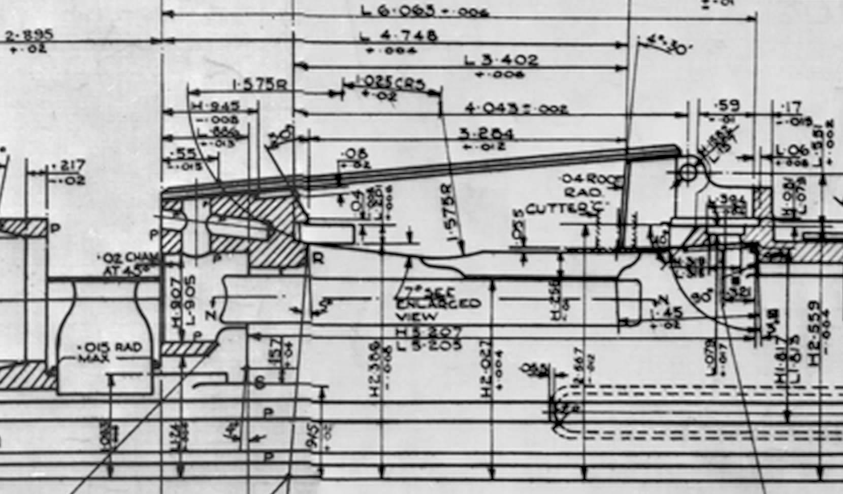

    Hi erik3D, here is another print of the mag well. The pdf. I have of the receiver print has much better resolution than this. If you still need more dimensions, let me know. I could get them or I could email you the print.

    @SNAFU22
    I've used a 4 MB .png of 2376x1836 pixels that I downloaded from your answer in the 'MK 1 Cycling issues' thread. A careful cleaning session in Photoshop did much to improve it, but there are still some blotches that I can't really read.
    Here's a similar crop after treatment:
    Is your original .pdf much better that that?
    If so, I'd sure like to have it!
    The other drawing crop you've uploaded is one of the few drawing fragments I've found here when I started this 'project'.
    It looks like a photograph of a much clearer drawing, and of a slightly different version.
    If only there were more pieces of that particular drawing to be found.
    Better still of course would be a crisp, undamaged, high rez drawing of an MkI, but it seems none are available.

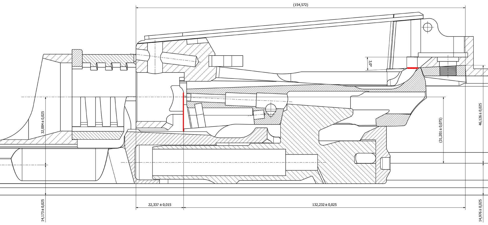

    Here's a drawing with some of the dimensions I've derived from your Mk2/1 drawing (in mm's), combined with other parts I already had.
    I've marked in red two areas where I think there should be some clearance to make things work properly.
    Looks like the bolt I drew is a little bit too long, and it is pushed up a tiny bit too high by the bolt carrier.
    This design doesn't appear to allow for much deviation from the theoretical dimensions of its essential components!
    In practice that can only mean that, apart from the barrel and matching locking shoulder, you'd have to be very careful selecting parts (upper receiver, boltcarrier, bolt) to make sure they work together as intended.

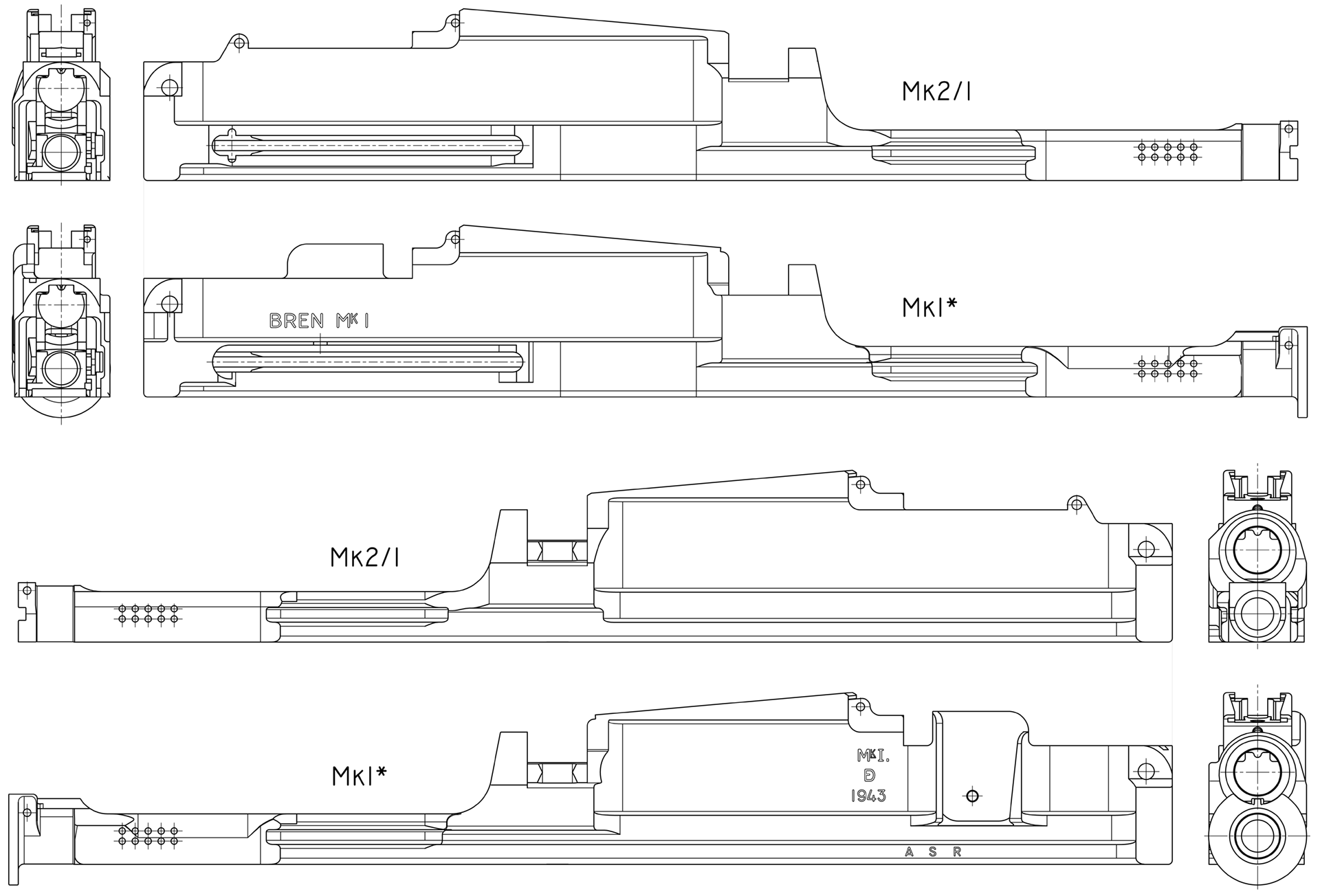

    Here's a drawing that should be accurate enough to be used for illustrating a question or perhaps an answer about the BREN design.
    Feel free to edit it to your hearts delight in your favorite painting program : )

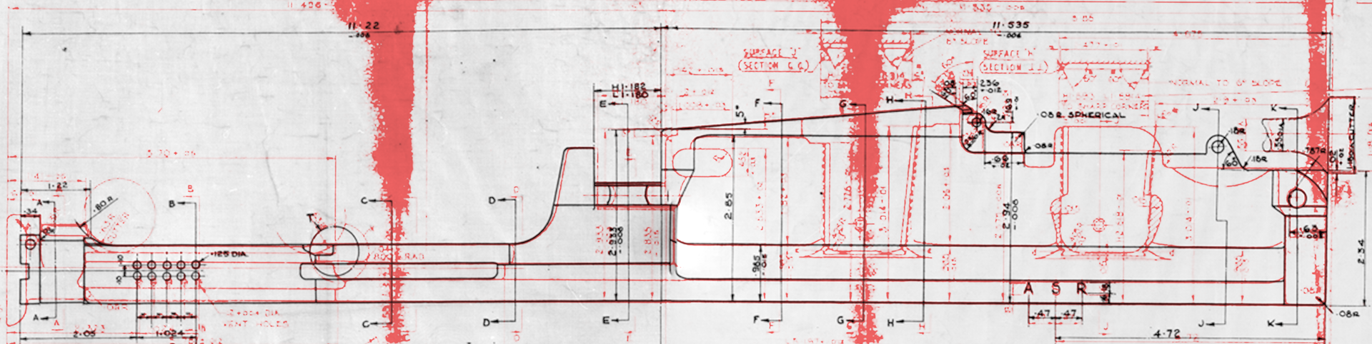

    It's a pity that original Mk1 drawings still do not seem to be available to the general public.
    Making do by combining information that is may fill that void to some extend.
    I've superimposed a (fragment of a) drawing of the original Mk1 over the Mk2/1 drawing that SNAFU22 posted to make visible the differences between them.
    (black lines are Mk2/1, red lines are Mk1 double dovetail)
    It looks like the overall contour didn't change much; most of the lines overlap or deviate only a little, mostly due to folds in the scanned drawings.
    This certainly helps to validate my assumption that a drawing of an Mk2 could well be used to reconstruct a drawing of an Mk1, which I did here:

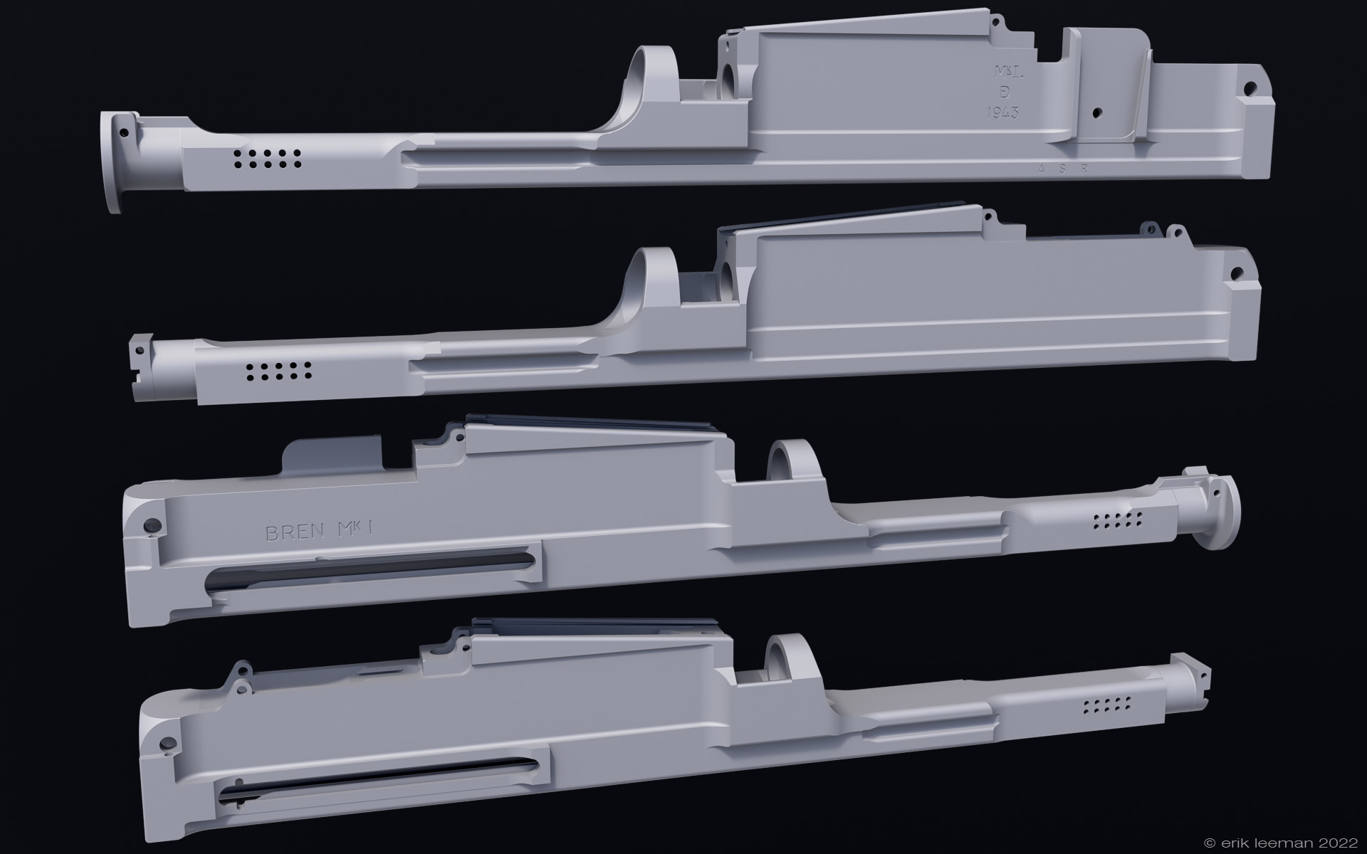

    In 3D that comparison looks like this:
    Hope some of you find these images useful.
    Cheers!
