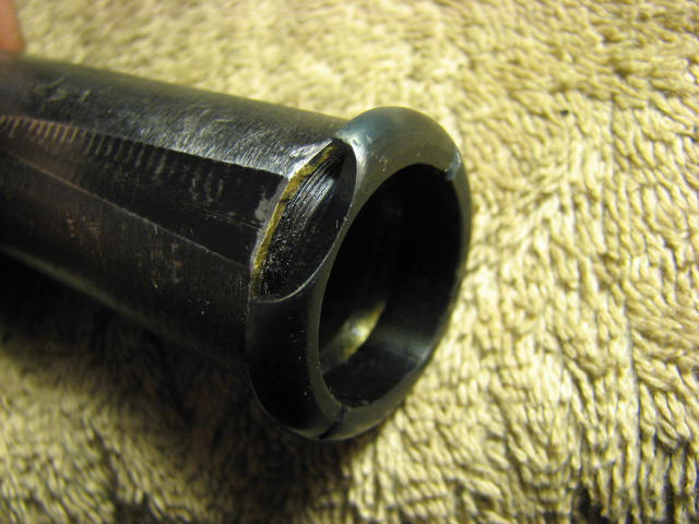

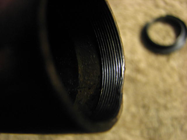

    OK, it's separated - but - I messed up the edge tapping it out with a brass drift punch.
    Apparently the steel screw cap threads into a matching threaded brass insert inside the end of the tube. Despite using a brass drift on the edge of the tube to nudge it out of the arm, threads along one edge got messed up. I assumed the entire tube was steel including the threaded end but that isn't the case. Unless the threads are re-tapped or dressed up somehow I'll be looking for another action slide. I never anticipated that insert being brass - guess it makes sense though now that I think about it...nuts.

    Dress those back with a fine half round file. Keep working at it gently until everything fits again.

    I tried a small half round file after discovering what I'd done. But I think the initial tapping also managed to peen the edge along that area enough to slightly raise the radius. I'll continue while filing and try threading a spare steel cap into it and hopefully re-cut the damaged threads.
    Thanks Jim, I'll check back with any results

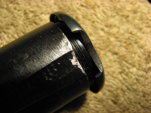

    Saved It!
    Your inspiration, and a little determination resulted in another successful learning experience...
    Thanks for you help my friend - but please don't go too far away, I'm probably going to continue to need education in the future too.

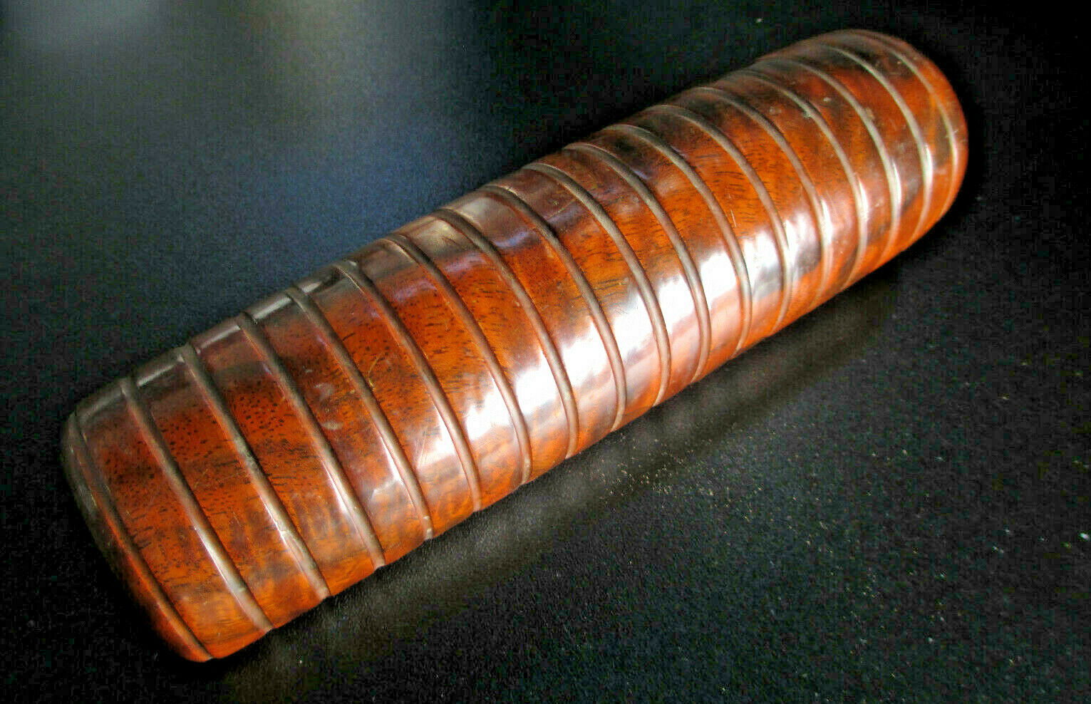

    P.S. I want to replace the original slide arm with an 18 row arm - do you know if any 12ga arm work?

    All 12 ga should fit.

    My two rebuilds have 18 groove pump handles, one [the riot] is from 1925 and the other [the trench] is from 1940.
