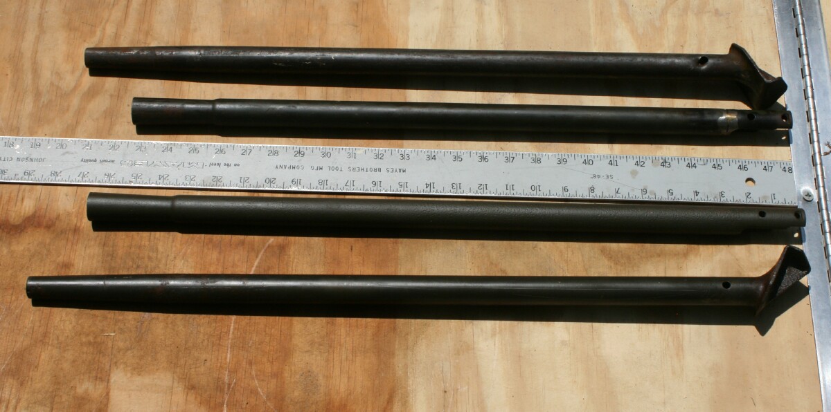

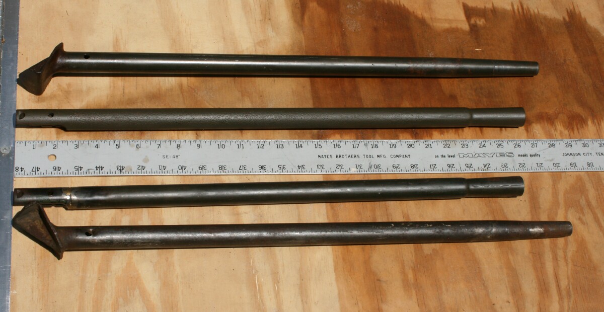

    Start of AA pole info
    On my list of things to do this weekend.
    Hope you like the 2 pics, more coming. It was 100F feels like out when I took them.
    Later Sat night or Sunday I'll measure everything and then post it.
    Note these are different and I think one was repaired sometime.
    One is AGE and the other is BSA, both marked, Top part is only piece marked.
    More Later
    42rocker
