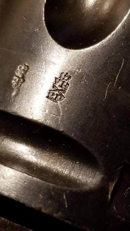

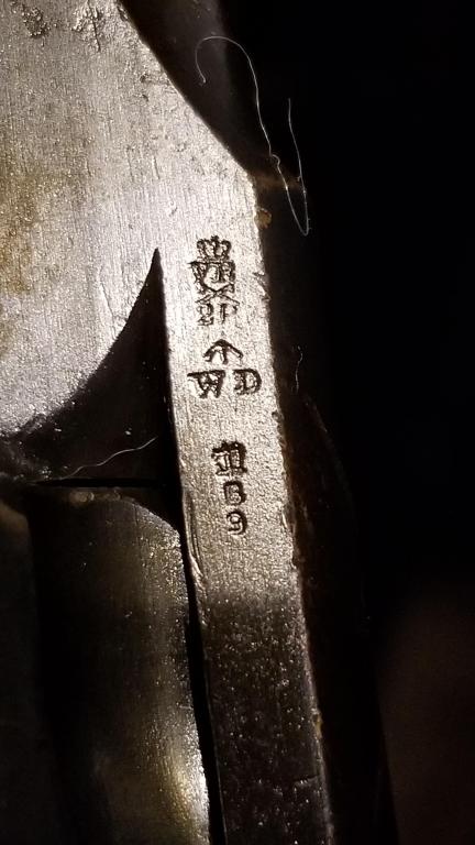

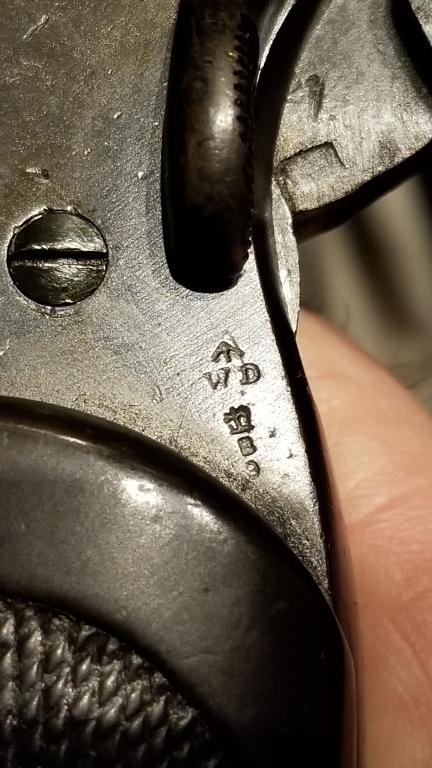

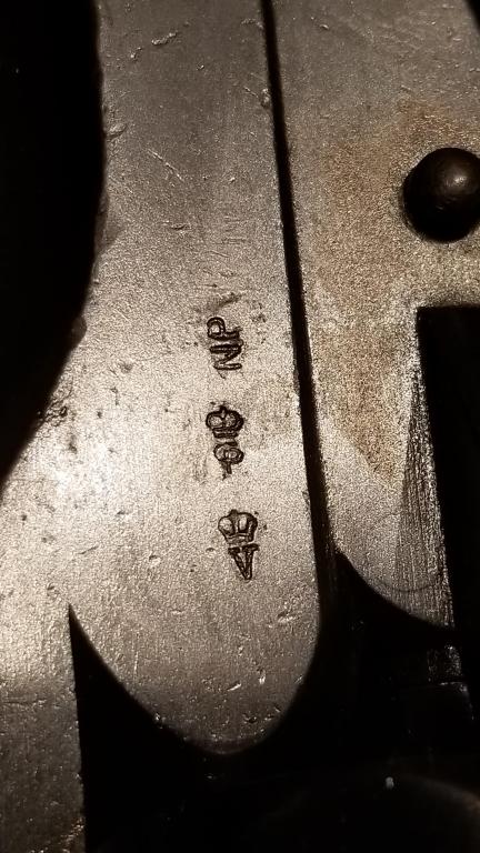

    And although I'm still mostly enjoying repairing and shooting Lee Enfields, a new critter recently came to me. A Webley MkII
    In great shape, but I am wondering if it's been nitro prooved (proofed?), and I am having a hard time finding clear reference for the marks on it. So... if anyone knows if this "NP" stamp is what I think it is... Thanks in advance for any help!
    Other stamps found on it:
    Advisory Panel green's Avatar
    12-22-2023 @ 08:18 PM
    445
    05-09-2025
    07:28 PM
    London Proof House commercial nitro proved stamp.

    Thanks Green, very much appreciated!
    Not that I want to load that old Webley with hot ammo, but it is reassuring to know that I have some options as far as reloading powders go.
