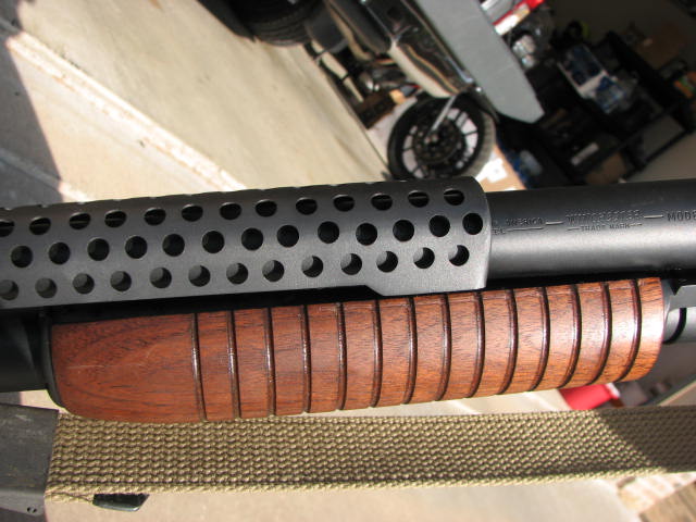

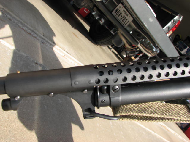

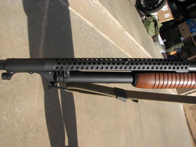

    My buddy originally had an East Taylor M12 adapter for his commercial Model 12 conversion but said fit loosely so chose the M97 instead. His conversion was done by a professional with the M97 adapter and from my impression it looked perfect. Anyway while I'm waiting for my East Taylor adapter I'll try fitting one of the flats out of curiosity.
    Photos are the conversion mentioned above -
    Dick

  5. #93
    Legacy Member Madcap's Avatar
    Jan 2022
    08-28-2024 @ 06:11 PM
    Hill Country, TX USA
    197
    Dick
    05-12-2025
    06:59 AM
    Yes, I had one here and if you don't use the original diameter barrels it's sloppy. They apparently made one also to fit slim barrels although I can't prove it.
    According to the East Taylor website page the Model 12 adapter is specifically made for the M12 commercial barrel due to it's narrower diameter but to be clear my friend said the M97 was a better fit for the M12 commercial barrel. From my impression it certainly looked like a perfect fit.

    how does your bayonet adapter fit after cutting back the barrel? I'd imagine if the heat shield didn't rest perfectly against the barrel on its dimples, it could be massaged into perfection.
  8. #95
    Jan 2022
    197
    Dick
    05-12-2025
    06:59 AM
    My original adapter fits flush with the end of my barrel as it should for the M12. You may notice his barrel extends past the adapter for some reason like the M97.
    The dimples on his shield sit just slightly above the barrel and when the gun is held as in firing, the dimples rest firmly on the barrel as I would assume they're originally intended.

    Briefly checking in - nothing further to mention as this point on bending the flat heat shields. I haven't had much time to devote but hope to get back to it ASAP. I'm planning on visiting a couple friends that may be able to provide assistance. I feel confident something will work out and I'll be looking forward to posting any results.
    Regards to all...
  11. #97
    Jan 2022
    197
    Dick
    05-12-2025
    06:59 AM
    Yesterday I consulted with a long time friend and former Australianicon Navy machinist and he gave me some 4130 pipe the same diameter as the M12 barrel. I hope to get it cut in half and make some male/female plugs. Should be a simple enough job to hammer it in shape then. It might be a week or so before getting it cut but will get back. Also the rear end of rounded shield will need to be finished with a neatly rounded edge as noted in the photo.
