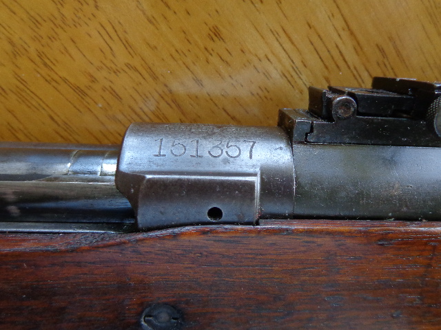

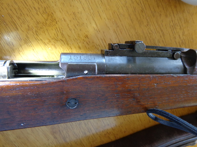

    "Extra" vent hole?
    Here are two photos showing the "extra" vent hole on the right side of the receiver, one with and one without a flashlight shone into the receiver showing it is drilled all the way through. If this is an extra vent, where might the first one be? From previous discussion, does it appear this may be a Marine rifle? I like the comment that it may have been reproofed; to what pressure one wonders? You would think there would be documentation of this work. Anyway, I think it's a fun shooter and have no qualms about using ammo my gunsmith uncle loaded back in the fifties as well as some I have reloaded (nothing HOT) in the last decade or two.

    Quote Originally Posted by RDG View Post
    That is the standard gas escape hole. The additional one is on the direct opposite of the receiver. The Army started to drill the additional gas escape hole in the Spring of 1937 on the new NM's and SA drilled it on all rebuilds going forward of that date.
    The Marines started to drill it in the fall of 1938.
    This rifle above I am sorry to say is unlikely Marine.

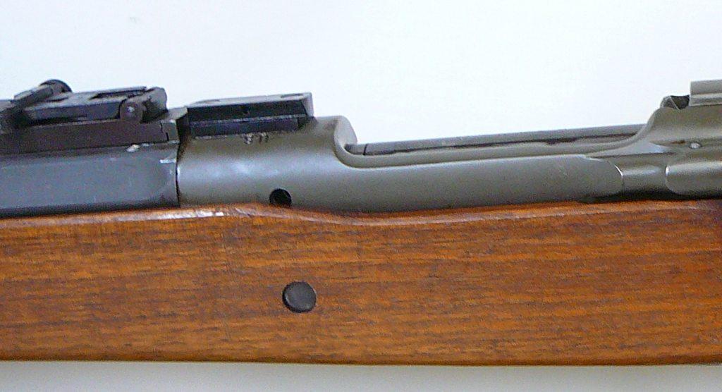

    But this is the additional gas escape hole. This one was drilled by the Marine Corps. But it's the same as the Army in everyway. In fact Springfield Armory is the one who taught the Marines to drill them.

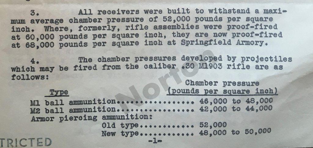

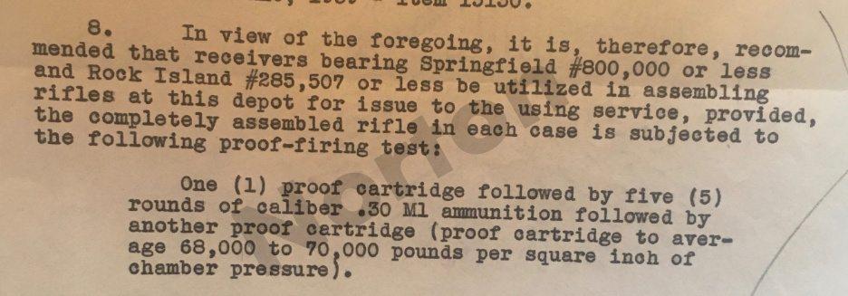

    It was 100% for sure re-proofed when the barrel was installed.
    The proofing changed over the years, but this was the policy in 1939. Some documents state the avg pressure of the proof round was 70,000 PSI
    This is how the Marine Proof Fired a M1903.

    Great information. This rifle has no added vent on the left side, just the one I showed in the last photograph. But a 1942 barrel and rifle proofed to as high as 70,000 psi is a win!
