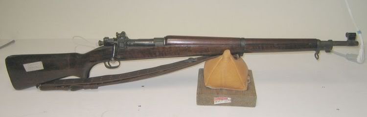

    Phillip:
    Gee, that picture looks sort of familiar. It is one of many Poor Man's Match Rifles that I built in the 60's. I still own that one. The rear sight is a Redfield 70ST.
    The record book indicates that it was last fired in competition in September 1984 at Reading, Massachusetts. I used cast bullets at 200 yards, a good lot of Frankford Arsenal 1937 M1icon ball at 300 yards, and Sierra 190's with 45 grains of DCM surplus 4895 for 600 yards.
    I do not recommend the Lyman 57, particularly the newer ones with the aluminum body. Steel threads in aluminum blocks wear out too quickly in HP use. Also, there is no slide lock, and the spring in the slide release does not effectively prevent movement of the slide.
    Resp'y,
    Bob S.
