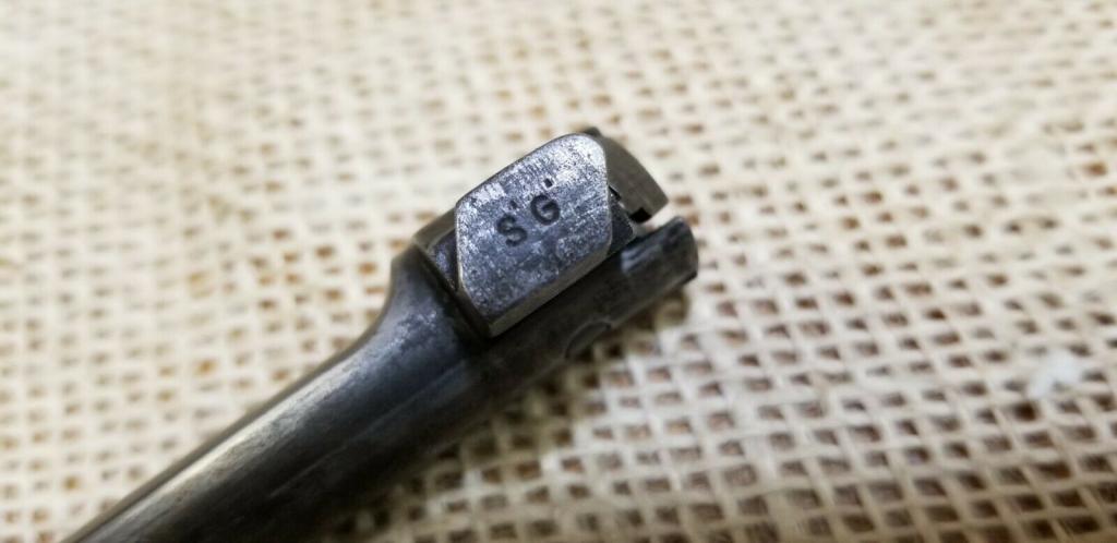

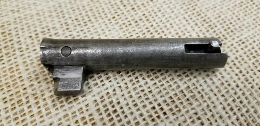

    S'G' Flat Bolt: Numbers under right lug (?)
    I don't recall seeing this best I can remember.
    A current auction has a S'G' Flat bolt marked S'G' on the end of the right lug, like we normally see.
    But under the right lug a number 2 can be seen. I suspect they might be worn off numbers that were in front of the 2.
    See pictures......... Any thoughts ?
    Charlie-Painter777

    I can't make another number in front of the "2" but under the S"G" looks like a 1?

    Or maybe a Serif I ?

    Charlie, I have (2) Carbines with Type II S'G' bolts. I don't have detailed pictures of them, but my data sheets show both as having S'G' on the Right Lug. One is noted as having a "flaming" bomb and in addition there's a notation that says: (A2 early). I have copies of data posted here by other members 10-12 years ago such as Trilux and Maniac. On one of those, I've also added the note (A2 early) - I may have gotten that information from posts here or somewhere else; I can't remember. I don't think either one of my bolts has that mark - just had notes to myself that an A2 mark could have been placed on early bolts. Probably not what you're looking for, though! - Bob

    Charlie, not a S'G' bolt but I found an IP bolt with a 2 under the right lug that looks to be similar to the 2 on the S'G' bolt you posted. It is on one of the CCC forums Featured Carbines.

    I see the Featured IP you linked is serial# 1,775,265. Agree the 2 on the bolt looks very similar. Also a 2 on the side of the E279 Slide. Receiver marked M4 at the rear rail / right side.
    Too bad we lost so many pictures, because a search here revealed another IP I believe may have also been a 1st batch.
    A post by former member rokwell, (who I wish I could PM for the pics) described IP 1,774,10X. It also had a number of areas with a 2 stamp, including the bolt, op slide and a M2 among other areas. Receiver was also marked with a 2 on both sides.

    Charlie, found a couple of S'G' bolts with a 2 under the right lug. CCNL's 122 and 375, carbines of the month, one is on S'G' 3222xxx the other on IP 3216210.
