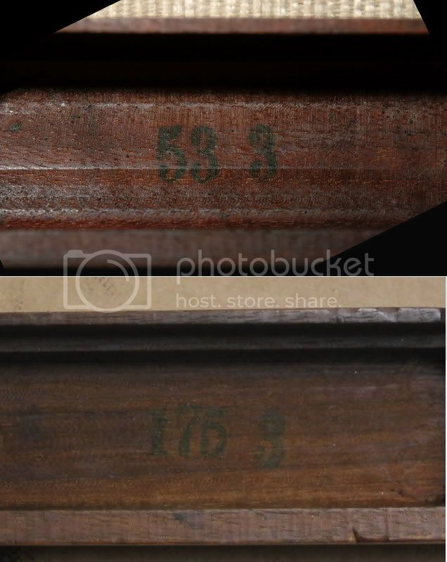

    I'm sure you're probably correct about it being a number six but on my screen, it sure looks like a number five.
    I can't tell for sure what that number is, but found pics of the stock on my 476K Inland (undated barrel) and it appears to read "147 3". Still would like to find another one with a definite 5 to see if the style matches your drawings.
    Now I'm wondering if the date codes on the stocks were stamped at the time they were finished and passed inspection, or if it was done at the time the actions were installed in them. I'm thinking it must've been when just the stock was completed, since the date code is a lower number on my 476K than the "158 3" we saw on the 426K (Gunbroker-2016) Inland.
    Another observation I've made is with the numbers stamped on top of the barrel near the receiver ring. I have (3) 6 digit Inland carbines. Maybe it's common knowledge, but I noticed those numbers increase along with the s/n's.
    408K (5)
    476K (7)
    755K (8)

    Numbers or letters have been observed on the bevel of Inland barrels dated from 6-43 to 12-43, they are random not necessarily increasing with the serial #. I have 479296 with a 6 on the bevel.
    Still looking into the buttplates have to "look it up"
    FWIW I see 125 3 on the inside of your stock, or maybe it's a 6.

    I took Bob's picture and zoomed it in and took a snapshot of it and I don't know if this will help make it any clearer, but I'm going to try posting to see if it helps. I emailed that picture to new to brass Dan (hope he doesn't mind) but I haven't heard back yet. I figured if anyone has a picture or has seen a picture of a clear number 5 in that style, it would be him.hth. would it be correct in reading the date on your 476k carbine as July 14th 43? And your 408k carbine as maybe May 12th 43?

    Dan is the man! I heard back from him and he sent me a couple pictures with a clear number five which matches your example Bob. Dan sees a five as well. Thank you to new to brass Dan for the pictures and his time.hth. are you 100% convinced it's a number five yet Bob haha?

    Are you 100% convinced it's a number five yet Bob haha?
    Well at least 99%!!! - Bob
