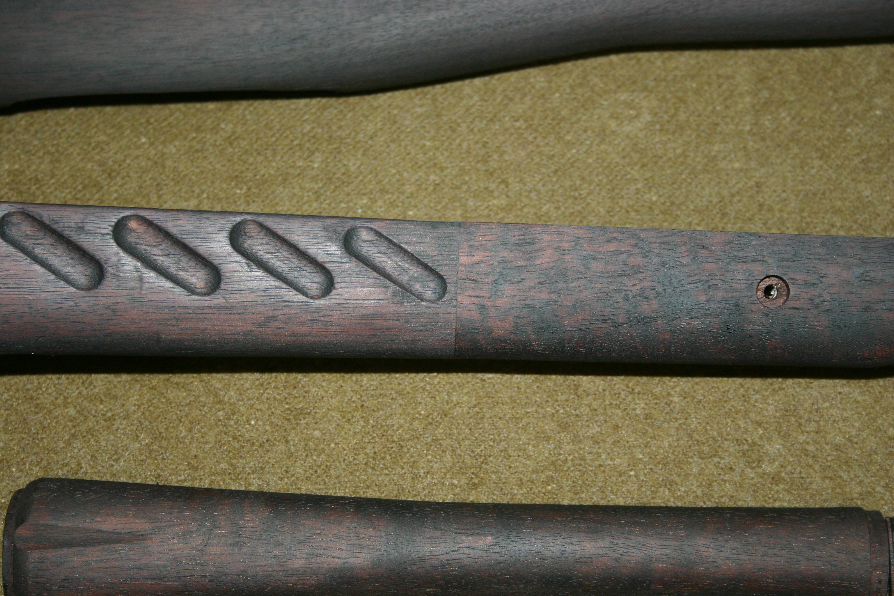

    Initial staining done.
    I was able to squeeze 6 coats of dye out of one bottle, for both the P13 and the RIC.
    Not bad.
    I now have a pretty much solid dark color to start of. (yeah i know, it looks awful atm )
    Now I'll let the dye dry thoroughly.
    Next step, lindseed oil.
    The oiling and steel wool/shading will bring back some of that light color to the top.

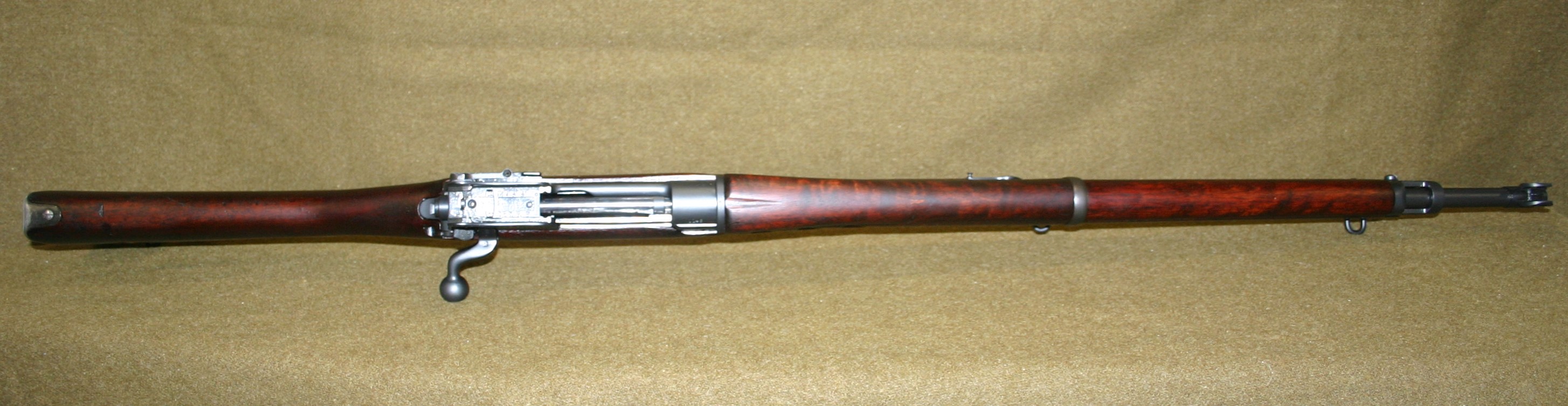

    In these pics, 5 coats of oil are now applied.
    At this stage the dye is sealed in and any excess doesn't bleed out anymore.
    It's starting to have a light shine so taking pictures with a flash isn't easy.

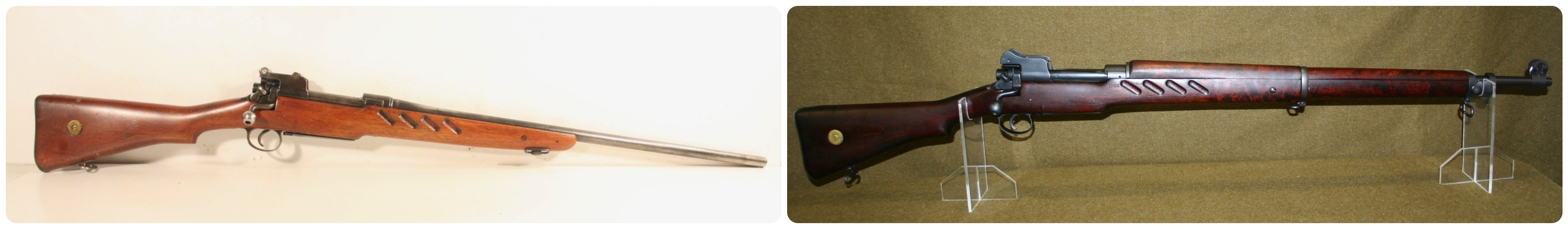

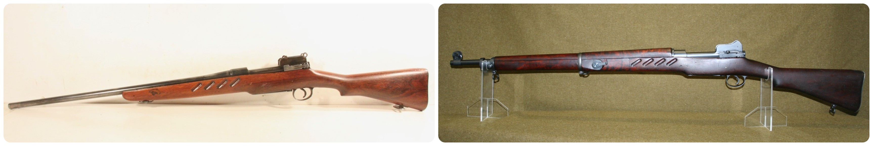

    Well i finally mustered enough will to trow together the P13.
    The wood color is not exactly what i was going for but it is what it is and for now at least i can call it done.
    I was hoping for a lighter color but due to some events i had stopped all work on it.
    It's been hanging in the basement for almost 6 months, now i can at least show a complete rifle.
    I might revisit it at a later time but for now here it is.
    (sorry for the so so pictures, i have a hard time with lighting in the basement.)
    And a couple of before and after shots.
