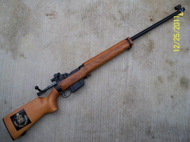

    RAF Germany L39A1 and a question
    Merry Christmas to All,
    I was digging through the safe, paused and started looking at my L39A1 more closely. It was one that apparently was used by one of the RAF units stationed in Germanyicon.

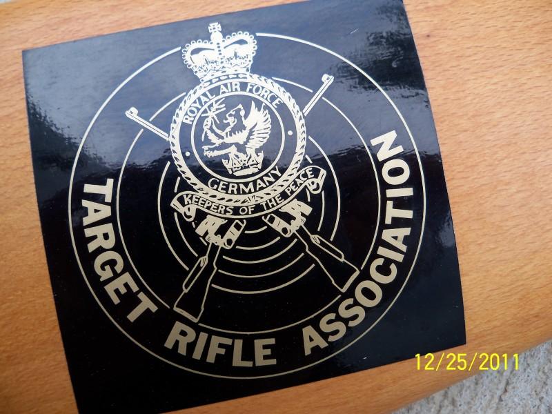

    I had forgot about the markings stamped on the forward leg of the PH5C rear mount (where the ejector screw goes). Does anyone have an idea of what "RWF 3" stands for?
    Of interest to me was that the "TARGET RIFLE ASSOCIATION" sticker used crossed L42A1's as the backdrop behind the RAF badge. Until today, I had not noticed this.
    I don't remember a discussion about it but FYI- the front sight is Alfred J Parker manufactured.
    Best Always,
    Michael

    RWF = Royal Welch Fusiliers. These target sights were purchased by the units private fund (called the PRI) and were on charge as an accountable item. So they were regularly disposed of as 'moneys worth' to other units in order to follow an auditable paper trail. Only based on my experience of these things

    Thank you for the great information Peter. It's been far too long since I bought this rifle and still haven't taken it to the range. Other duties always seemed to pop up. I just wish I could have brought some of the good Radway Green (144gr?) back with me from the UKicon. There is bound to be some squirreled away on this side of the pond.
    have a safe New Year's
    Michael
