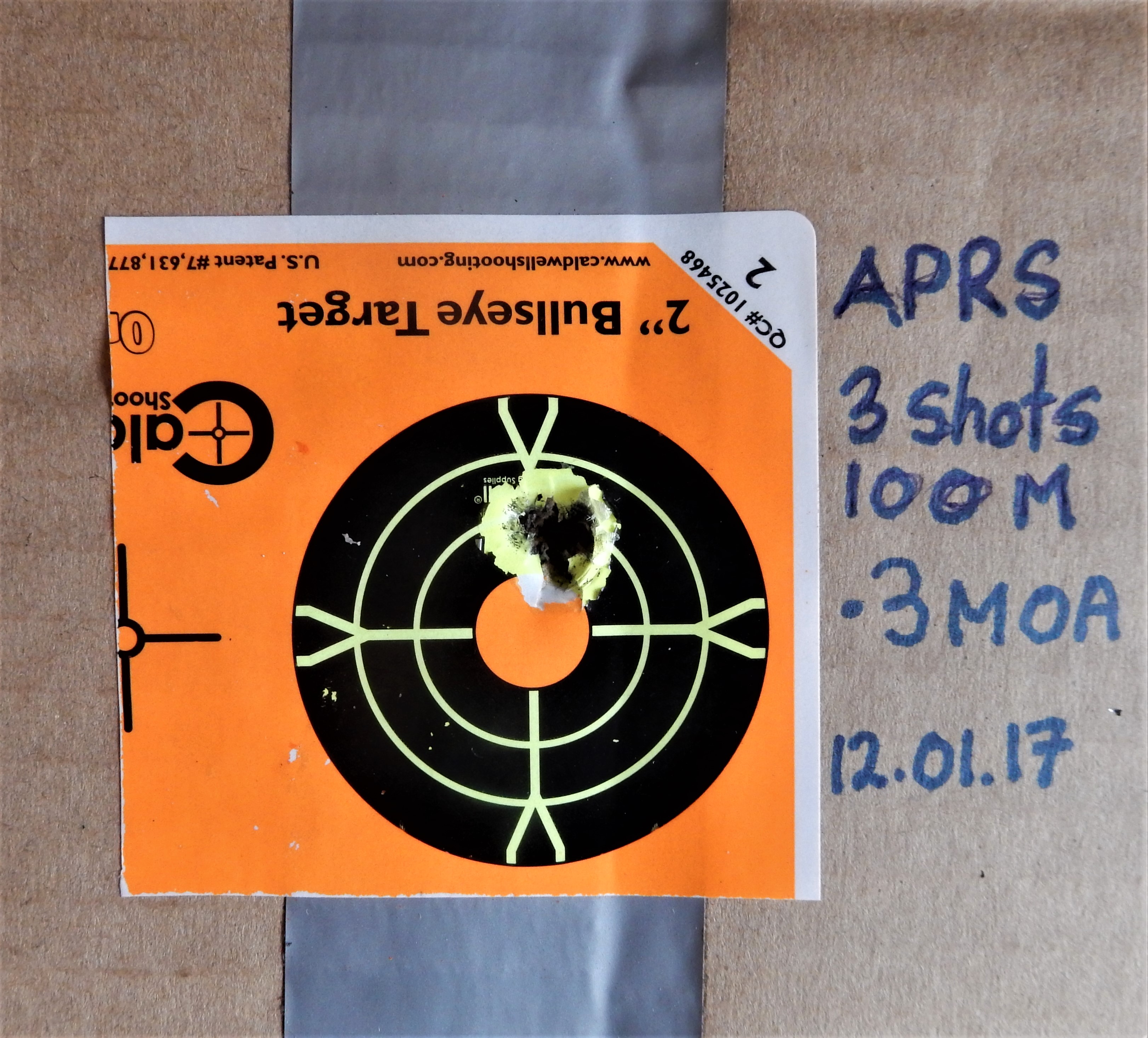

    If your not inclined to do that then get it to someone who knows the craft like Brian said they may have sat and dried out over a long period of time mine was apart from the draws malady the collar was holding the action off the bottom wood hence the rocking motion. I checked the guard trigger front screw and it was tight but that was a falsehood as it was too long and with shrinkage of the wood from drying out guess that's what induced the rocking and smashed draws.
    I was only pointing out the things that were wrong with my T and how I accidently discovered it and finding more out when I disassembled the rifle.
    As a matter of practice I'll run over the screws of my rifles occasionally its uncanny how they come loose at a critical point and when your aiming for a 1/3 of a MOA group you do not need a loose screw or dried out wood.
    Pics of a couple of 3 shot groups at 150m from my 6.5 x 284 handloads with 140 VLD Berger's & 100m from my APRS Rem 308 with 168gn A-Max reloads this is what we need from our rifles to even come close to some of the top shooters at our club, I class myself as a mediocre shot.
