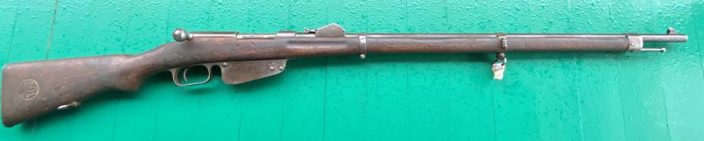

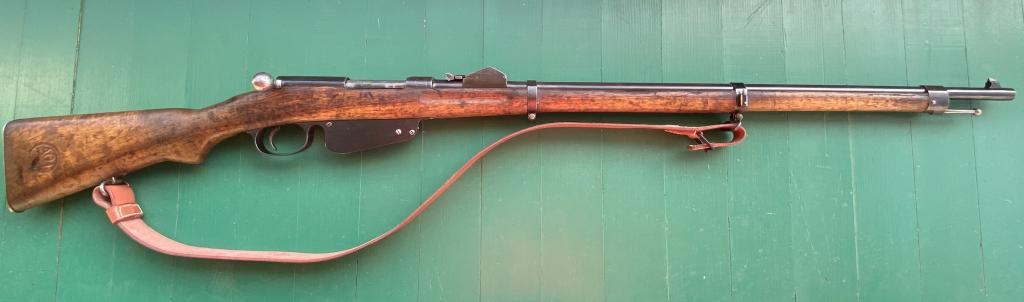

    My preferred method is spray on citristrip. I can strip a stock in an evening while I watch TV, the house smells nice like oranges and it's all in the bathtub where it's simple to clean up.
    Spray on, wait 15-20 minutes, rinse off with hot water and a scrub brush. Put a second coat on, wait 15-20 minutes repeat. Really bad ones might need a third coat.
    One can will do three or four stocks.
    I've tried the brush on type but it doesn't seem to work as well.
    Stock will be dry the next morning and ready for BLOicon.
    Austrian M1888/90 from RTI, Ethiopian, This was a three-treatment rifle. Some of the metal looks different because I replaced some of it, notably the magazine/trigger well assembly and the middle barrel band.
    Before
    https://www.milsurps.com/images/impo.../JI1oAaC-1.jpg
    After
    https://www.milsurps.com/images/impo.../Cgg4Ots-1.jpg
    I have always preferred using Citristrip also, but you are correct, the brush-on version doesn't always work. I didn't know there was a spray-on version but I will go out and find it for my next project. Thank you for the information.
    Before
    After
    VERY nice work indeed. I too have a number of RTI rifles that have restored nicely. You just have to "see" the potential. I have yet to work on my M1888/90, also from RTI! The stacking rod was missing and Ulrich sent me a replacement, but Ive yet to re-install as it is not threaded and needs to be pressed in after the nose piece has been separated form the stock. BTW, thanks for the pic! LOVE the before and after. I so often forget to take the before pic! Ive got over 80 long arms from SAWar thru the Cold War to restore. Of course Im starting with the oldest but from conflict to conflict, so the 1893 and Kragicon rifles and carbines will be first. However, before that, Ive got more than half a dozen repairs and a couple builds Im just itching to complete. It is in preparation of this work that I started this discusion.
    The one issue that still concerns me is that a surface stripping product may only go so deep into the wood. Again, I want to stress that I started this topic to challenge my own preconceptions or find a better practice. But to date, I have found soaking in kerosene for a day or two with, in some cases, occasional stirring, scrubbing from a non-abrasive bristle, and sometimes even refreshing the tank with clean kerosene, this methods seems to clean pretty deeply into the wood.
    What color is the stock after you treated it and it has dried? I always get a dull grey, but as Im sure you know, the BLOicon just brings out the natural color and grain to a remarkable degree. Still, Id like to investigate Citristrip. I also want to try Simple Green as I really love that smell as well. Both are far more eco-friendly than kerosene, but Ive got about 20 gallons left, so I need a good reason not to use it up! :-)

    I started with putting stocks on the dashboard of my truck and that worked pretty well but was a mess and took days to weeks. Then I heard about a product called K2r I think, it's a spot remover. That worked also to a lesser degree but the problem with that was it was only pulling the surface off and it would bleed through in a few days. I tried oven cleaner once, never again (but it did work) and physically scraping.
    I'm not sure who put me onto Citristrip but I've been using the spray on for maybe 10 years now. I have never had a bleed through with it so it penetrates pretty deep. Color after using? I don't exactly remember but I'm thinking a light tan to brown depending on the wood. I don't recall it ever turning anything grey.
    The greasiest stock I ever did was my first one, an MKIII Britishicon Enfield. Most lately have been fairly dry, but the IMA rifles were "wet", did three of those with it along with two RTI's.
    I bought the brush on once because I had a big map drawer case I figured would cost a fortune with the spray cans. I was not happy with it's performance but I did use it to the end. You spray it on and it foams a little, that's about the right amount. If it drips, it's on too heavy. If you can't see it foaming, it's too light.
    The spray cans can usually be found in the paint accessory section in Walmart. Usually have an orange cap, about the size of a large Raid can so bigger than a spray paint can.
