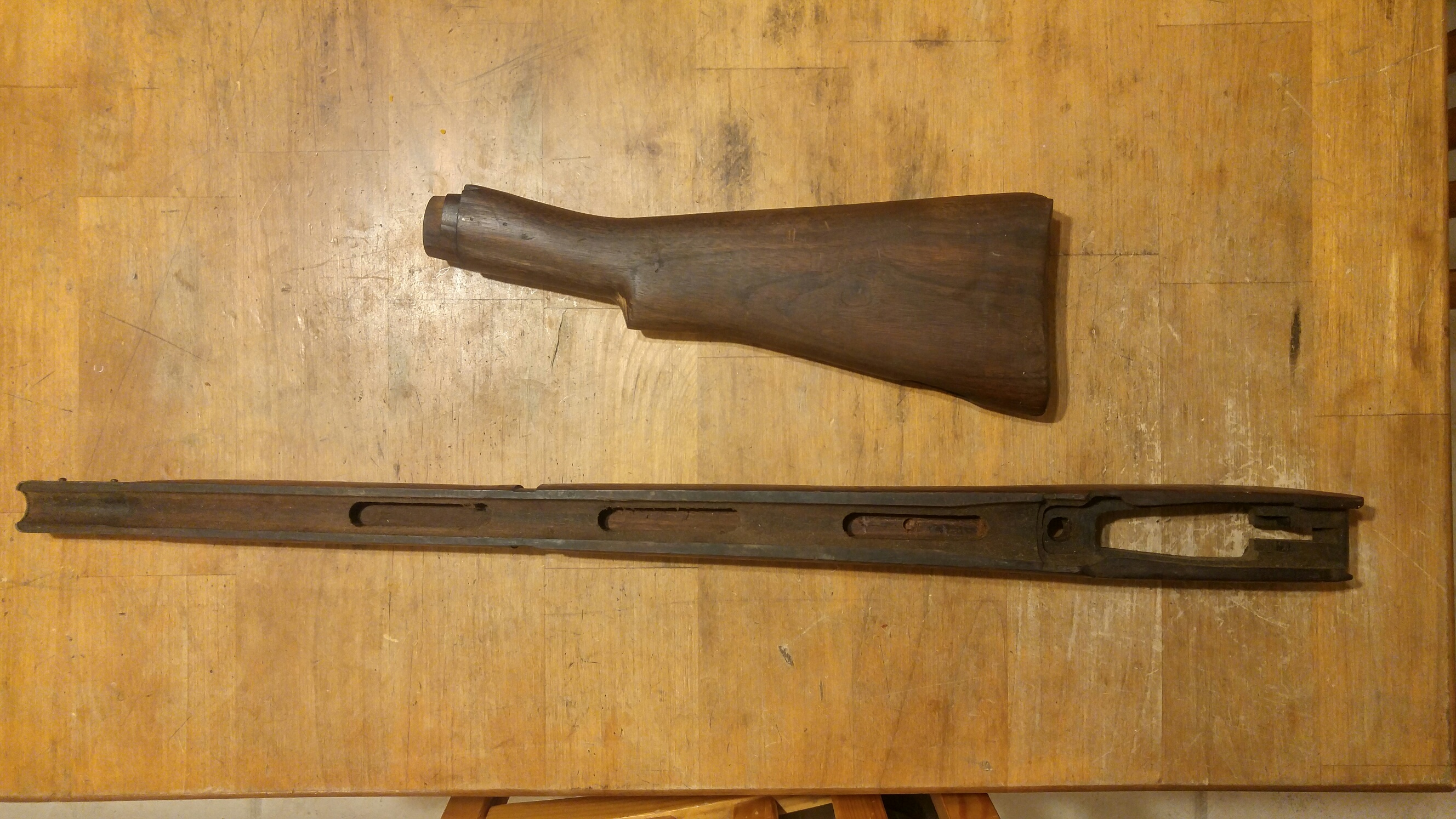

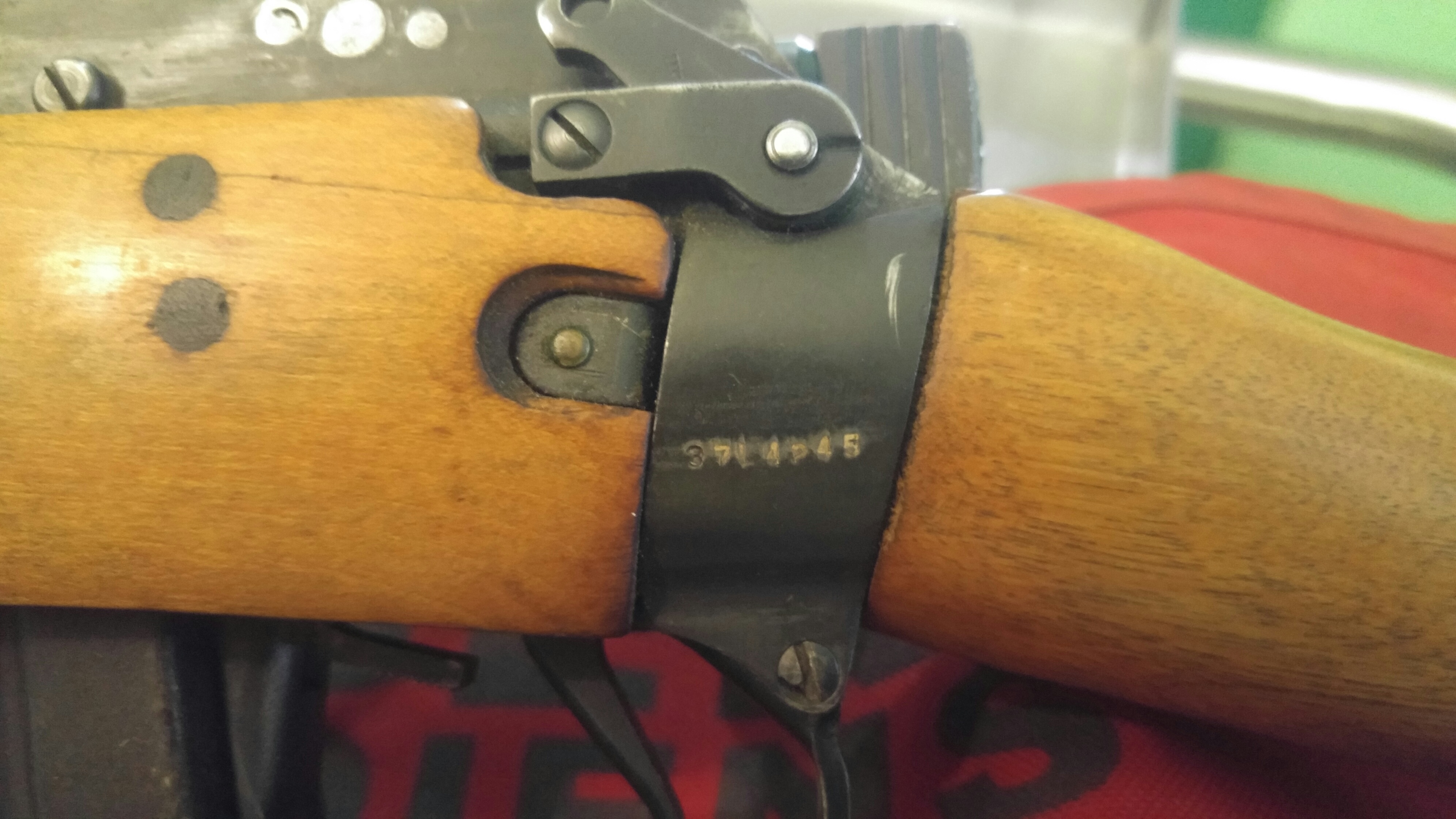

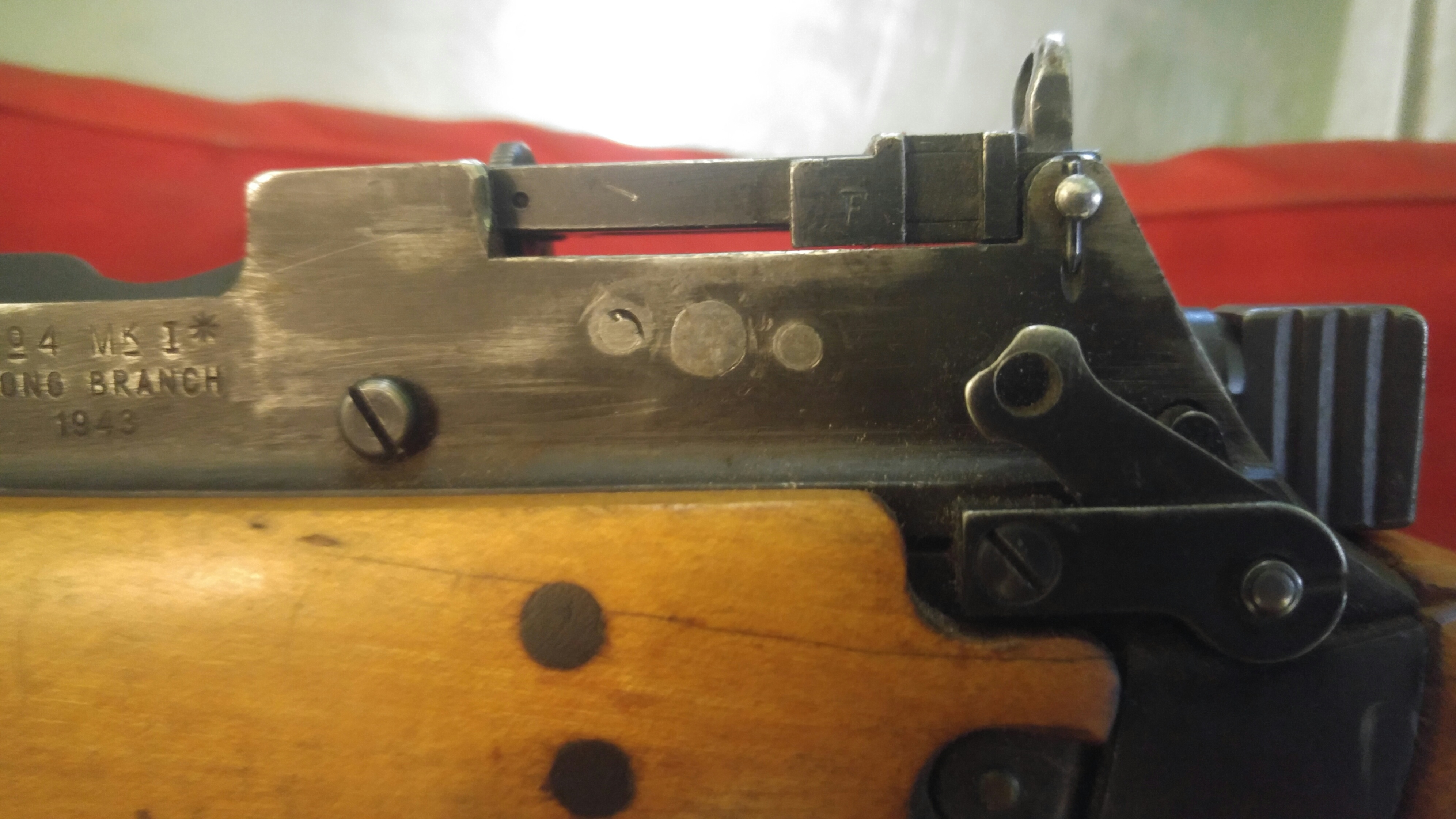

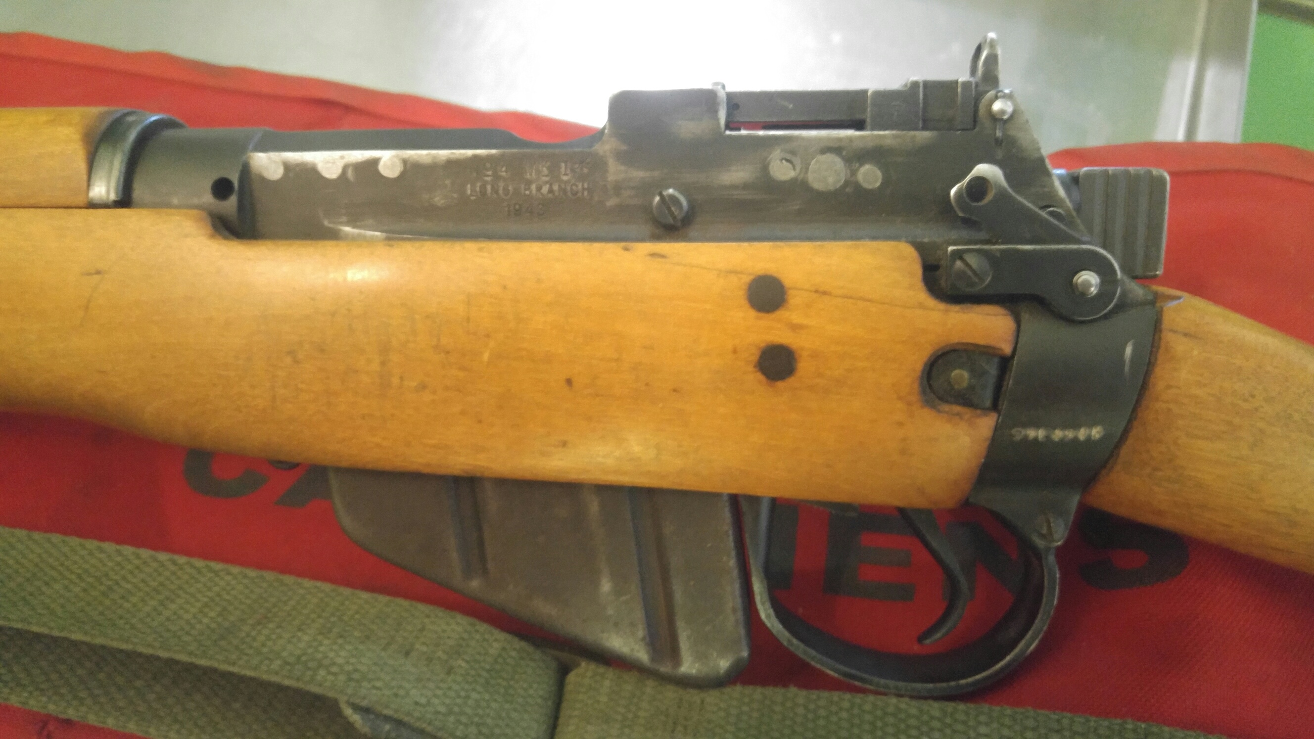

    The other day at our Canadianicon Ranger remembrance day service I discovered what "I" believe to be a very early and a very rare Long Branch sniper rifle, at least in it's current modified state.
    Every rare rifle find has a story so I'll share this one and hope you enjoy it.
    I have been a Ranger for about 14 yrs and we have one of the bigger patrols in 1CRPG (Canadian Ranger Patrol Group with number 1 being based out of Yellowknife) with about 33 active serving Rangers. Because of my keen interest in Lee Enfield's I'm always looking at the various ,No4 rifles that patrol members have been issued. Funny how this particular one had escaped my eyes over the years and thinking back I'm sure I noticed it but overlooked it as from a distance I could tell it was re-stocked and accurized and didn't appeal to the purist in me....was I in for a surprise! Most fellows have received their new C19 rifles now in our patrol and the Enfield's they were originally issued have been gifted to the vast majority. On special occasions such as Remembrance day services the honor guard at the ceremony will still use their "ex issued, now gifted, Enfield".
    Anyhow I spotted this rifle and took some photos of it. One can see at first glace (if you have any knowledge of Enfield snipers) and see why this particular rifle caught my eye. Where the scope pads were once mounted all the tell tale signs were still very evident! This particular rifle has been in our patrol for many years. The father of the current serving Ranger was originally issued this rifle many years ago when he served in the same Ranger patrol group.

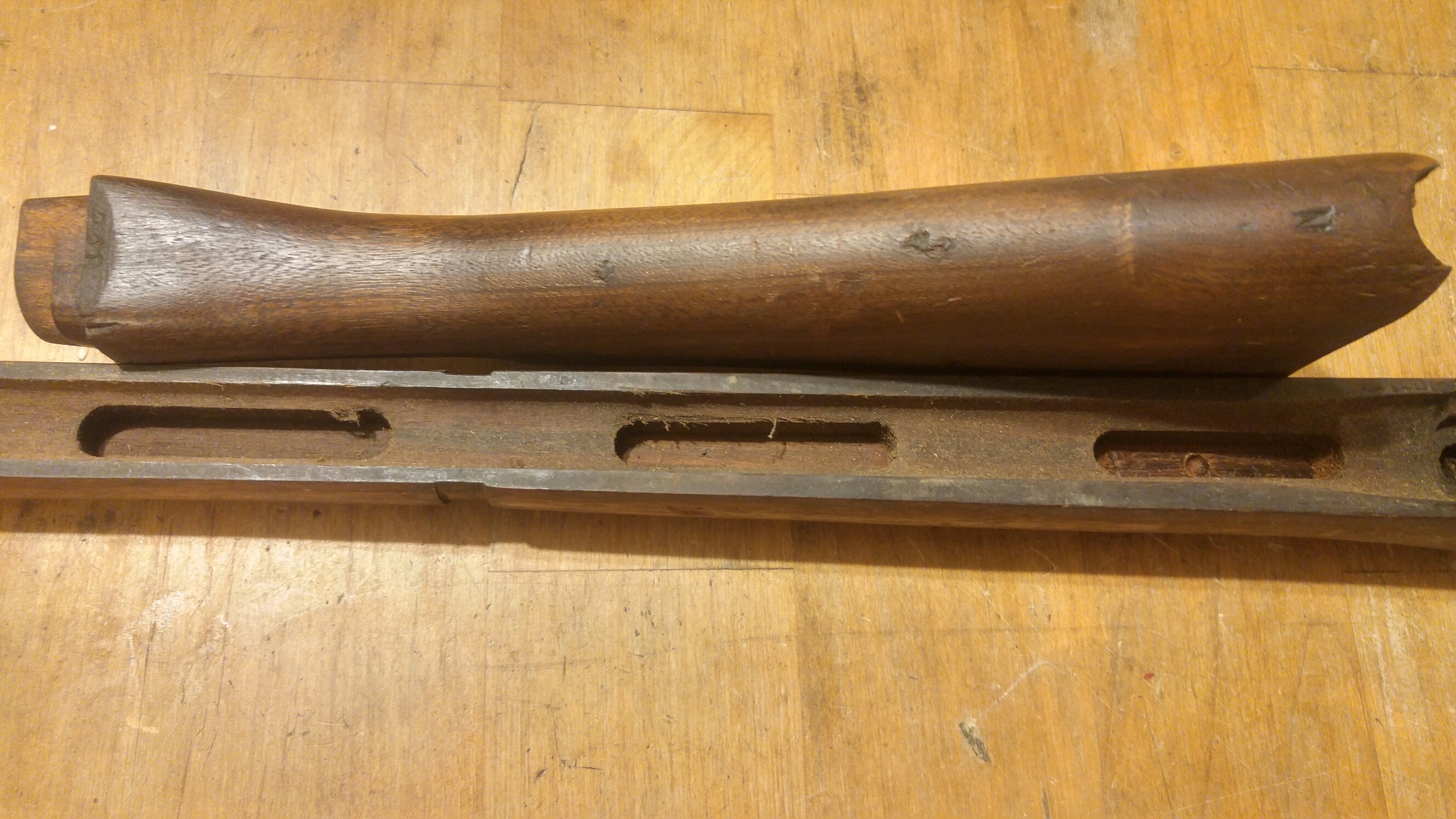

    I had been talking to the father a few weeks ago and he told me that he had an extra fore stock, top handguard and a butt stock that were surplus to his needs and he wanted to give them to me. Ironically his son had them in the truck yesterday and handed them over to me just moments after I had finished photographing his rifle and told me that his father had told him that this was the original wood taken off his rifle before it got the new birch stock, doweled and accurized etc. When I got home I looked over the wooden furniture parts and that even further substantiated my claim that this indeed was a early, rare, 1943 37L series Long Branch sniper. The first thing I noticed was the top of the butt had the scope number stamped in. I can't for the life of me read the first digit but it seems like it's possibly a 0??? What is legible is the next two stamps which are 4-C. Next I noticed that the butt had all the signs of once having a cheekpiece installed, the screw holes were filled and (I tried hard to capture it in the photo) but in the flesh one can see much better the difference how the wood aged and the difference in darkness where the cheekpiece covered that area for years.

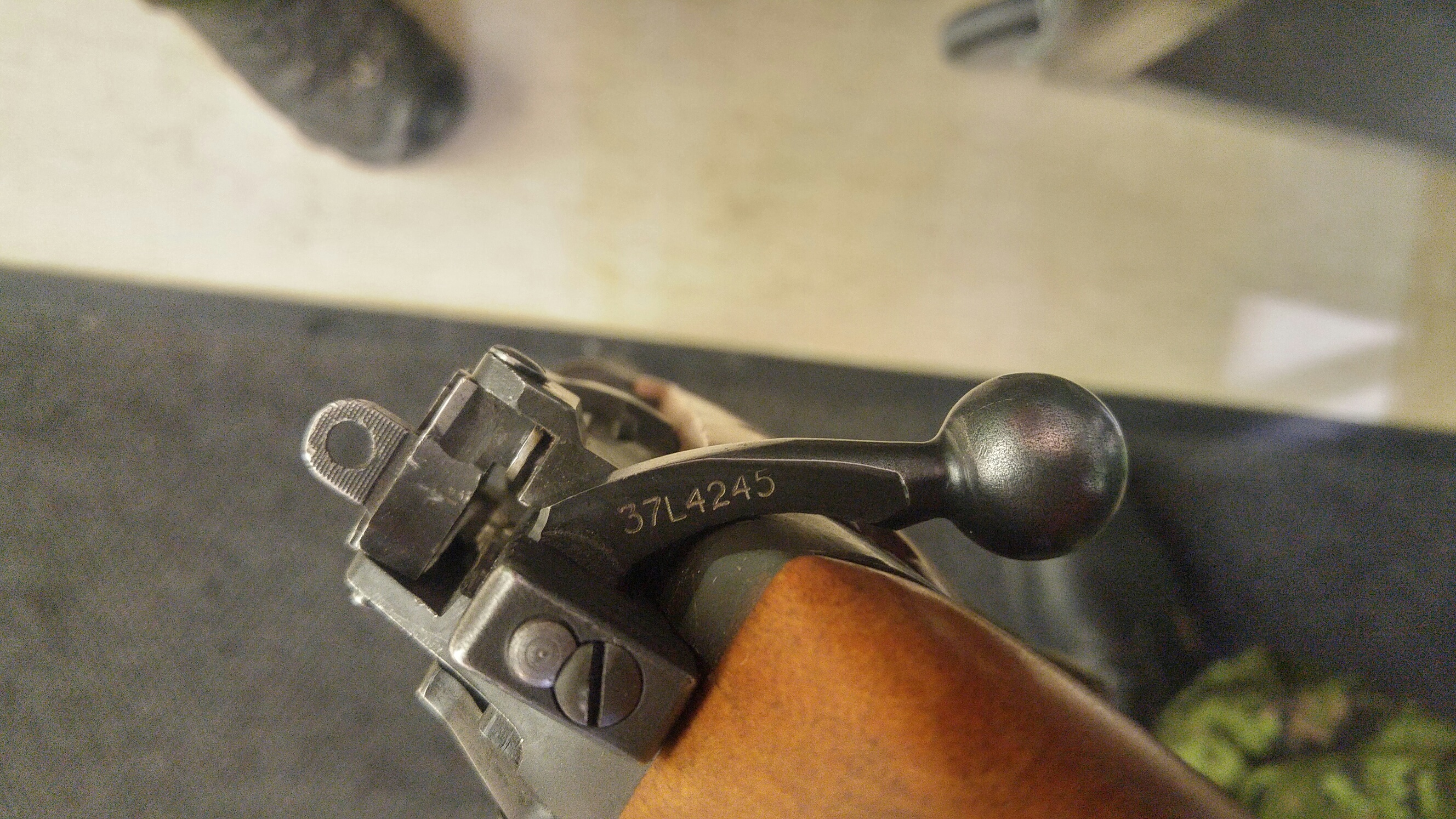

    The serial number on the bolt is really puzzling to me. This obviously is not original but it reminds me exactly of the type of stenciling found on the late Fazakerly made No4MK2 rifles. I have also seen something similar on FTR'ed rifles that had bolts matched in service. I know the particular father/son that were issued this rifle would not have had the bolt numbered, I doubt that would have meant that much to them, far less for sure than just having an accurate Lee Enfield. The possible answer is that in our region there is an elderly gentleman that was previously hired by the DND as he was a former armorer. He repaired and accurized Ranger rifles upon request....he indeed may have lapped the bolt lugs and had this bolt renumbered if the original bolt was not with this rifle at the time it was accurized......I will investigate this further!
    I doubt this rifle will be for sale and I would trade, give cash or whatever it would take but I think it will be staying with the rightful owner as I'm sure there is sentiment attached as his Father carried the rifle for years. At the very least I will do is I will be encouraging him to put this rifle back in it's original sniper state, however expensive that should be! One thing for certain is if it's done by the best (and I know who I would send it too and who I would not) the value will not be lost and I will be emphasizing that point!
    Enjoy the photos (hopefully Jim posts them) your thoughts are appreciated!

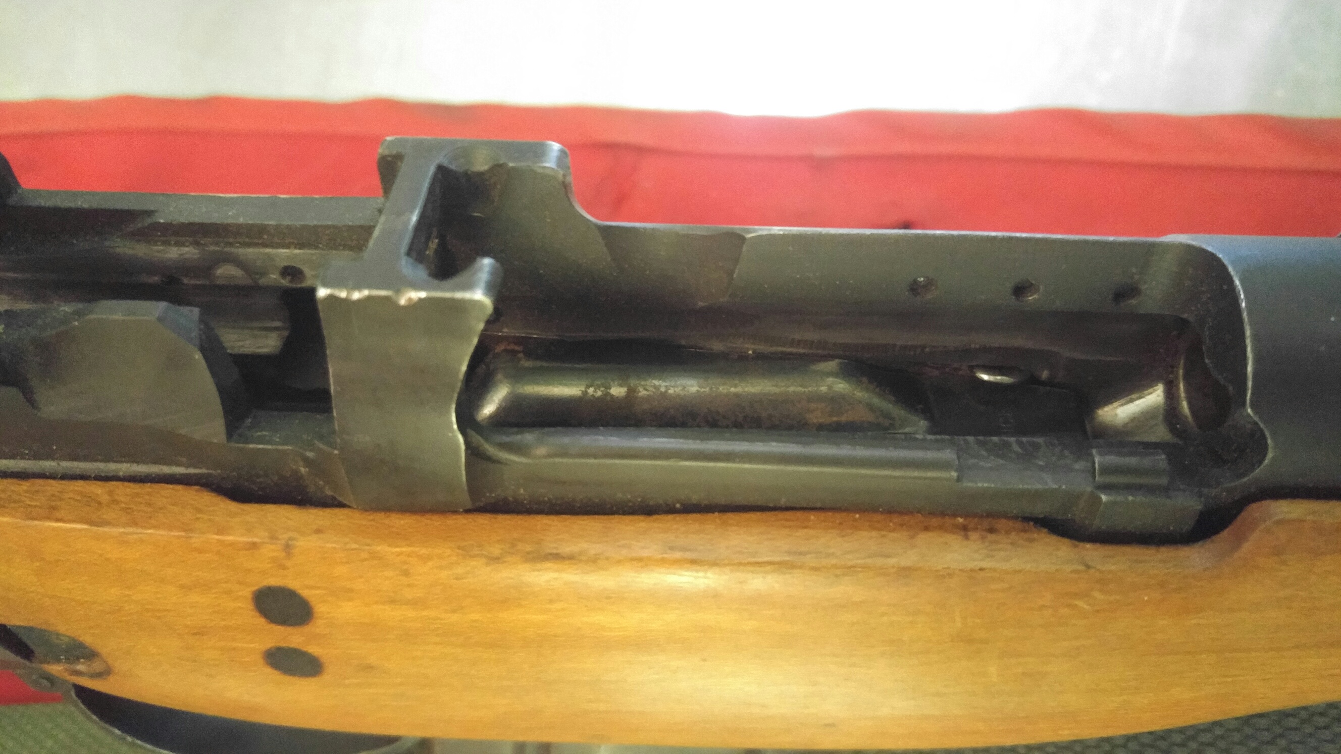

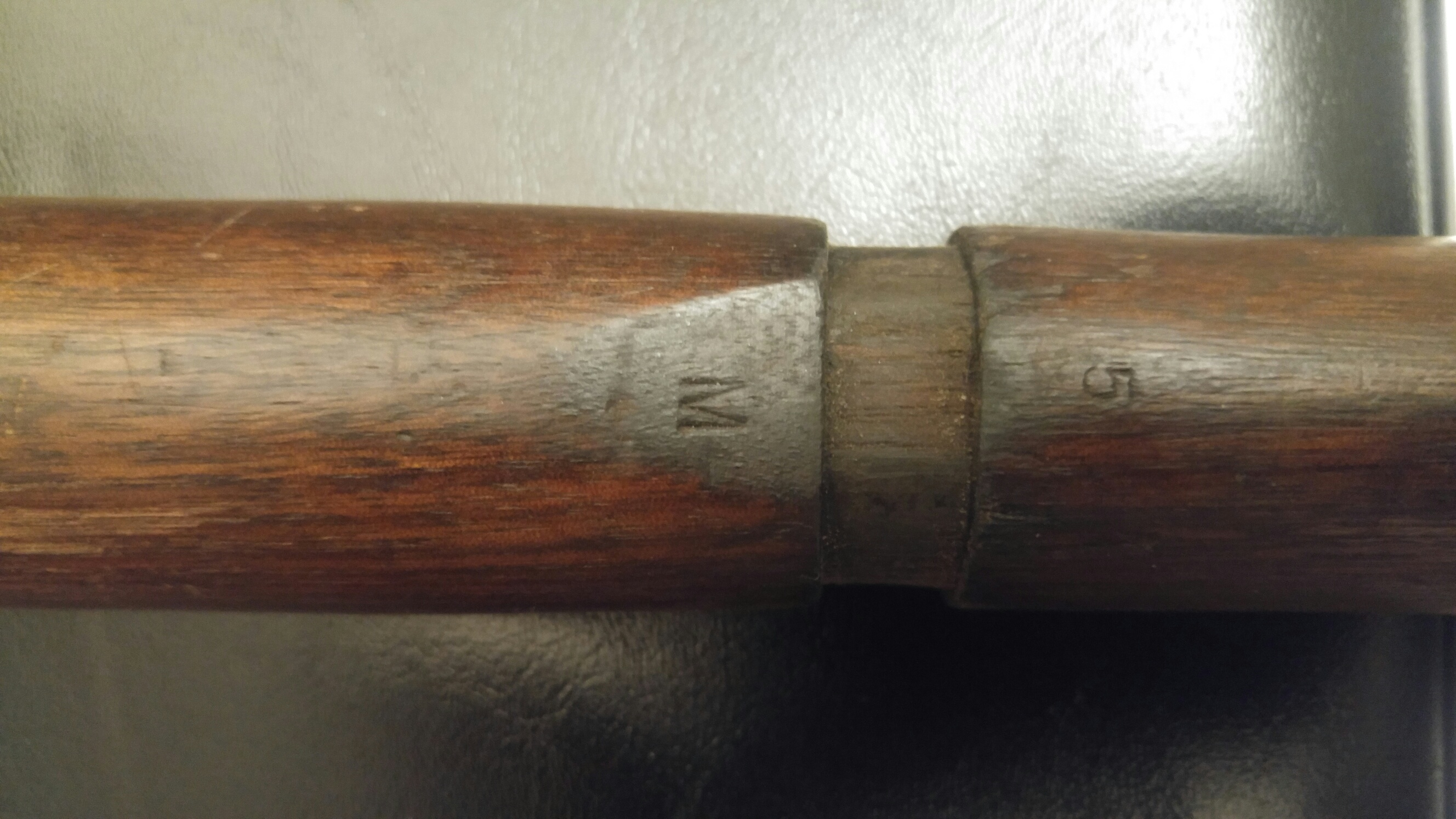

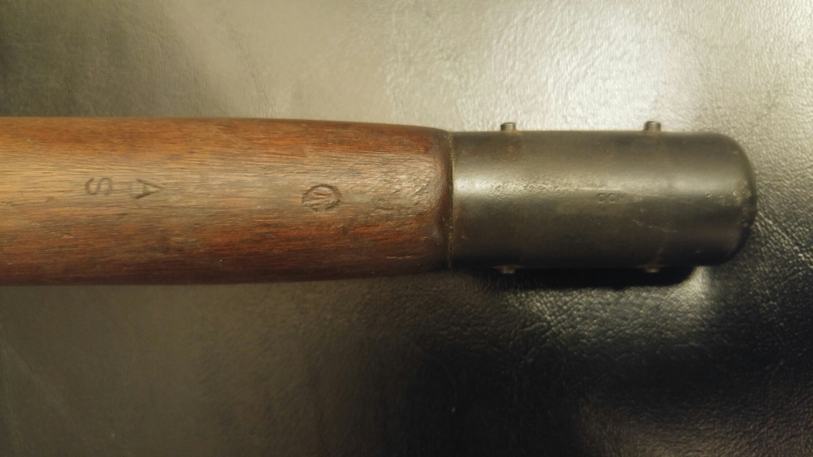

    Here are the pics he speaks of. Yes, it sure looks like a modified "T" to me. The Ranges did that as things wore on, they used up every #4 rifle they could get either for parts or as a whole.

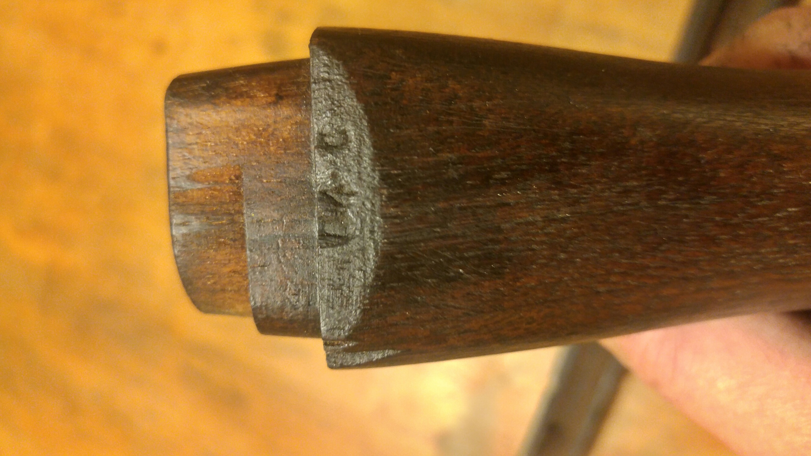

    good find, it appears to be real - and the provinance is probably as close to the best we could find.
    I don't like the "scope" number on the butt stock though - 79 years is a long time though.
    I have a number of 36L and 38L rifles on my list. This is the first 37L
    I would measure the hole spacing from the rea thumb screw hole to the centre front hole.

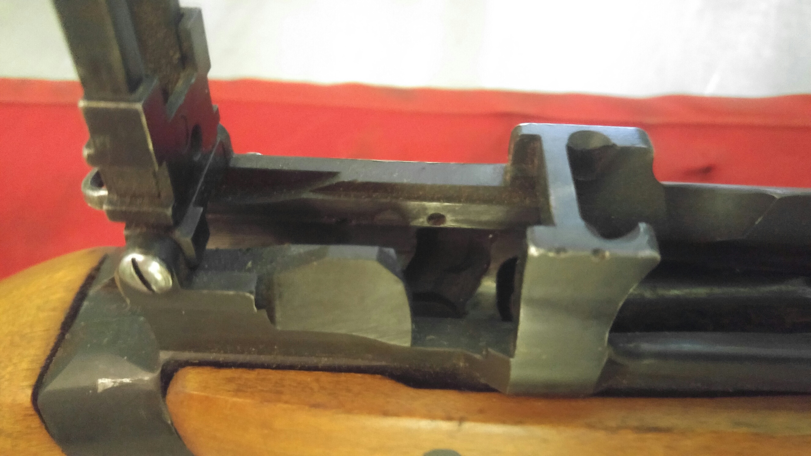

    It is consistent with the early LB snipers assembled in Canadaicon
    Canada DID NOT solder the pads on the No.32 mount set up and this caused a real sh*t storm with the British.
    Apparently the screws were loosening as well as shearing off and the Brits were NOT HAPPY!!!
    I have some of the correspondence on this faux pas and it was much later when Canada finally complied.
    I am thinking late 43/early 44. I do stand corrected as just a guess until I drag out the records.
    Most of the 32 TP set ups were also not soldered but they had the addition of the hardened steel dowel pins.
    I THINK I have the letter stating the compliance date by Canada to solder on the pads and will look for it shortly.
    The earliest LB mount I have with a number on it is 36LXXXX
    If any early LB pads are soldered, they were done in Englandicon and NOT Canada.
    PETE: Please check the rear sight and see if it is British or Canadian.
    I supplied a couple of dozen Mk.1 sights to that region many years ago as most of the Mk.3 sights had the stamped eye piece broken off.

    I spoke with the owner tonight, more less he said, "it had one of those slider sights and when I was at a gun show in Edmonton I purchased a vernier sight". Nothing relevant about it but the sight is a MK1 British Fazakerly.
    So yes it had a MK3 sight put on.
    ---------- Post added at 09:10 PM ---------- Previous post was at 09:05 PM ----------
    THANK YOU JIM FOR POSTING MY PICS!!!!!!!!!!

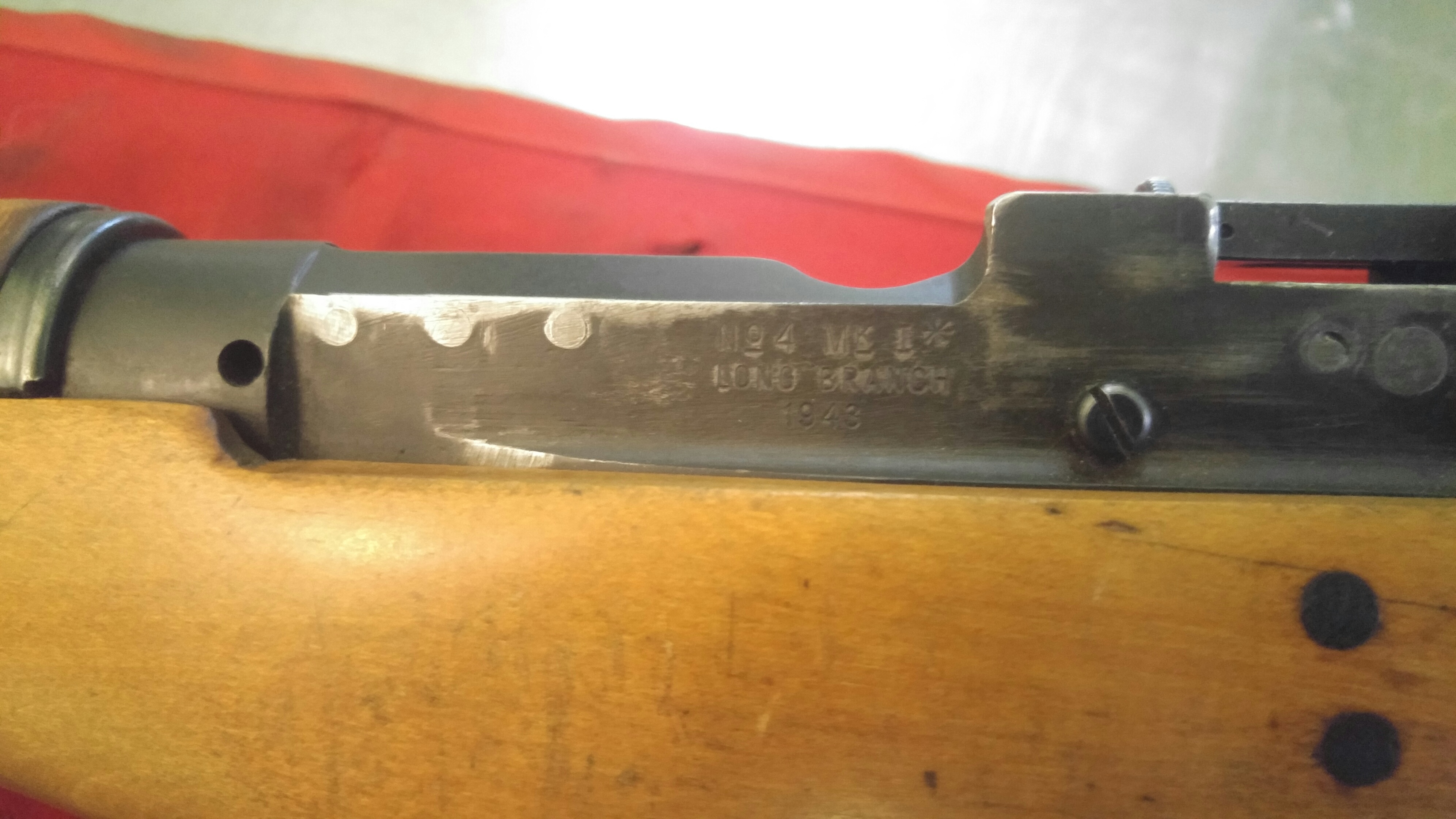

    I was able to examine the rifle closely tonight. Rifle still has it's '43 dated barrel.
    No England stamp on the breech.

    Quote Originally Posted by Lee Enfield View Post
    Well the scope number stamping is better than it would look as if it were done yesterday! LOL
    But yes it would be nice to know the number, but for the life of me I can't read the first digit!
    I measured as you requested with a Mitutoyo vernier.....center to center is roughly 3.600".......I had a Savage handy to compare and checked it, basically the same!

    Yes, it's a real find. And also nice that the original wood (or most of it) still exists. I used to own a 39L not too far away in serial number.

    The earliest I have in my database is 36L502X.
    Joe Salter sold a "reproduction" a few years ago 36L1352.
    Mine is 50L0026. The L-42 that sold a few years back is 50L0027.
