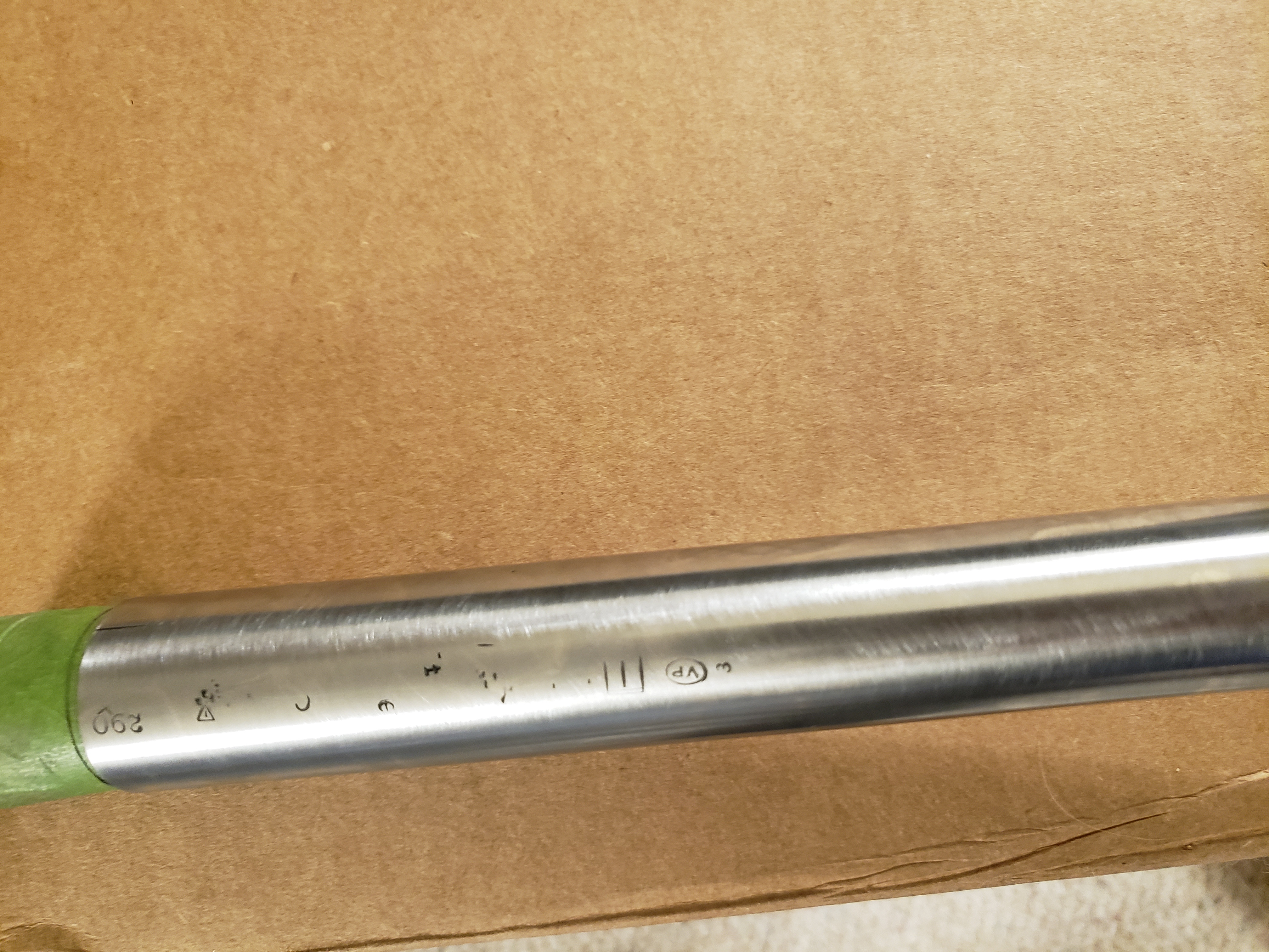

    rust and most of the pitting gone. All that's left are some deep nicks. There was only one little spot around the dent, no bigger than 1/8" across, that indicated where the dent was. I'll swage one more time after polishing the bore this week with a flex-hone, and triple checking the final size.
