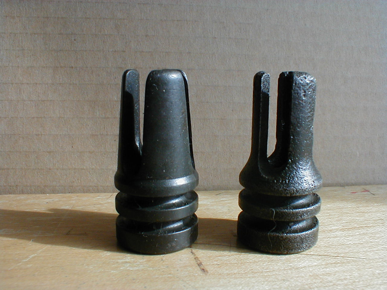

    JFK's AR-15 rifles
    Note the early duckbill shaped flash suppressor in the JFK photo, difficult to notice if the plastic is green color, duckbill lasted into the Colt 601

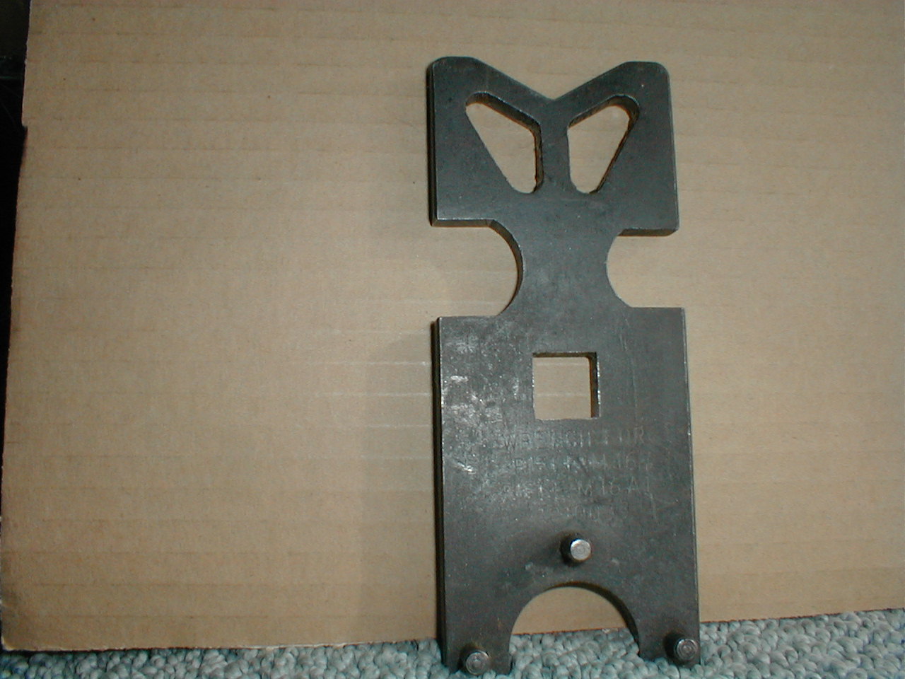

    Note the early duckbill shaped flash suppressor in the JFK photo, difficult to notice if the plastic is green color, duckbill lasted into the Colt 601Attachment 129051Attachment 129052
    Helpful to break the wire around bales of C-rations.
