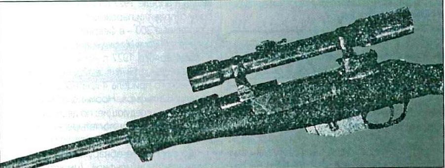

    Perhaps the Red Army was experimenting at that point and decided to use a non-standard rifle for the same sort of reasons that the Britishicon chose to use Springfields for a comparative test of certain scope mounts: apparently it was felt that choosing a totally unfamiliar rifle would focus the user's attention on the components that were to be compared.
    Or perhaps it was just an economy measure, or possibly they recognized the superior accuracy of the Ross - and perhaps the speed of loading - and decided that since it was a limited run, they might as well use the best they could get?
    Have you seen any reference to rifles being supplied to the Whites with scopes fitted? I never have and what's in the movie is just in a movie. Sort of like the Ross .280 takedown that Clint Eastwood handles in "Joe Kidd" (scope on backwards etc.)
    If there was any intention to supply the Whites with such rifles by spring of 1919 there were about 8000 scoped SMLE's sitting in store at Weedon or Enfield that could have been sent, and since so many SMLE's were sent it would have made sense to send the same rifle, despite its many flaws as a sniping rifle. Particularly since the rifles were going to be broken up for spares anyway, though off-hand I don't recall when that decision was made.
    1926 is pretty early for a scope acquisition by the Soviets; within a few years of their cooperation with the Reichswehr beginning.
    I see Gen. Morozoff/Morozov was speaking to the N.Y. Times in 1942. I suggest he was being both polite and deceptive: implying the Soviets were just learning and new to all this etc. etc.!

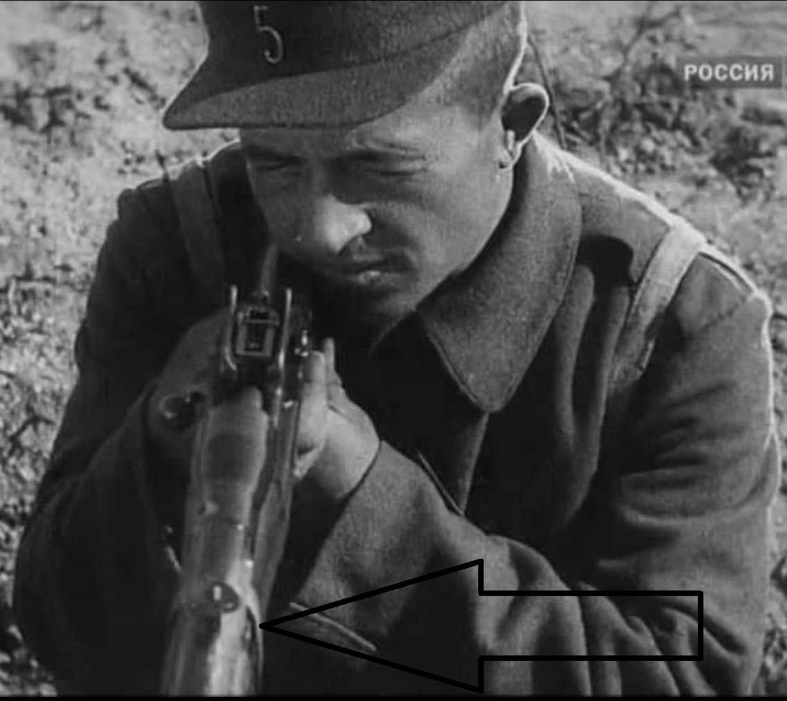

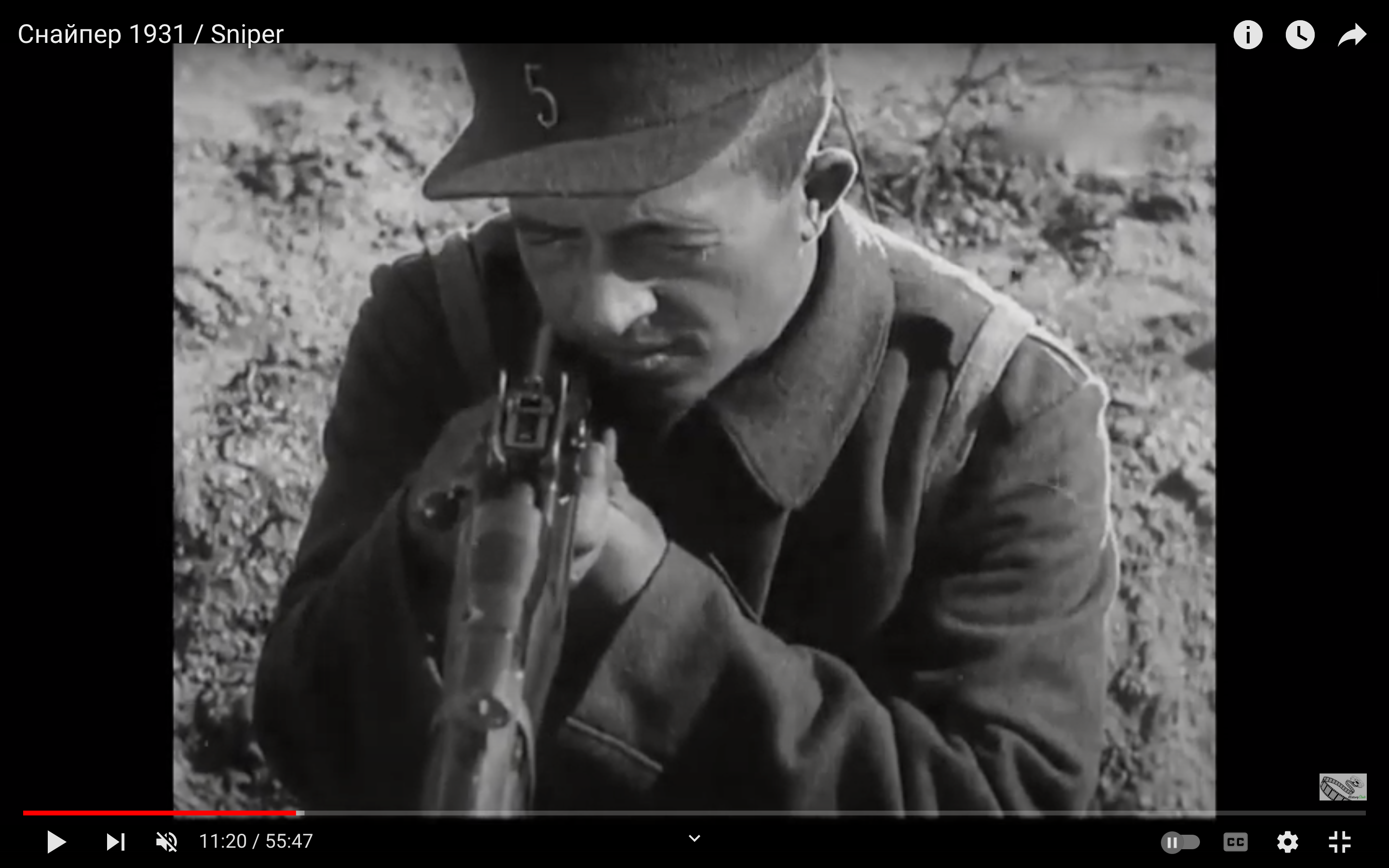

    There is one scene in that film that puzzles me. Check out the P14 at 11:20. Scope seems offset and what is that band behind the distance dial? Prop? Your thoughts please?
Name:	Screen Shot 2022-12-12 at 10.36.07 PM.png‎

    Upon further reflection, those Ross sniper rifles may have been either captured or abandoned when the Canadians withdrew from the Polar Bear Expedition in Siberia. I don't know enough about Canadianicon involvement but do know that the US forces there did fight the Reds.

    As for the P14 in the movie it appears the scope is a long eye-relief model set forward of the boltway perhaps to address the perpetual problem of loading the magazine with a scope in the way, but looking more closely it is probably just something made up for the movie to contrast with what the hero using. Straps have never worked well as a method of holding scopes onto rifles!
    One of the few advantages of the Winchester A5 was that it could be slid forward in the mounts to allow the Ross to be clip loaded.

Name:	Ross MkIII Soviet Zeiss Zeilvier.jpg‎
ID:	129135   Click image for larger version
    I agree that P14 used in the movie was a real prop gun. That band/strap on the stock doesn't exist on the normal P-14. Also the range knob is canted, suggesting that the scope is offset. IMO, it was Mikhail-Mouse installation built by a prop maker. For props, they would have been better off making wood mounting blocks and gluing it onto the receiver but the Soviet viewer is unlikely to have known enough back then to discern the difference.
    We need a foreign scope expert to ID that scope or at least verify that a long eye relief scope of that type was available in 1931. I bet it wasn't a long eye relief scope though and if it was, it was the prototype to Jeff Cooper's Scout Rifle concept.

    Regardless, there are two questions: were the Soviets considering using the Ross officially as a sniper’s rifle in any capacity, and if they were, was it in the Red Army or only the MVD internal security forces (which were under NKVD control) The MVD constituted an elite force that AFAIK was never deployed in front line combat operations; they were the Praetorian Guard of the regime in a sense. Their needs in terms of quantities would be much smaller than the Red Army’s, and like most elite formations, their options in terms of equipment were probably wider.
    I expect the Ross would have been of much more interest than the P14 for sniping purposes if only because the turn-bolt of the P14 made it no better than the M-N from a functional point of view, though the rifle’s stock design and iron sights were far superior to the M-N. (And the stock superior to the Ross as well)
    But, it could well be that for the Soviets the Ross was simply a convenient and highly accurate “test-bed” on which to evaluate and develop their scope and mount designs; witness the grainy illustration which appears to show an early side rail mount, but with a Zeiss Zeilvier instead of a PE series scope. That would tend to suggest work done before the PE scopes were available, but the mount is not one imported from Germanyicon, though it could be said to be inspired by German designs.
    Apparently the Rosses didn’t all go in the smelters or to the front during WWII, even though old junk like Berdan rifles did in late 1941. And as we all recall Rosses showed up again as the Soviet running deer rifles in the 1956 Olympics, so they certainly weren’t entirely forgotten either.
    As it’s only a movie, the actor doesn’t even need to be able to see through it, much less get a proper field of view.
    I just fast forwarded thru that movie.
    The P14 and Ross MkIII sniper rifles are great.
    I believe the apparent off set of the P14 may be an optical illusion.
    There are at least 2 Ross MkIII snipers used (1 with fore stock cut at mid band, several full length stocks).
    What I noticed were several shots of non-sniper Ross Mk3B rifles.
    I attempted to see the front sights on the "optically sighted" Ross rifles to ascertain whether they were Canadian or Britishicon contract rifles, but all the scenes were too quick or cut off .
    What was amazing was that the machine gun used was the (little known & extremely rare today) Maxim-Tokarev M1925 Light Machine Gun Maxim-Tokarev M1925 Light Machine Gun - Axis History Forum
    Can’t say I’ve ever seen the bolt of the M-N as “simple” compared to the Lee Enfield or P14!
    I seriously doubt if any consideration was given to the Ross rifle. While its straight pull bolt was easy to operate, that it jammed made it less reliable. As for the P14 rifle, why bother even considering it? Retooling, manufacture of jigs, training of workforce all mitigate against a new foreign design instead of the M91/30.
    The PE scope was not available when Sniper was filmed in 1931. Even if the PE scope was developed earlier and in time for the film, I question whether the Soviets would allow new technology to make a screen debut. State secret? Finally regarding the movie, you do raise a valid question as to the film's distribution outside of the Soviet Union. Are you aware of any other WW I or interwar movie about snipers; especially those in the West?
    As to simplicity of the M91/30 bolt to the P14, just look at the number of parts and ability of the soldier to disassemble it. I've disassembled the K98icon and 03 bolt but never tried a Lee-Enfield (lemme check the manuals).
