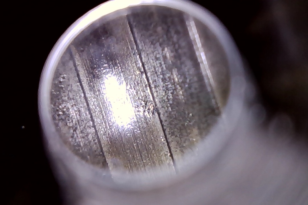

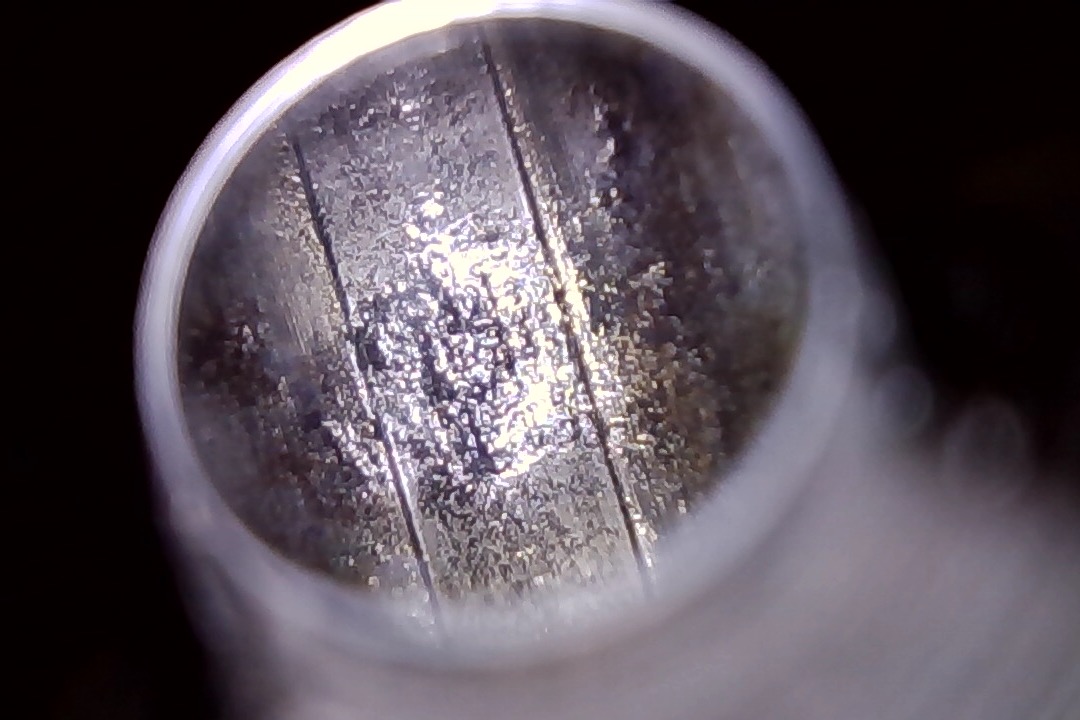

    Finally followed ssgross' advice on the Teslong USB Borescope (THANKS!) and now have a new toy to play with. Dead easy to set up and use on a MacBook Pro. The one at SSG's link is specifically USB and the manual says it works with Win XP/Vista/7/10 and Android, but I have no experience with them. Teslong sells other borescope versions for iPhones and other smartphones.
    Took these pics after thorough cleaning with Patch-Out/Accelerator and boiling water. The barrel gauges perfectly with the bore gauges.
    I have no experience with borescopes, so can anybody tell me what they see in these photos of my No. 4 Mk. 2? To me it looks like considerable pitting. The local "experts'" guesstimates are all over the place so once again I'm back to you Subject Matter Experts.

    You have a little pitting some carbon and a wiff of copper. JB or ISSO paste, mild scrub a good clean out with a carby or brake cleaner to remove all the paste, a light oil and you are good to go.
    Keep on top of the carbon you now have the tool to do so.

    doesn't look too bad. Be careful with your new toy. It will try to play tricks on you. Try taking the side mirror off - makes even a brand new mirror bright bore look pretty dull and crappy. It's just the angle though. birds-eye will show even the smallest amount of copper as a dull orange/brown (don't confuse with rust. rust shows as a dark brown). things that are hard to spot with the side mirror will jump out without it.

    Third photo is rust scale IMHO. You might want to degrease the barrel with something like oven cleaner then fill with vinegar and let stand for a day and then scrub out with a stiff wire brush.
