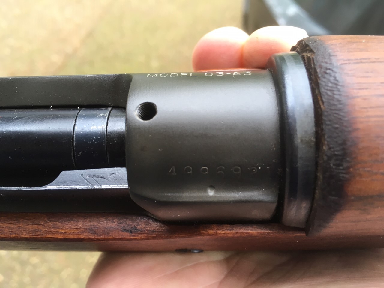

    You hold out hope that the gun you bought off GB, without actually seeing it in person, is what the seller says it is. It shouldn't have taken me this long to come to the truth, but I now have.
    This same seller has more fake A4's for sale on GB right now... says he's selling them on consignment for a local collector in Texas. Not sure I buy that... nor should I.
    Expensive lesson... and not the first.

    Yes, clearly a handjob...

    Hand engraved, and not very good either.

    But I still wonder... why is the serial number proper looking and in the correct range?

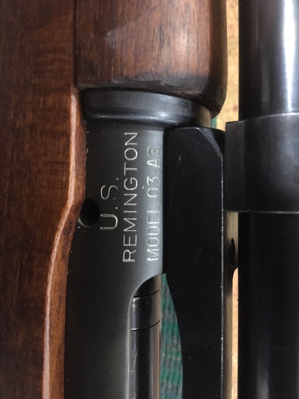

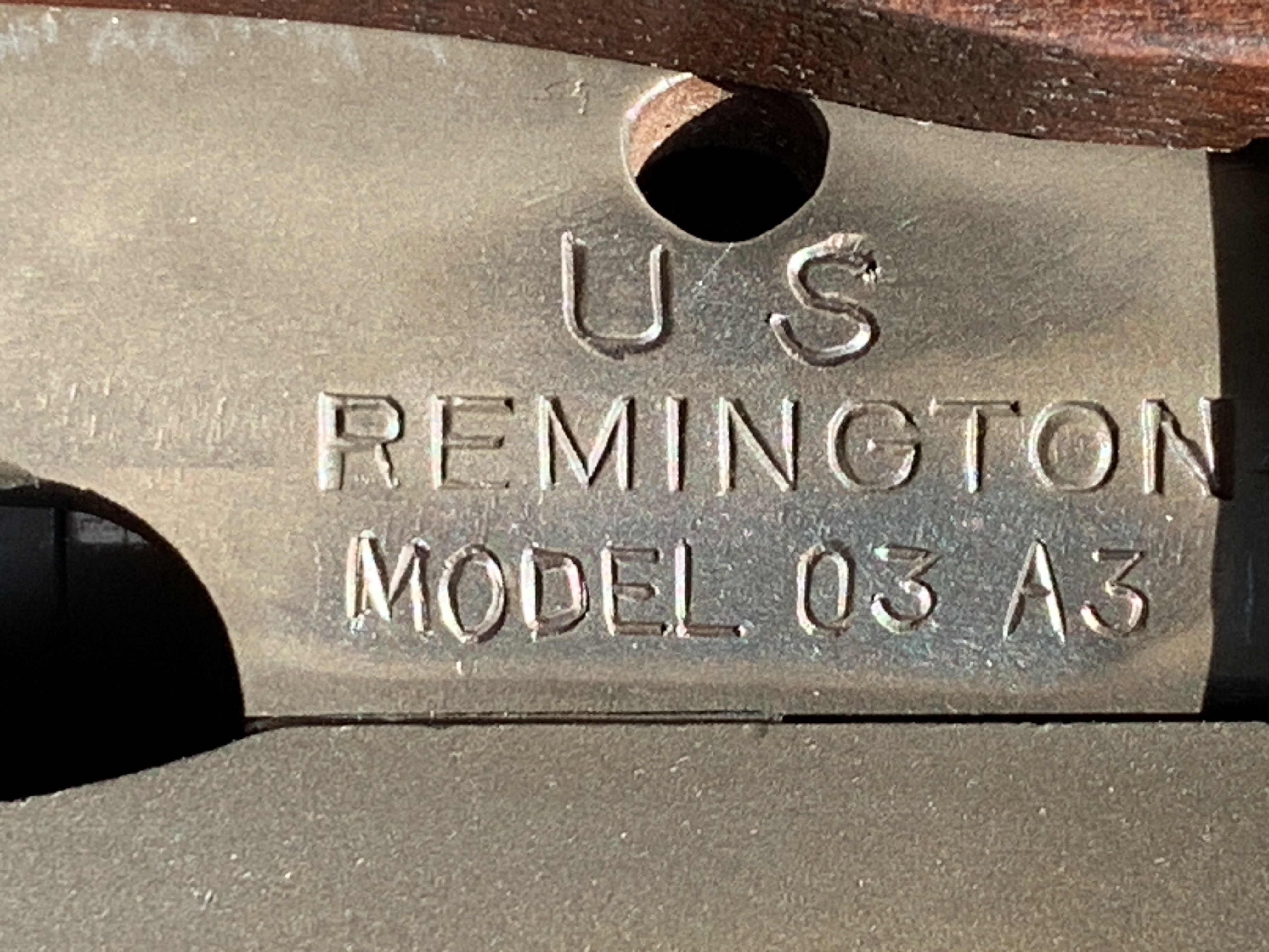

    Is there any way to tell possibly by markings like the Britishicon have as to this receiver being rejected but then reactivated after repair?
    Could it be the defect was the markings didn't strike correctly and had to be filled in by hand for this receiver to continue down the line?
    By scrutinizing the picture the US looks overstruck at the top and had it possibly moved while being struck? The Remington looks proper enough except much lighter at the bottom than the top especially at the R and E. Even the I is very angular. It's possible the Model 03-A3 hardly struck in that instance and had to be followed up by hand. Round surfaces can be a real pain to work with when all involved is not perfect.
    No way of knowing for sure this is just a supposition on my part.

    Is it certain this is not a Federal Ordnance receiver that had the commercial maker markings removed and bogus markings added?
