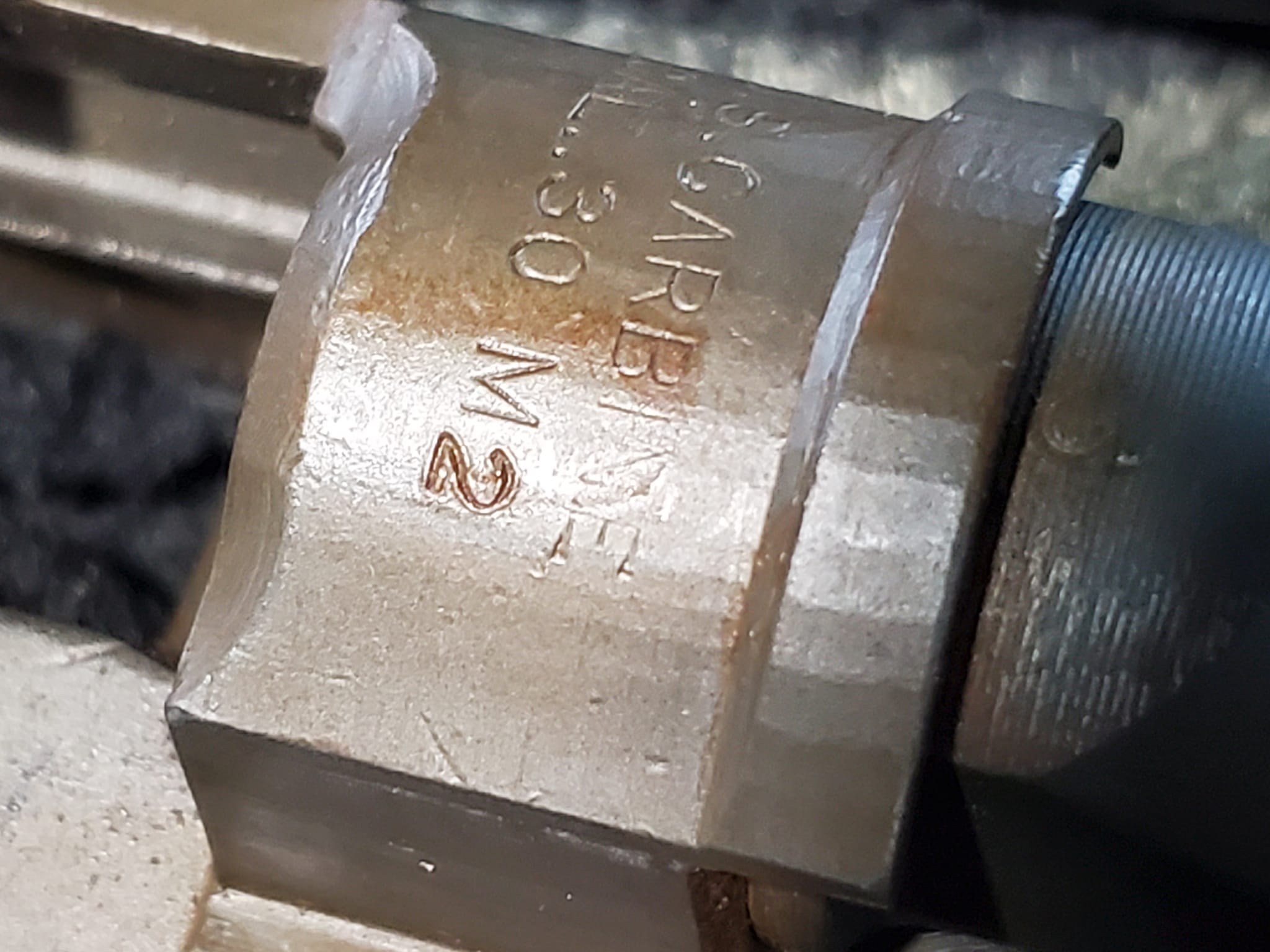

    I need to invest in me a copy of war baby 3. They are pricey but it seems to contain a lot of information not easily found anywhere else. Since you know the provenance, I would trust what I had in hand also. Does your Winchester have the M2 marking on the receiver ring? That's what Eddie, the OP originally wanted to see and me also haha was a picture of a Winchester M2 stamped carbine. The selector lever just being marked with an A and nothing else,may be an instance of where the first selector levers we're not marked with a makers code. Kind of like some early carbine parts not being marked.

    Yes I do have a picture. Here you go. I also have a couple of Inland M2 specific parts which are marked with Inlands identification.

    Another thing worth noting is that Winchesters have two .. between cal and 30 on the receiver ring while Inland has only one .

    Thanks Bob k! That is something I did not know. This is the first picture I am seeing of one. Thanks again for the pic
