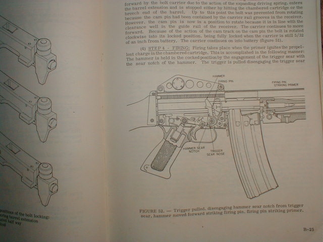

    There was even a slight interest by US Ordnance concerning the Stoner rifle, even manuals were printed with instructions for training and close order drill.
