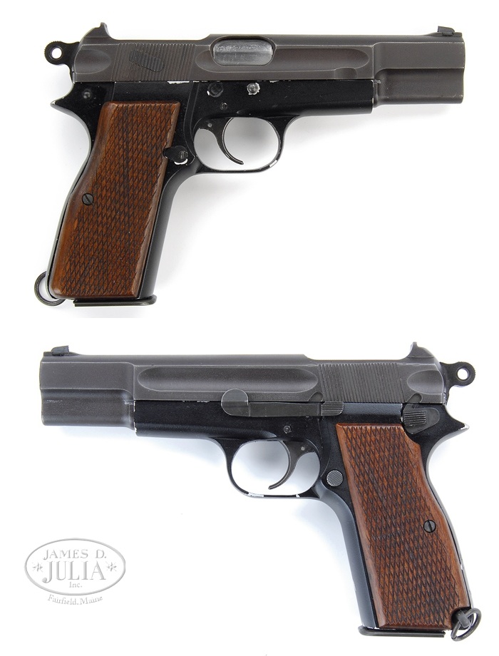

    I wonder if the Collector's book "Diamond in the Rough" would have info... I know there were only a half dozen actually made up but I seriously doubt this frame is one. With no ownership marks on it, hard to say where it came from.
    "In 1947 engineers at John Inglis and Company began work on developing a lightweight Browning Hi-Power. The first pistol had a lightened slide and a steel frame. However, by 1948 Inglis were experimenting with aluminum alloy frames.
    Inglis assembled six prototype pistols, chambered in 9x19mm, with steel slides scalloped with lightening cuts on the top and sides and alloy frames. Mechanically the experimental pistols were identical to the standard Hi-Power using a short-recoil action and feeding from a 13-round double stack magazine. Unloaded the experimental pistols weighed 25.5 ounces, a reduction of 8.5 ounces or 25% of the standard Hi-Power’s weight. Externally the alloy frame had a black enamel finish while the slide was parkerised. Two of the pistols remained in Canadaicon for testing, Britainicon received two and two were sent to the US for testing and evaluation. Canadian testing of what was officially designated the ‘Pistol, Browning FN 9mm, HP No. 2 MK.1/1 Canadian Lightweight Pattern’ took place in June – July 1948. Their report concluded that “the performance of the Lightweight Pistols during the trial was of the same order as that of the Standard and is acceptable for service use.“ In December 1948, Testing Section staff at the Royal Small Arms Factory, Enfield evaluated the performance of the Inglis prototypes sent to Britain in what became known as ‘The Lightened Browning Trials. The lightweight Hi Power unfortunately never went anywhere"
    I know that one of the pistols ended up here in the sedentary collection of the deceased William Fowler, Maj, P.P.C.L.I. It's present location after his passing a couple years ago is unknown.
    Picture from the sale site, text too...

    Many lunch box Inglis No.2 pistols exist but not with LW frames. Interesting pistol. I'd find a decent set of original Inglis grips for it, grease it up and squirrel it away.
    Apr 2008
    Today @ 11:30 AM
    Edgefield, SC USA
    4,117
    05-09-2025
    11:34 AM
    Correction. Those are original LW grips!
