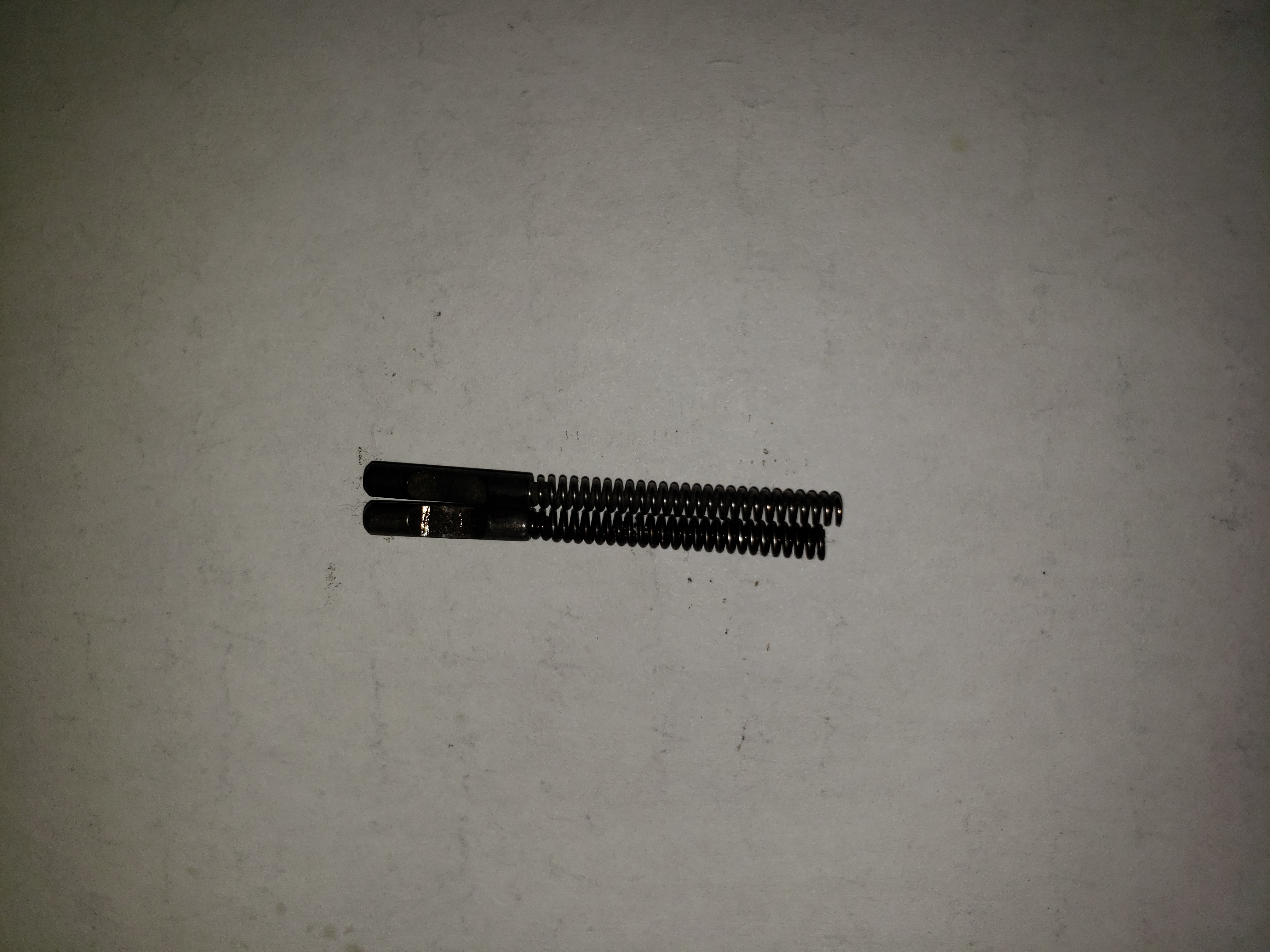

    ...new ejector pin and spring came in the mail yesterday. this one is the 45deg. bevel. I have another on its way that is the early 3-bevel type. I'm betting that some combination of new spring and/or different ejector will work sufficiently. I did not replace any of the springs when I got it, so the slide return spring is another cheap variable I can play with.

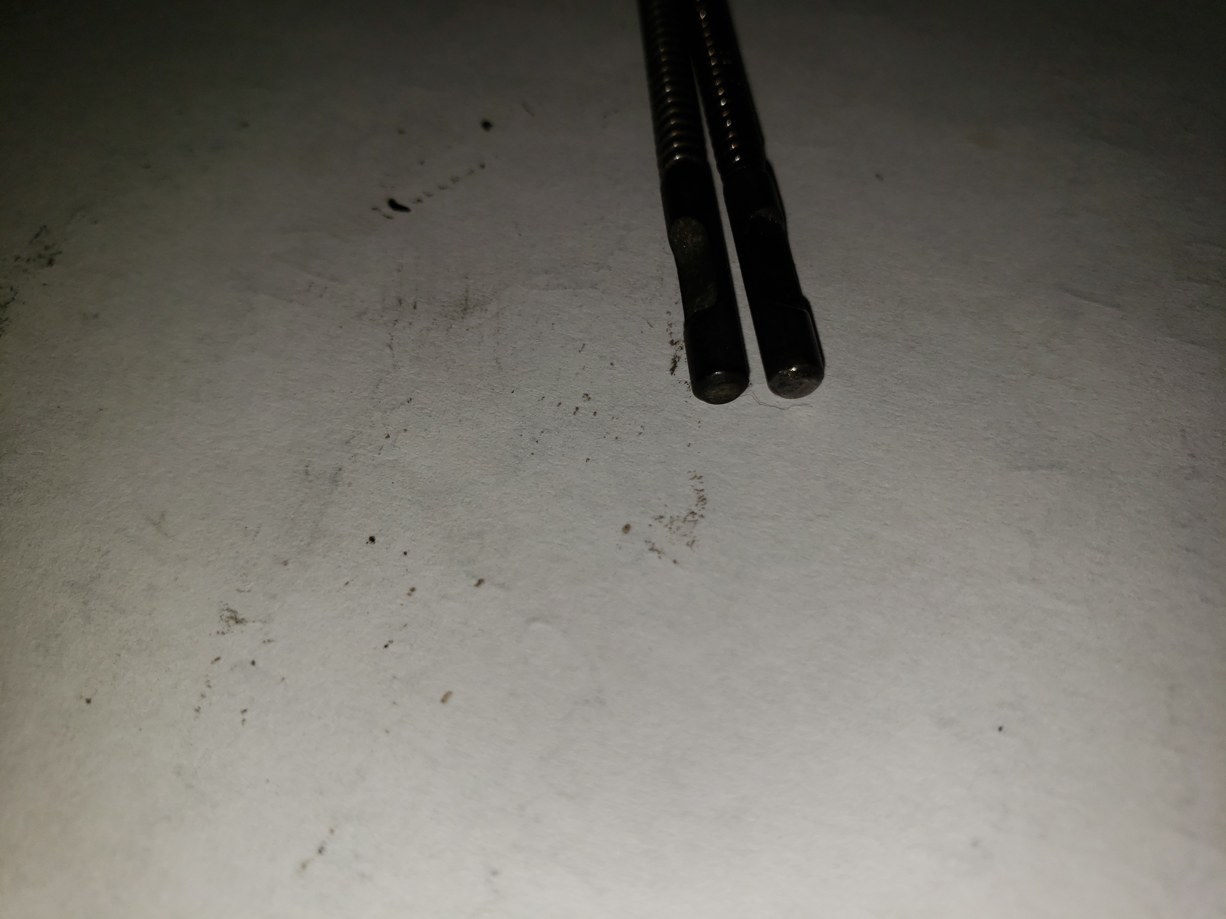

    NOS ejector and spring came in. After more careful examination both ejectors are the 3rd type in the photo of post #42 - with a 45deg. bevel. However, as you can see, the new ejector spring is a bit longer, about 2 coils. The new one is installed, and both kids are now jonesin' for some carbine time this week.

    I've always looked at the ejector as part of a system. I've had cases hitting me in the forehead and some flying right. I don't think that the type of ejector will make a major change in the results without other things. An extractor will effect the ejection, and I think that the main recoil spring has a lot to do with it too. I had one that was having all kinds of feeding extraction and ejection problems all of which went away with a new GI operating spring. I've changed ejectors to all three types that did absolutely nothing. Some just work. Making sure that the holes in the bolt are completely clean and that both bolt springs are in good shape helps. a lot as does making sure the weapon is lubricated. The oiling by manual standards is not sufficient in my opinion. That main slide spring does a lot more than just slam the bolt closed and as I noted, sometimes it cures all of the issues.

    Quite right, the correct ejector may make all the difference, but in firearm with so many different components it is wise to change one thing at a time until you find the solution.

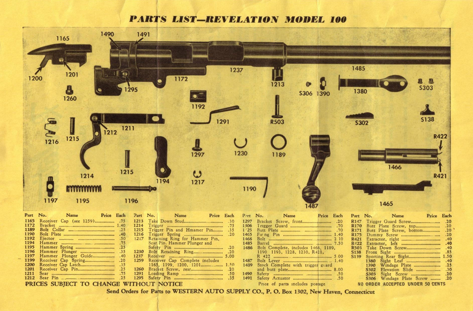

    Charlie, I guess we're both doing some "hi-jacking" of the OP's thread here, but the 22 is a (Western Auto) Revelation Model 100. The "Blue Book" says that's a Mossberg 321, but some on the "net" say it's closer to a 320. My oldest brother bought it for me 2 or 3 years after he joined the Army - think it was about 1961. He removed the part that engaged the safety every time you cocked the gun before he gave it to me, since he knew I didn't need it - all of us had been shooting Dad's single shot 22 (his Missouri squirrel gun) for several years by that time. Dad's single shot was also a "store brand" gun. I think it said, "White's Hardware Company - Kansas City Mo." on the barrel. I still have the original papers for the Revelation 100, so will add images below. Only complaint I ever had on it is the "stamped" bolt handle - looks cheap, but works just fine!
