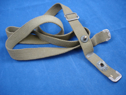

    GI Bob,
    Just noticed in the picture WAC always uses of their Original C tip sling, it appears to have different type C tips on it.
    Does the lengths of the legs of the C look different to you?
    Picture is from their site.
    Now I'll admit I'm a couple doubles of Jim Beam in to my day, but the Tips appear off.
    What do you see ?

    Yep, looks different. I forgot to mention earlier, but thought the shape of the followers on those Taiwanese 10 rd mags seem to have an odd shape to them. See what I mean? - Bob

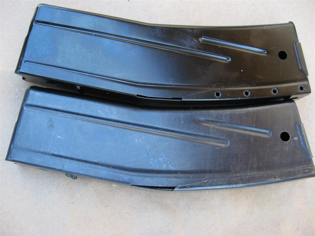

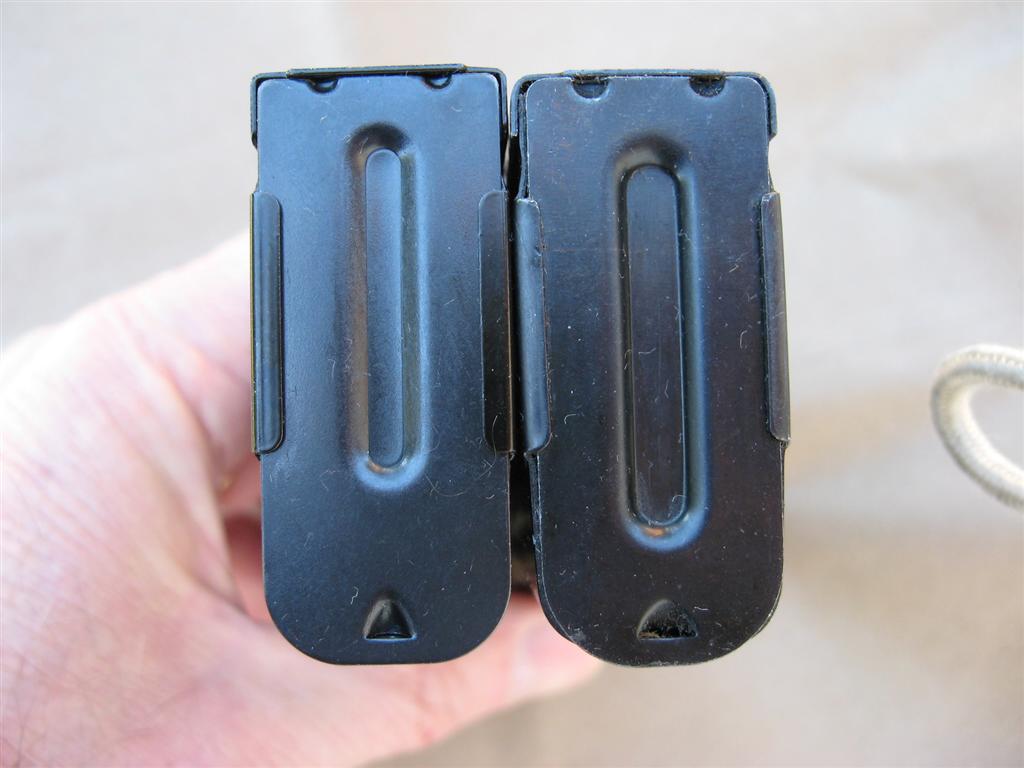

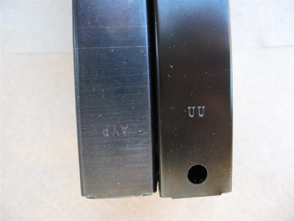

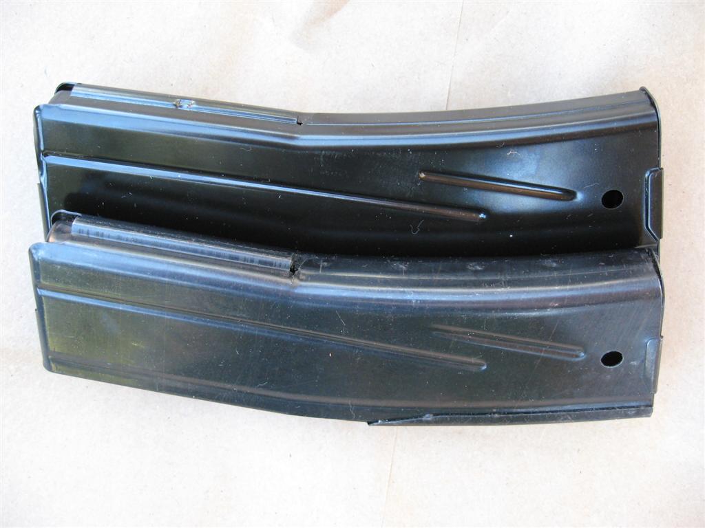

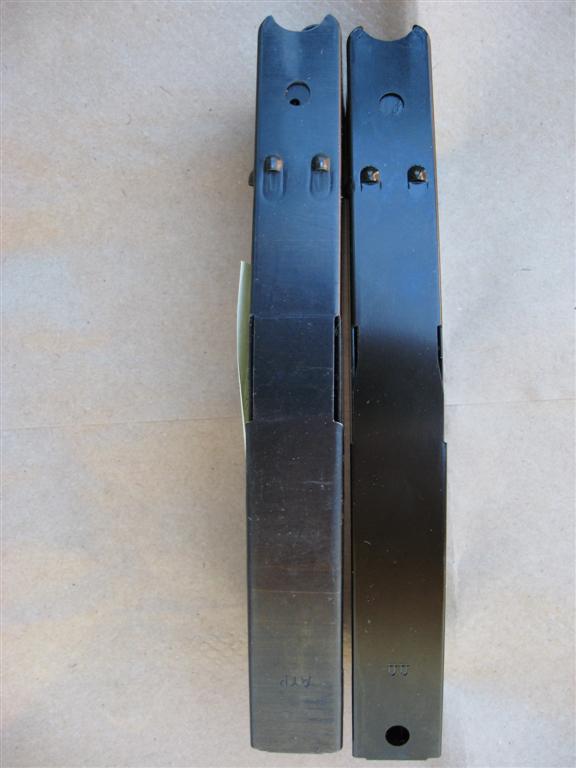

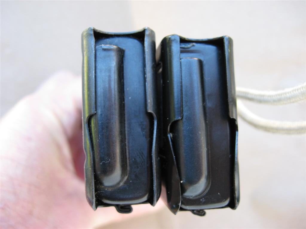

    Here's the quote from Bill Ricca on the "holes" I was trying to remember when I made the last post here. I think it's still available here on the forum - believe this is where it came from. Also, below Mr. Ricca's quote I'll post some pics comparing my NOS AYP mag with a Korean UU I bought a few years ago at a local show for $12 - Kinda wish I would've bought more of them at that price! The AYP will be on the left or on the bottom in all of the pictures. Jond, you might recognize these pictures. They were taken about 3 years ago when we were discussing some SEY's you had a question about. - Bob
    "If you look at the rear of the welded magazines you will see a hole near the top. If you look through that hole while you move the follower up and down you will see a hole in the rear of the follower. No USGI magazine ever had that hole.
    Many of today's repro have it.
    Another note: I cannot see your magazine in person so I cannot comment on its quality, but as Jimb said it is not US GI. The SGN dealers and gunshows are loaded with them, each has a different story as why they are US.
    Another note: ALL US GI ordnance stampings require deburring. It is on every drawing I have ever examined. The current joke are the 03 Springfield "Remington" marked sight covers. They are configured like some of early SA sight covers from WWI, but have the WWII marks and are crude, no deburring. I think they originated in China (not Taiwan).
    Keep in mind the next time around these fake AYP's and J's will be improved a little more. Eventually they will copy them exactly and by the year 2025, 58 years after the last known production of 30 round magazines, there will be plenty of "US GI" 30 rounders on the market."
