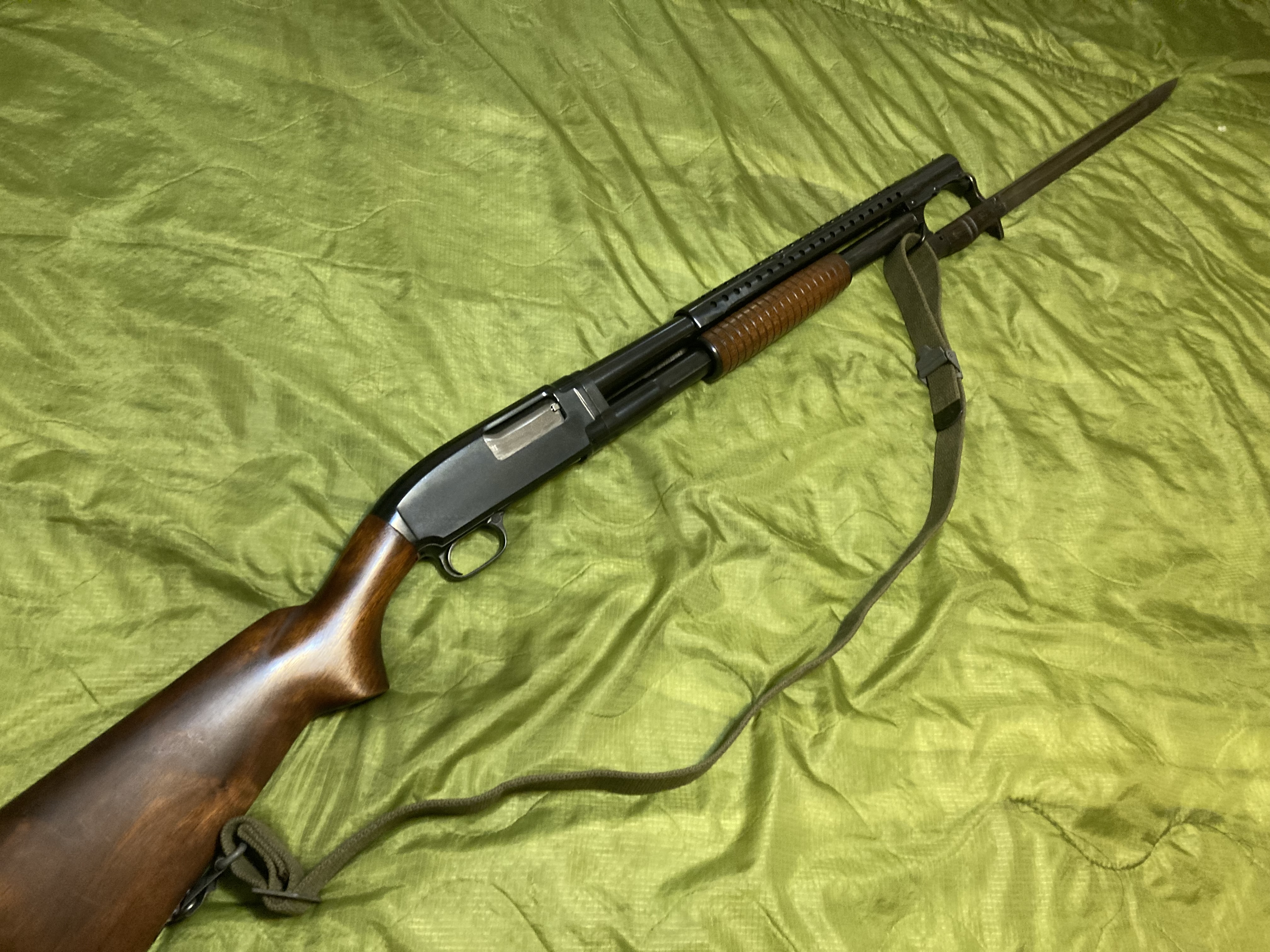

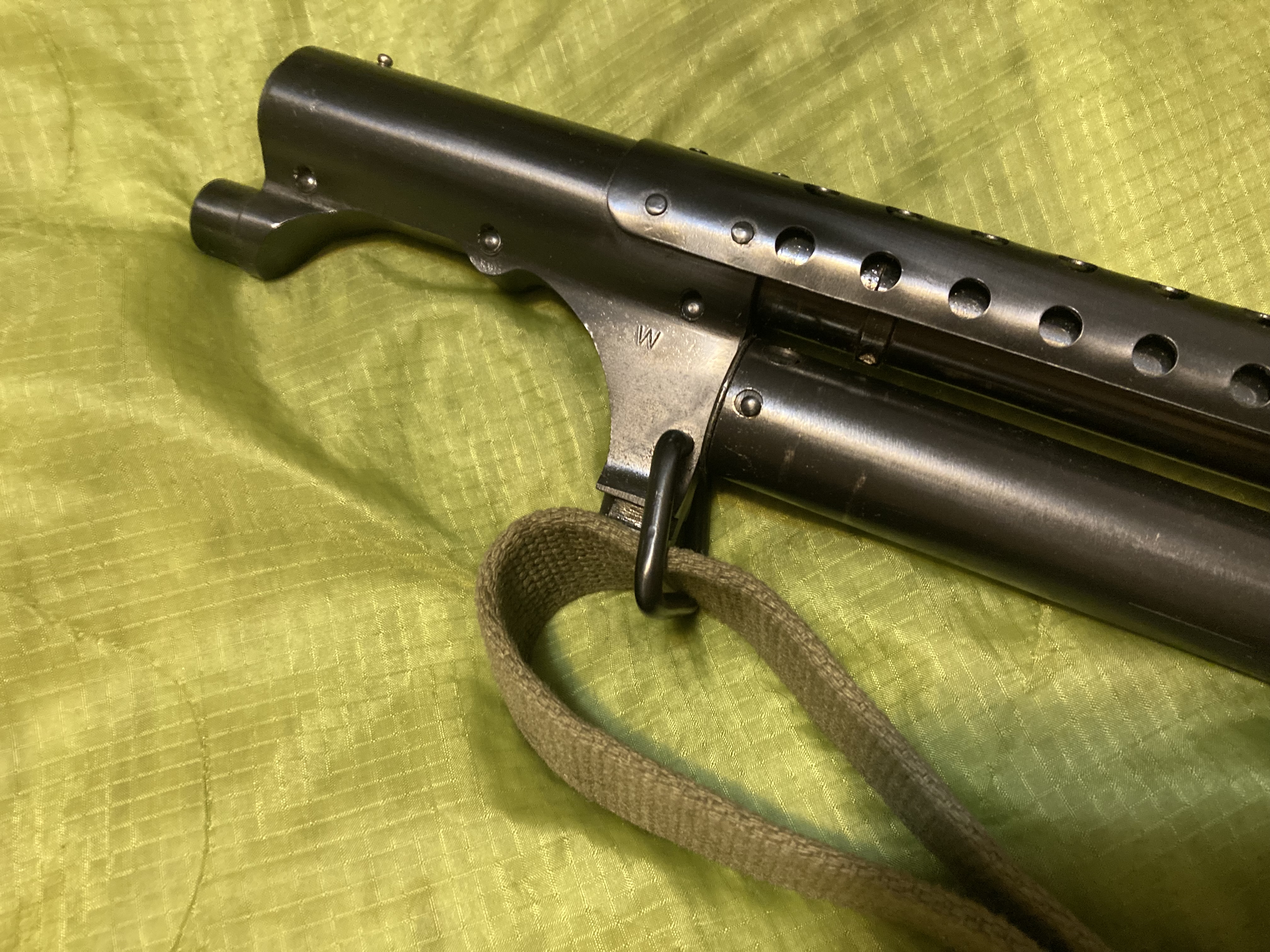

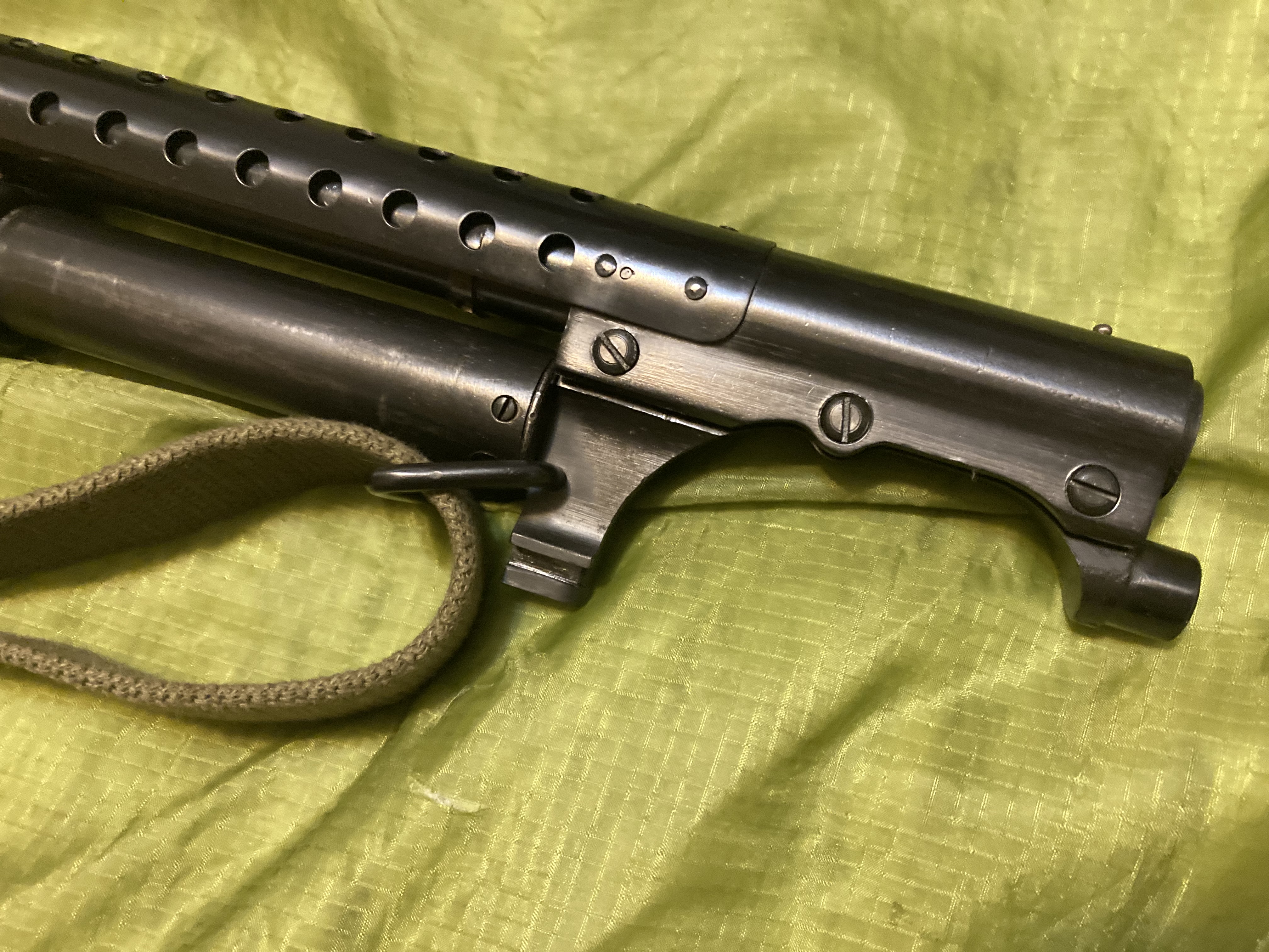

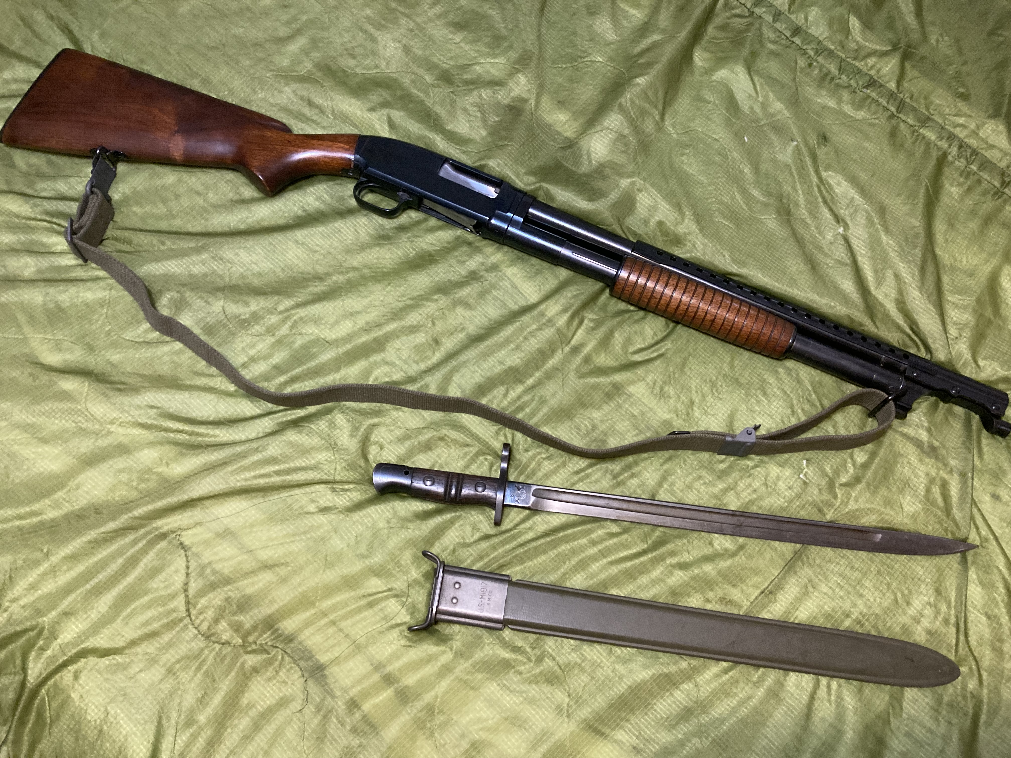

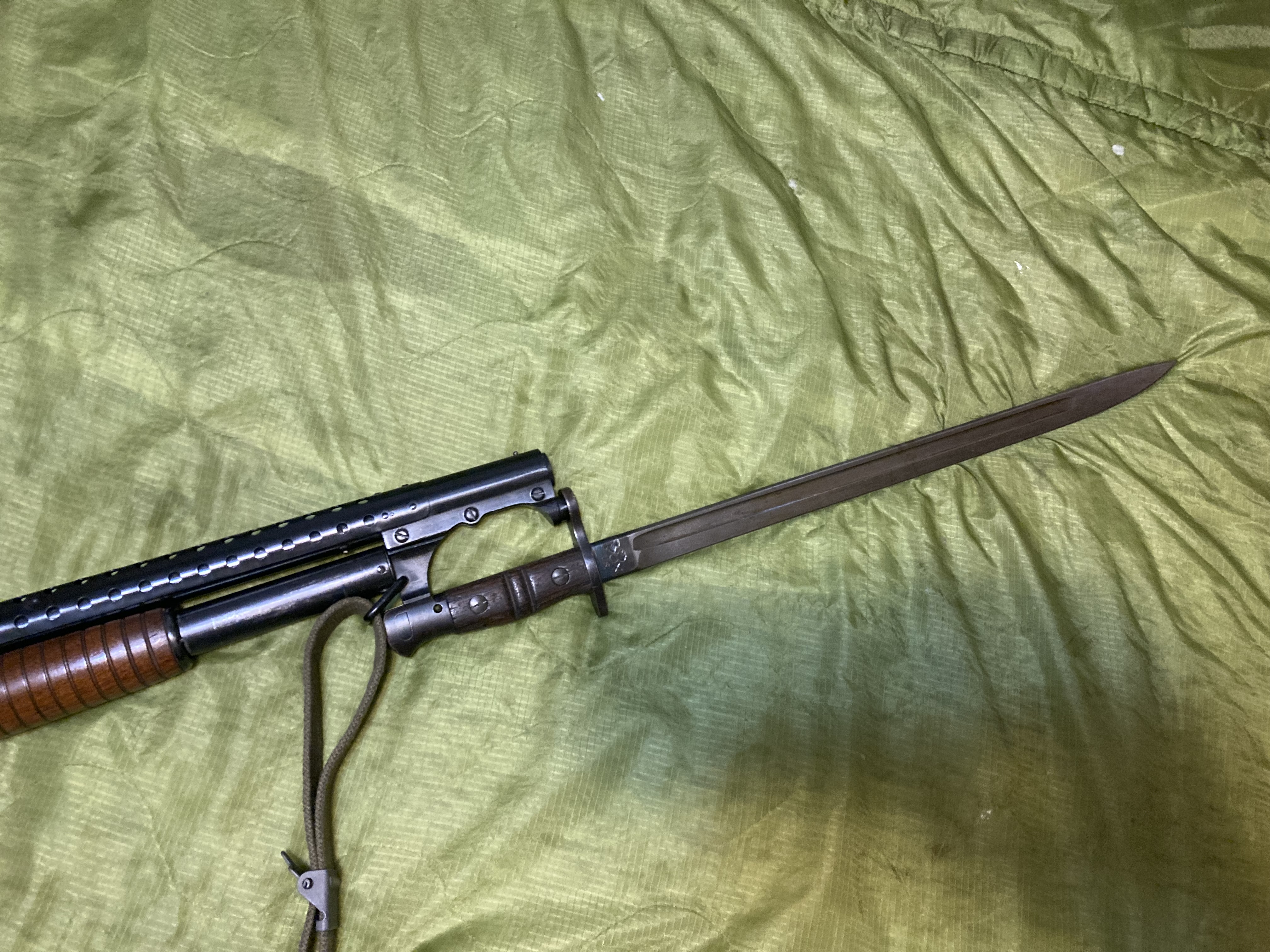

    Competed Conversion
    The barrel and adapter arrived this morning and is now finally attached to the receiver. I'm pretty happy with it considering all the effort and period of time involved.
    Not real sure about the rerpro sling - I think it's ok late for post WWII (?)....I had a 1907 sling but sold it before the conversion.
    Comments or questions are welcome.
    It's feels good to be a kid...
    Dick

    It looks good...the sling, I had a flat slider sling that I think was a Danishicon made that I used on my 870 Remington. It looked better I thought than a later M1icon type. I wouldn't use the 1907 sling myself, they're so heavy.

    Thanks Jim, I sorta wish I still had that 1907 sling just for comparison, but that's about all. The web sling is good enough and still looks period correct I believe. I'm just as proud of everything after all the time and effort anyway. The only bit I regret is the misaligned hole I drilled that I may try filling in with a modified rivet and very carefully trying to smooth off flush without messing up the bluing...just a thught.
