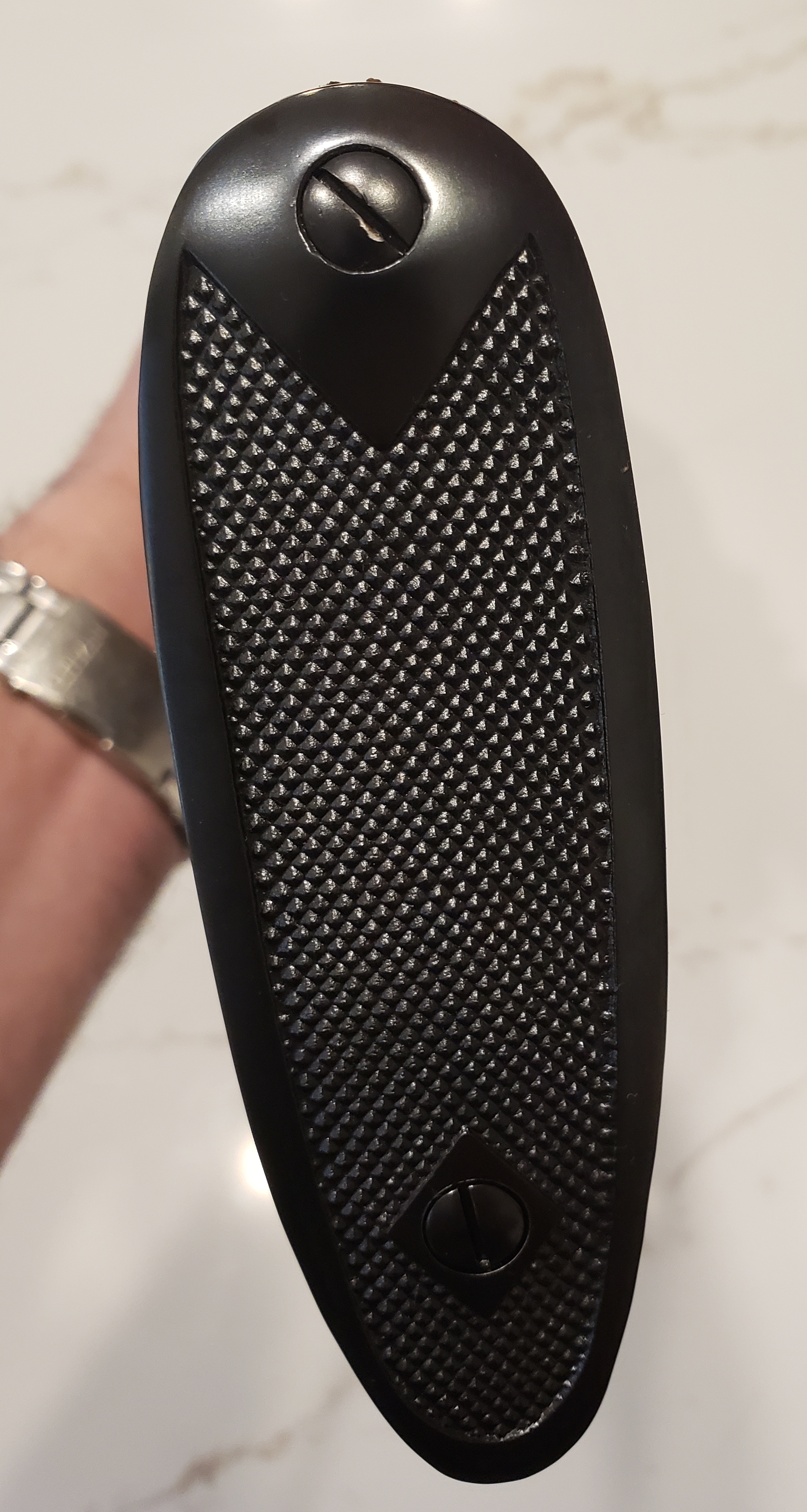

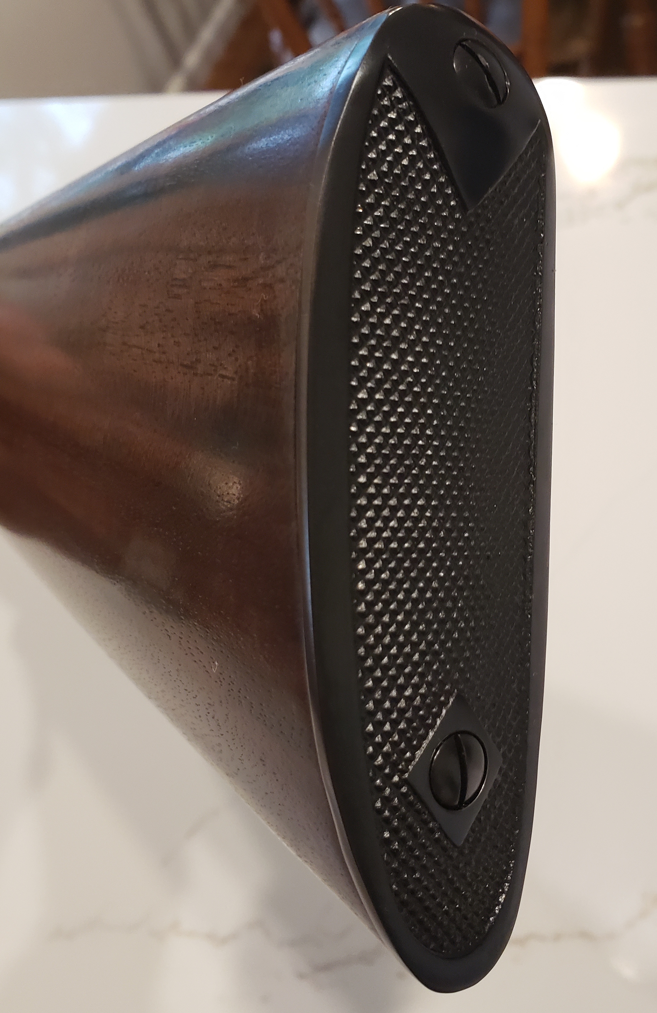

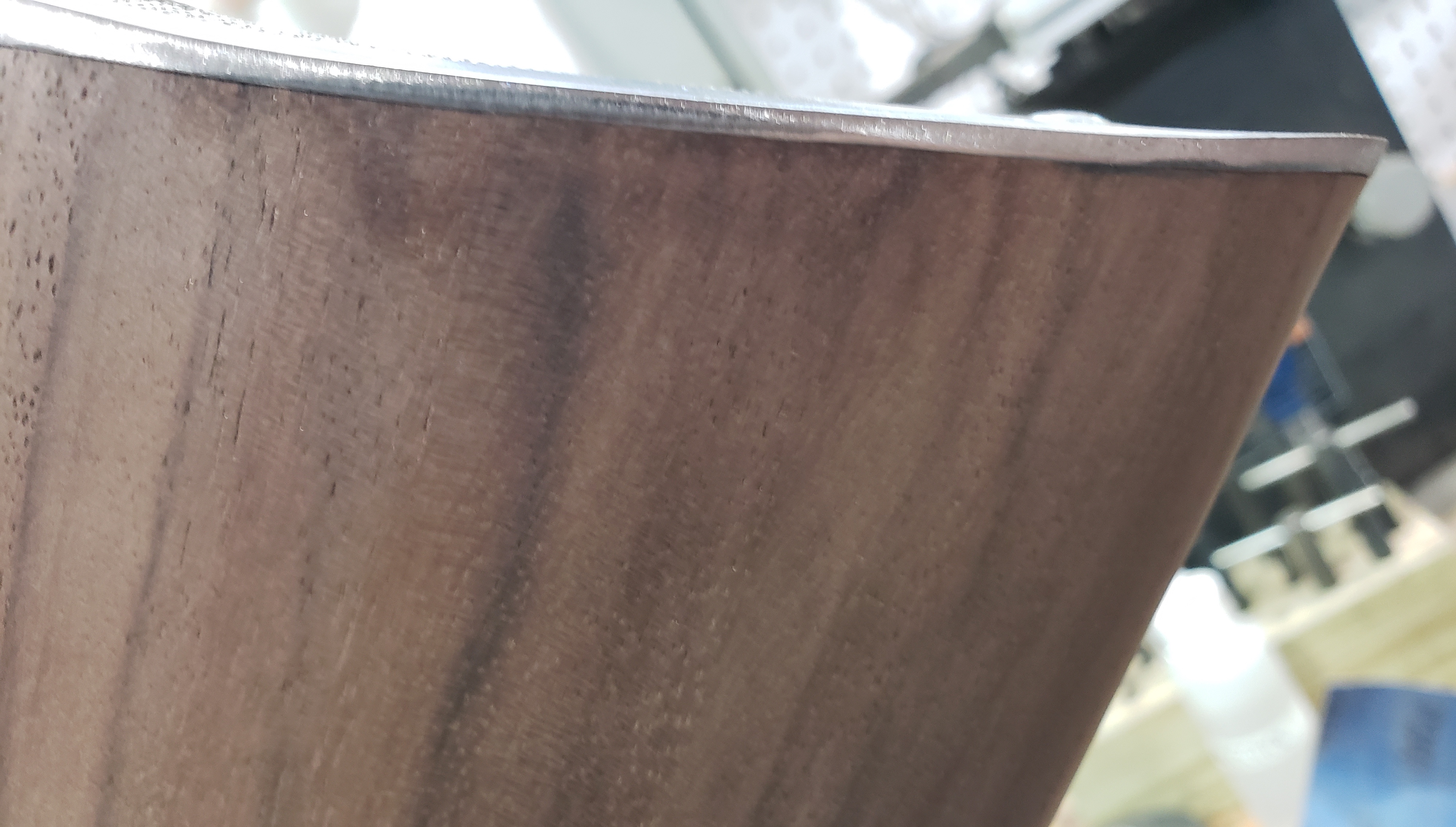

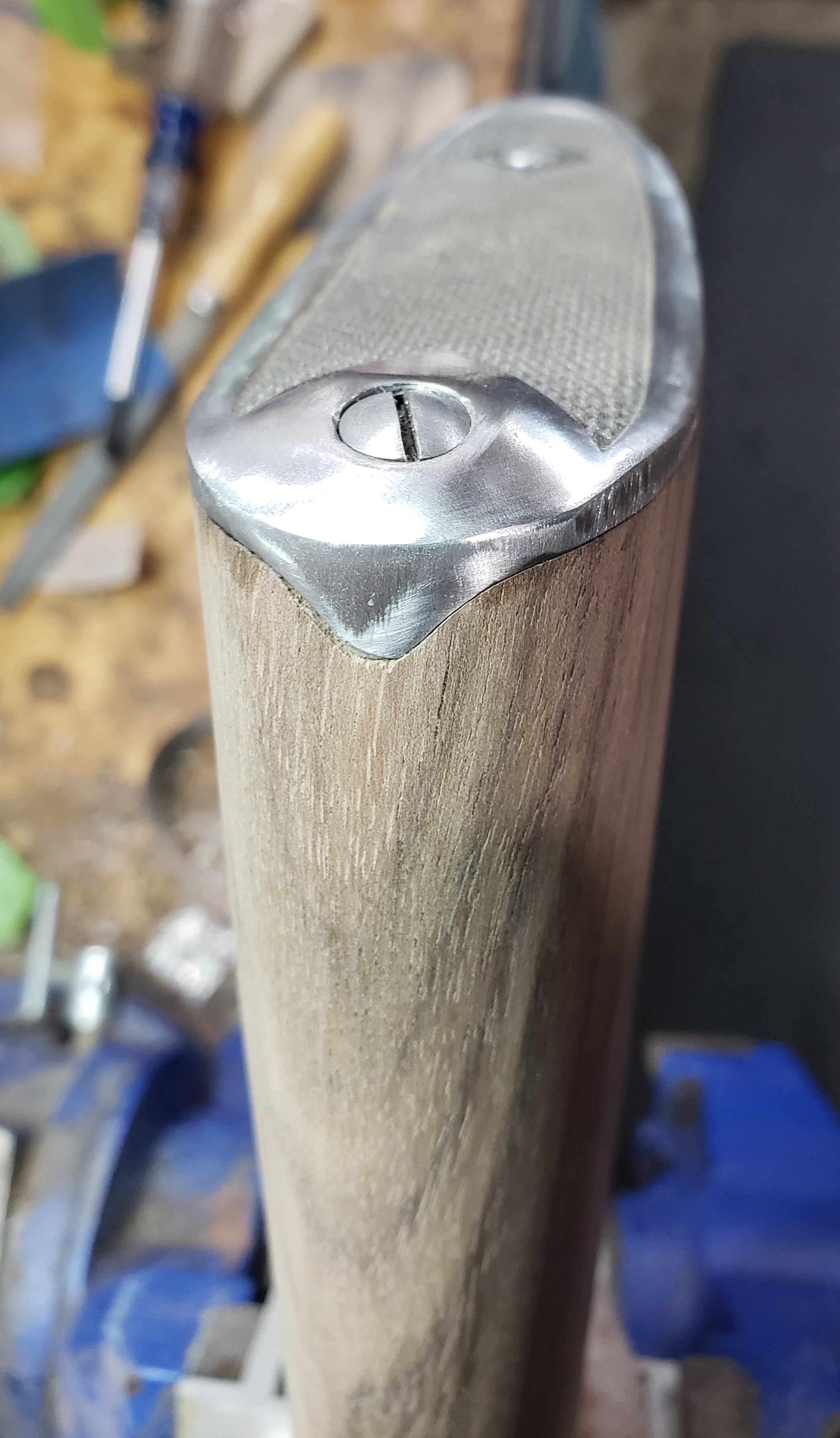

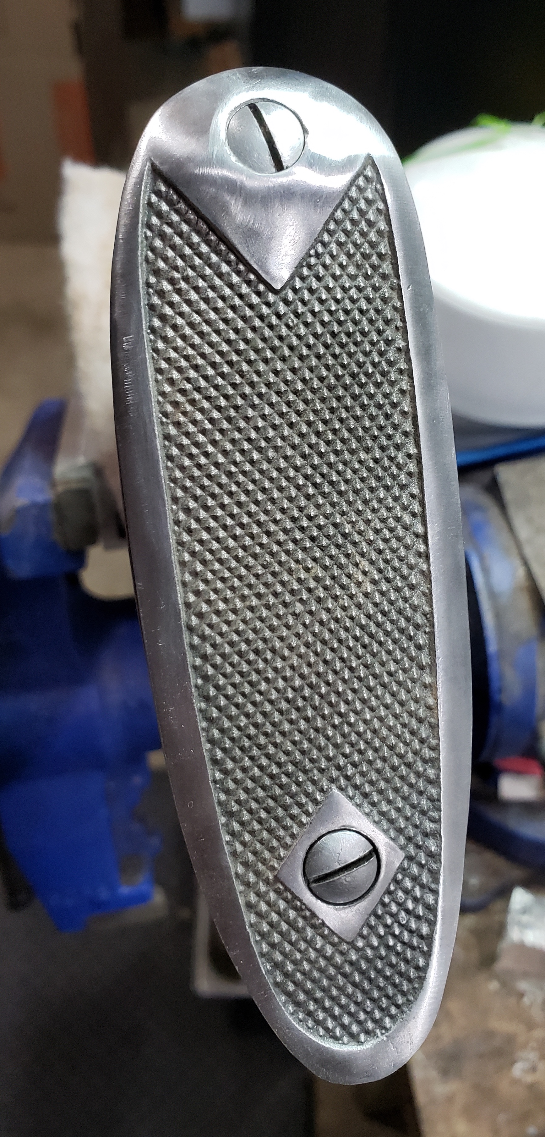

    Finally got started on the Boyd's stock after my easter week recess and work trips. Spent an evening inletting the curved metal buttplate. With the widow's peak, screw holes, and toe all perfectly aligned and centered, one side sat mostly flush, the other proud by 20 thous. or so towards the top, then below the woodline at the bottom. The toe overhung the stock by 1/4" but there was plenty of excess border down there to make it work and look even around the checkering. I had to drill out and plug and redrill the holes in the stock. The holes in the buttplate were rough cast, so I had to open up the countersink a bit and clean up the screws to sit in just perfect. Might as well get rid of all the casting pocks too. That was all an evening, and grinding all the excess off the buttplate was another evening. Pat myself on the back and yell at the kids to bring me a beer!

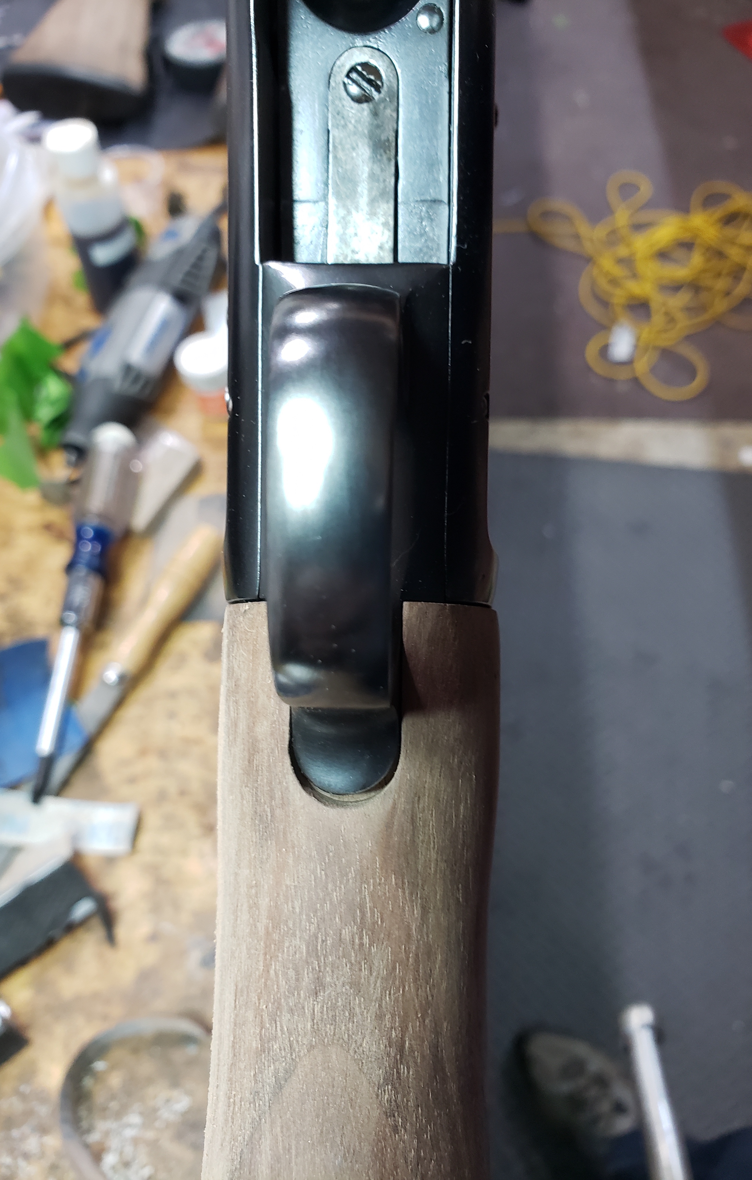

    The fit up is ok. I was happy that there is a very even but barely noticeable gap around the edges of the wrist. Not much to do right! Wrong. There is 40 thous. of room behind the trigger guard. Way too much.
    Easy peasy. Use a depth micrometer to tape around the wrist nice and even and a safe edge file to set the shoulder back. Then work down the tenon until I close the gap. Should have that done another evening or too.
    Over Easter weekend I had a chance to handle a 16 gauge 1897, serial late 600k's. Took some measurements of its butt and it's about the same from comb to toe as these Boyd's "replacement" stock. They must be too lazy to make another program for their CNC. The wood is unevenly proud of the metal around the wrist too, so I'll have to deal with that also.

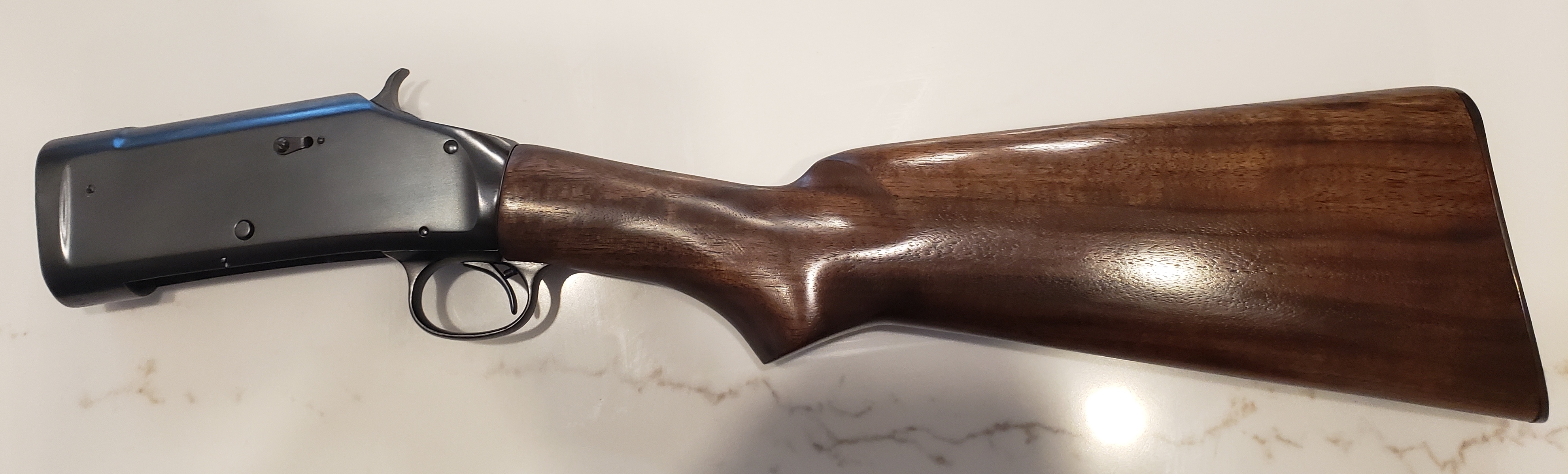

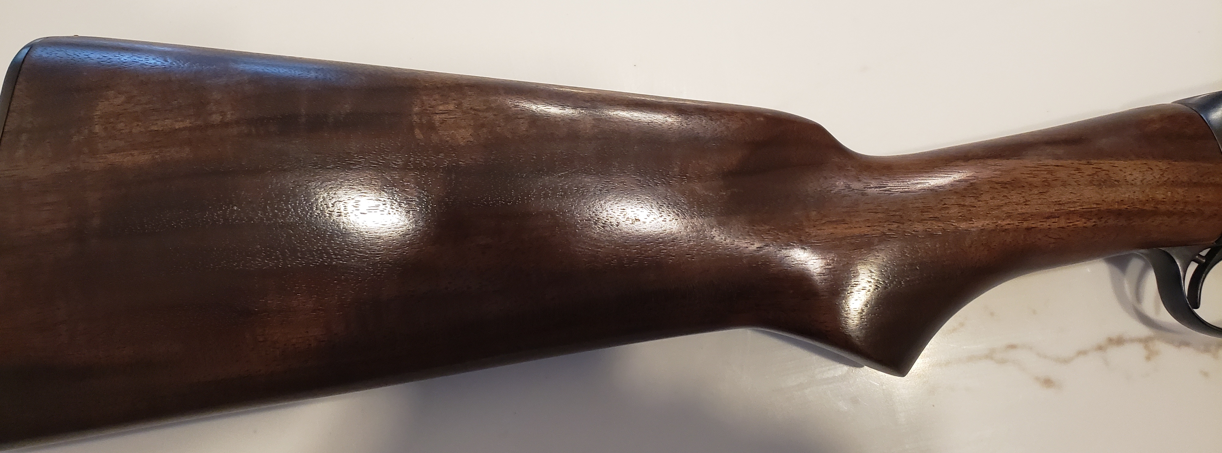

    Here it is. The finish is much more satin than the camera shows it. The walnut was lighter than I would have like, but I think I was able to darken it just enough to bring out the American in it - or at least it matches the original forend handle. It will get heavily used come turkey time, so I went ahead and waxed it.
    The buttplate turned out ok. It's curved on the underside from left-right. I didn't work it down that far when I fit it, so I may bed the underside center with epoxy to spread the recoil forces towards the center.

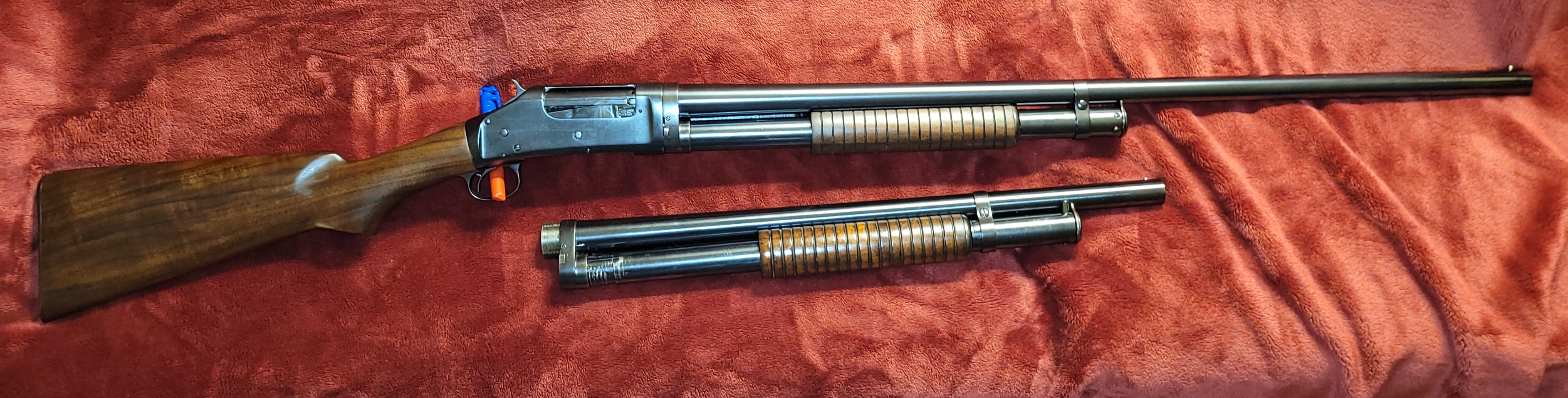

    The barrels and mag tubes for this project have been polished and hanging in the shop for ... well since my last post. So I spent the weekend rust bluing, cleaning screw heads, and fitting parts to build the forends. I'm very satisfied, at least with appearances.

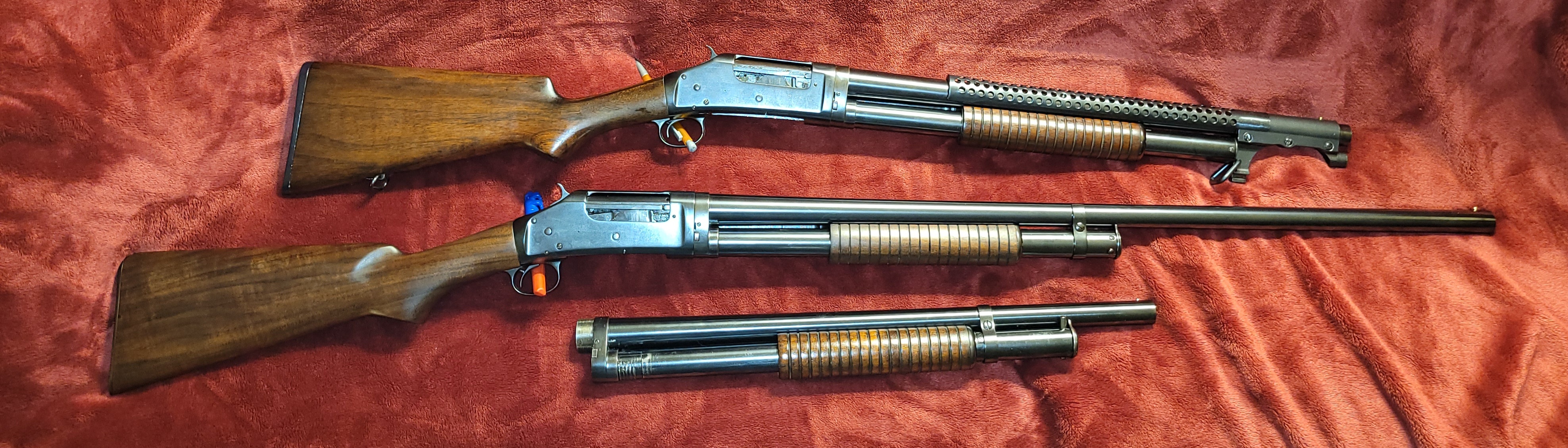

    Here they are next to the trench gun project (Finished the latter a while ago. there is a thread on it here https://www.milsurps.com/showthread.php?t=76435
    The riot gun forfend is a 20" norinco replacement barrel. New when I got it sans some shelf wear. Its heavy. The extension I found was a bit beat up, as was the mag tube. Took quite a bit of work to get them fitted to work - I did it first. The 30" barrel and mag tube and original matching serial extension fit up with little to no effort - owing mainly to the fact that it was me who removed the original extension. The other bubba slightly malformed when he took it off.
    Sadly, I'm not done yet. On the riot gun when I was function testing, about one in every 4 cycles would slam fire. Holding the trigger forward the problem went away, so I adjusted the trigger set screw a quarter turn and the problem went away. Then when function testing the 30" forend, every cycle was slam firing. wtf. Cycling real slow I get the trigger lock back, then as soon as I push the handle forward all the way to lock up, the hammer releases. Holding my thumb on the hammer I can feel it catch the sear - but only sometimes. Most of the time, even holding the trigger all the way forward, it won't catch. My first thought was the slide wasn't making its full range of movement. So I switched to the 20" frorend. Wouldn't ya know, despite all my success with it not 24 hours earlier, it has the same problem now. I can get the hammer to lock back maybe 1 in 10+ times, but only if I go real slow - either forend. If I hold the trigger forward, I can sometimes get it to grab the safety notch, but not always.
    I'm convinced I have a worn or broken sear edge or hammer notch(es). Not surprising. There was plenty of evidence bubba messed with it before I got it. The slide-lock release plunger was missing, and replaced with a short pin that looked made from a nail - the effect was the action could be opened when in battery without depressing the release plunger. I read somewhere on the internet that many cowboy-action shooters prefer this mod. Wouldn't doubt it if bubba did a trigger job too - or got too happy slam firing, which I've read can wear the edge of the sear. Nothing to do though yet, until I clear the bench and tear it down again to have a look. Until then, it's just eye candy.
