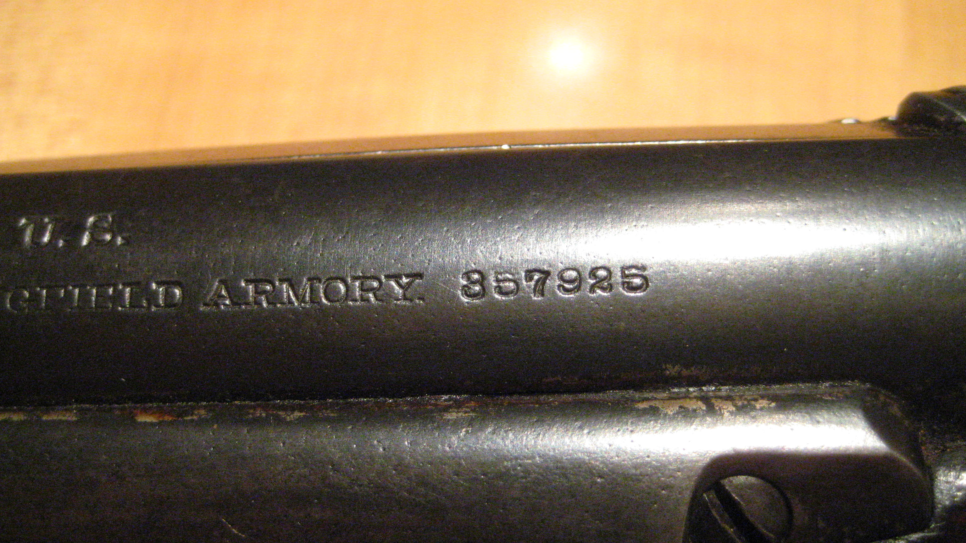

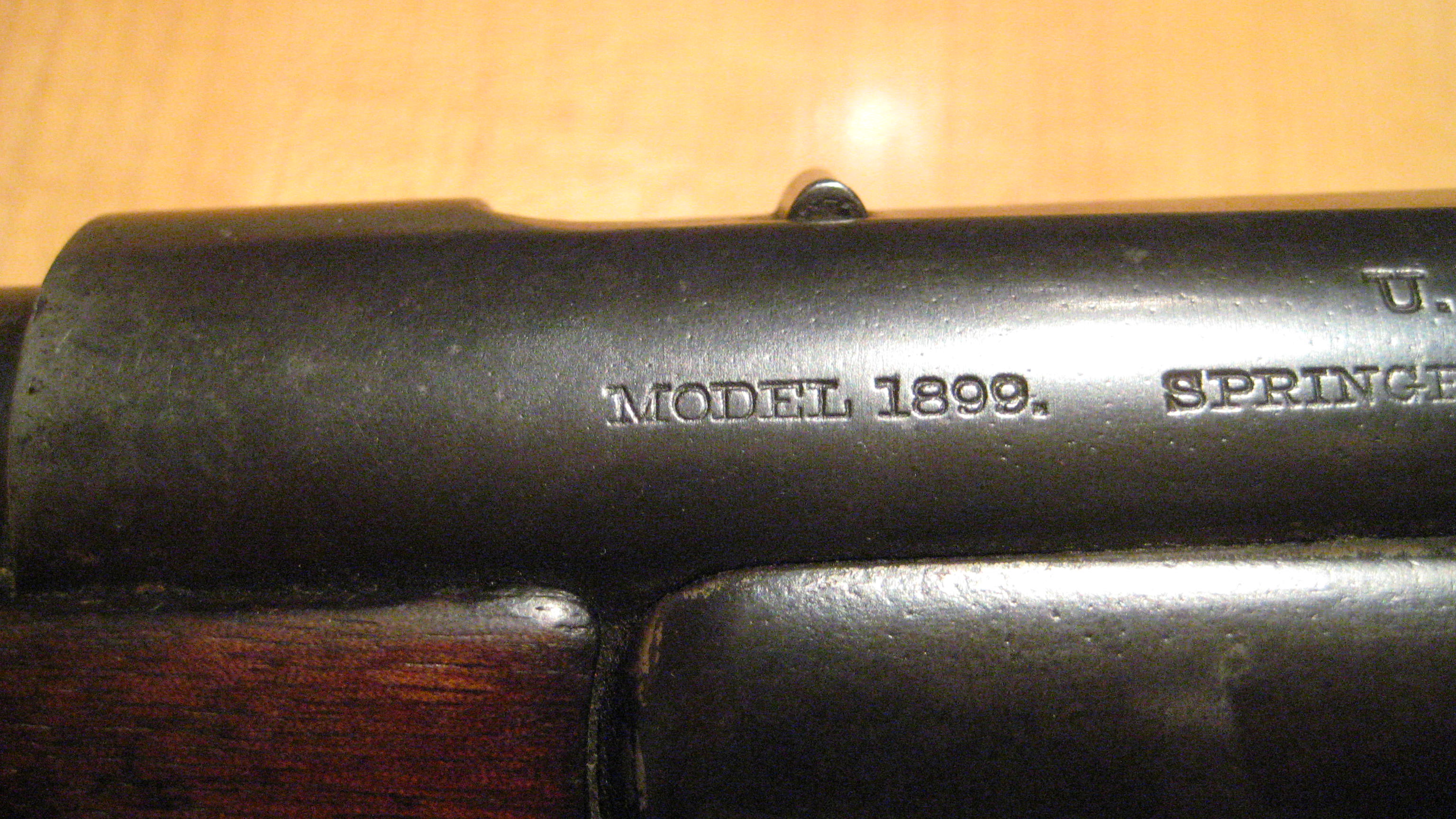

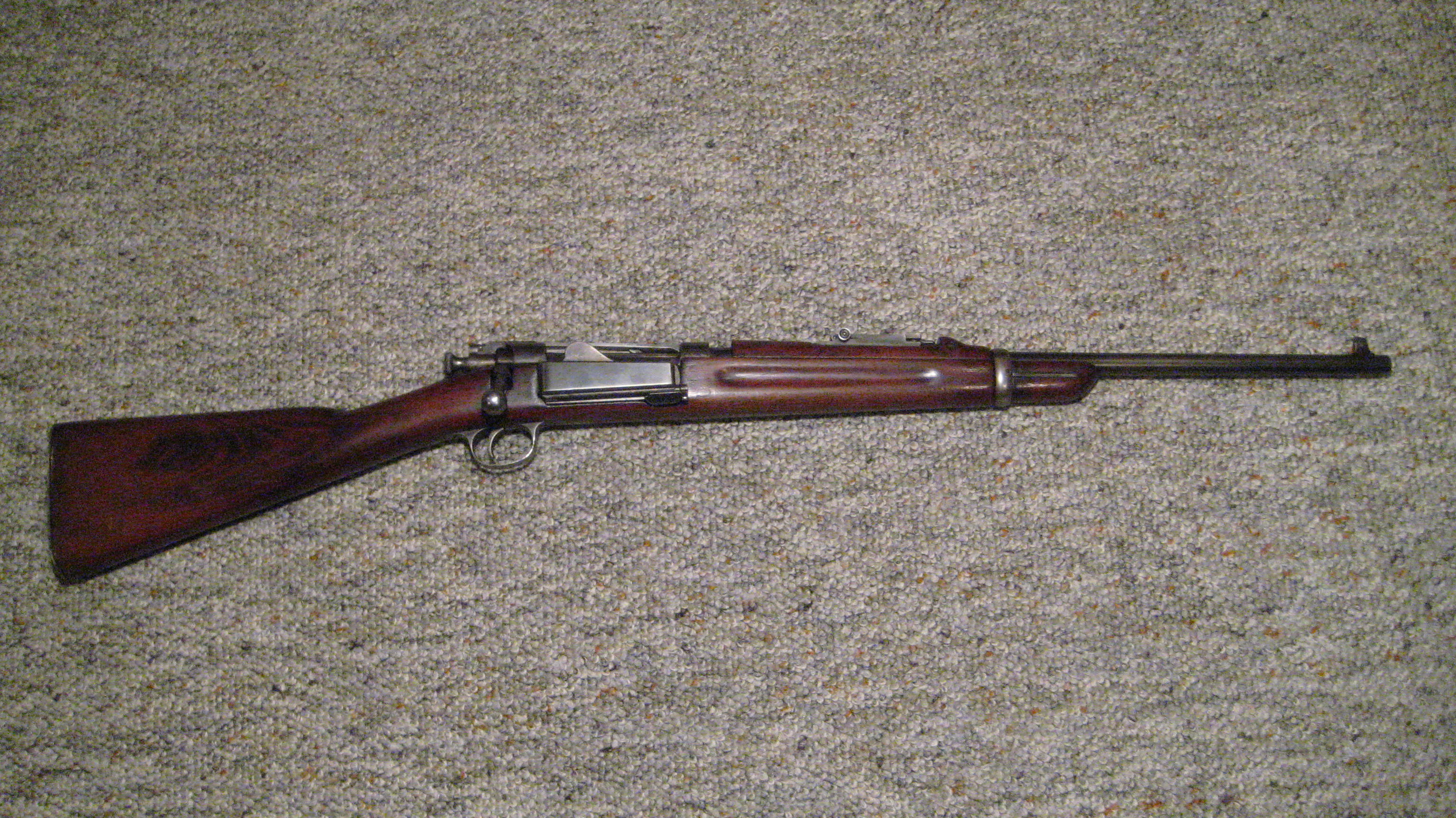

    SRS #1 has no numbers even close to it. Nice early cocking piece. Looks like a rifle cut down and a carbine stock. Here's mine...
ID:	131988   Click image for larger version
ID:	131989   Click image for larger version

    Mine looks like it may have been a VFW post piece at one time and used for funerals and blank ammo...the bore would eat a jacket bullet and not even burp. The rest was enough for me to at least claim to have a carbine. I'll bet your bore is good or better? That's usually why these things were converted, carry and shoot easy when they were a common milsurp...
