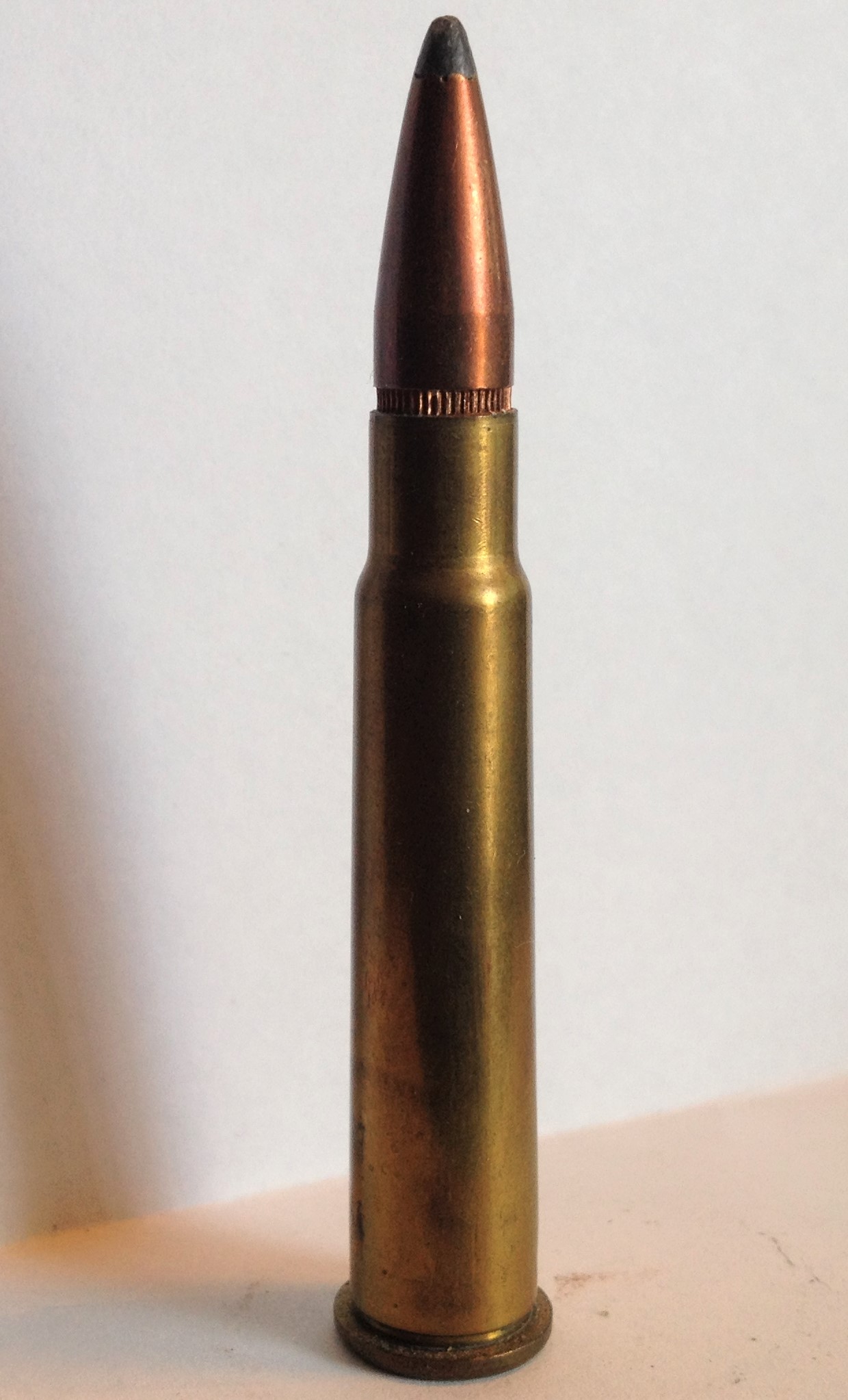

    My reloads of smk's work well in all 4 of my 303 shooters so I am pretty happy with them, here they are almost impossible to acquire now.
    I've also developed loads and won comp's with the Hornady 150Gn SPFB .312" they fly pretty good up to @400m which is the furthest I've shot them.
    Here is a pic of the 150 grainer how I seat them to just the bottom of the cannular and medium crimp them they fit in the mag ok and cycle well at least in my rifles, though I have polished up their feed ramps!
